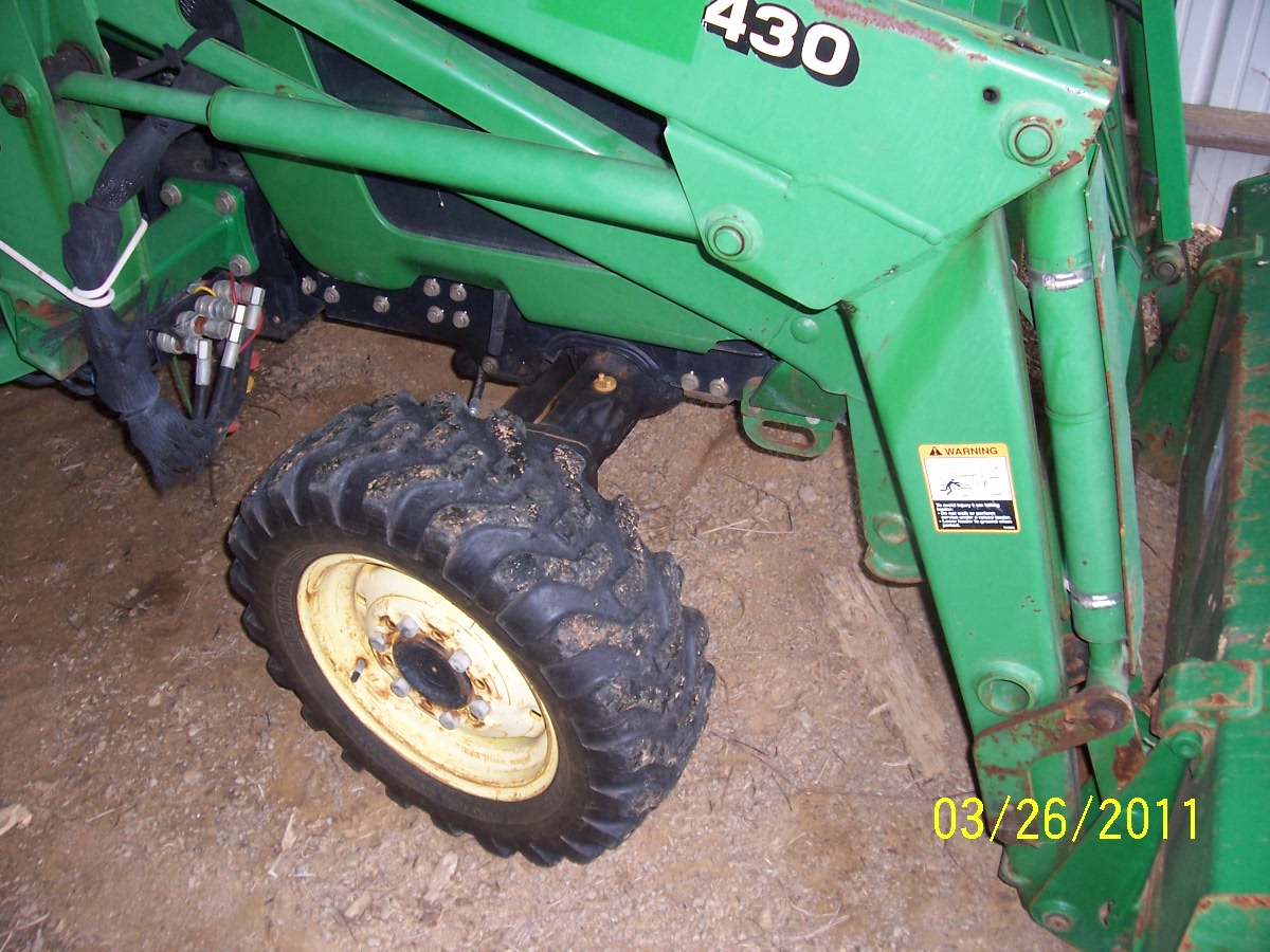

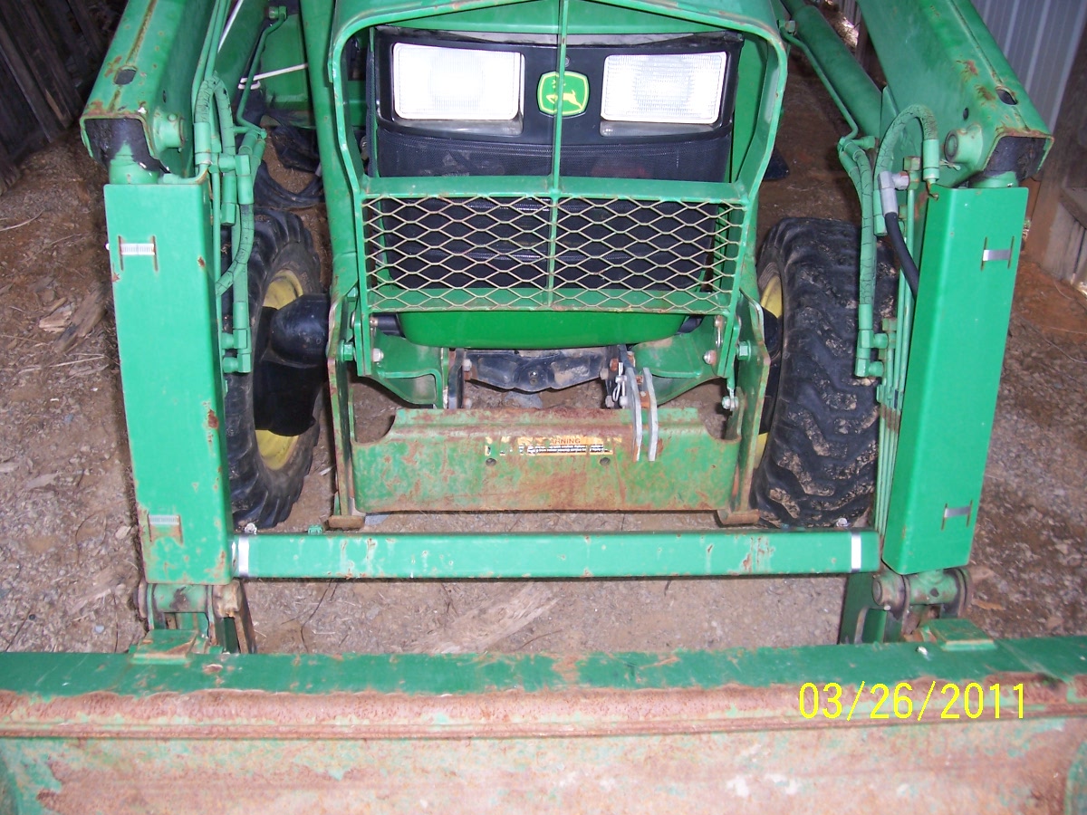

Thanks for the information. I took a better look at the tire/wheels last night and it does look like they can be reversed and get a wider track. I'll be ordering a service manual ASAP and it will be the factory manual. I'll be changing some of the fluids this weekend. In the hydro down here in North Carolina where the tempetures range from about 20 to 100 degree's which fluid should I be using? The manual (thanks for the link Roy) says low-vis is preferred but then gives you a chart to not use it over 80 degrees says Hy-gard can be used.
Checked the fuses last night, all good, I'll wait for the service manual to fix the lights.

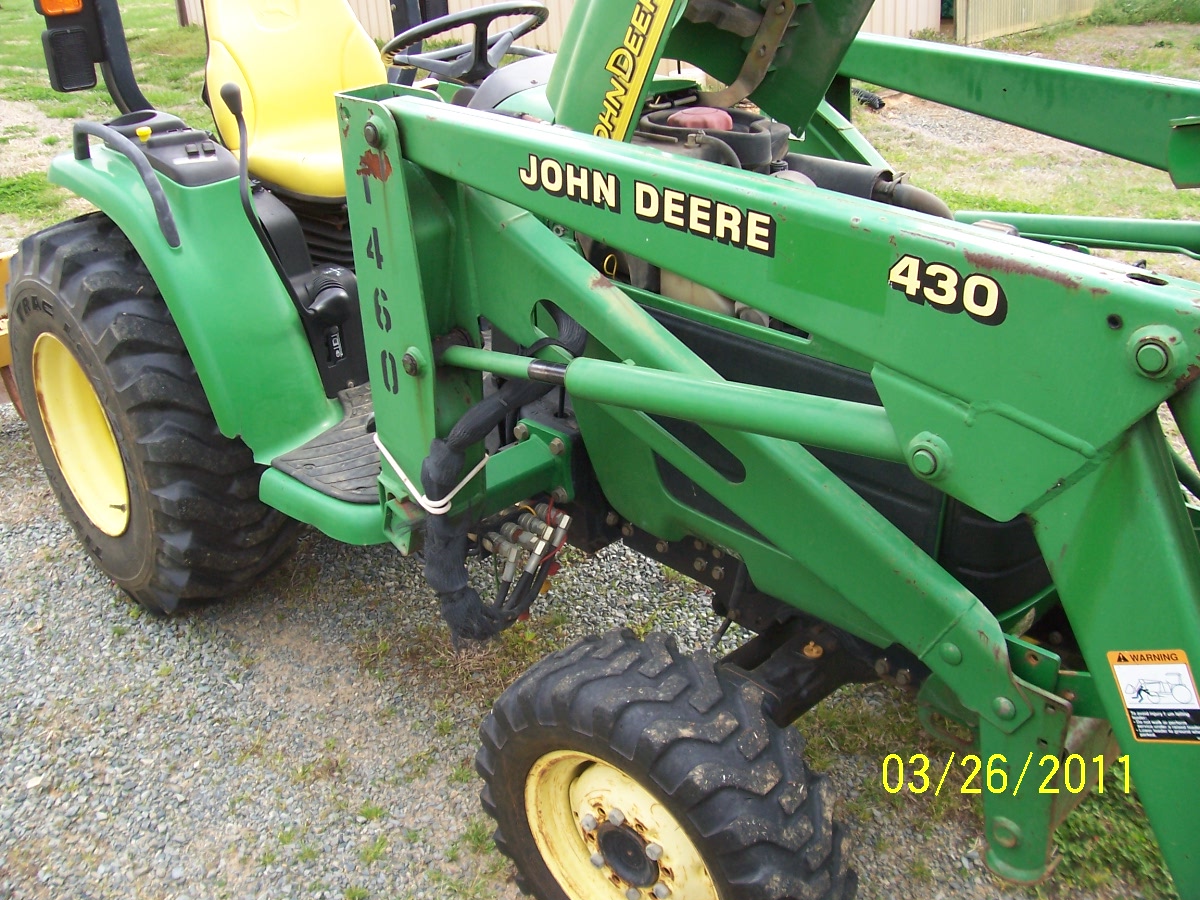

I think the rears are already in the wide position if they have one but since you mentioned it Roy I was looking at the pictures and it looks like the fronts can be swapped for a wider track, am I correct?
I can't be sure from the pix, but the rear wheels' wider position is with the
valves inboard. If they use the same R4s as my 4300s have, the wider
position in the rear will gain you 3/4" overall width. For the fronts, don't
bother as your front axle pivots anyway.

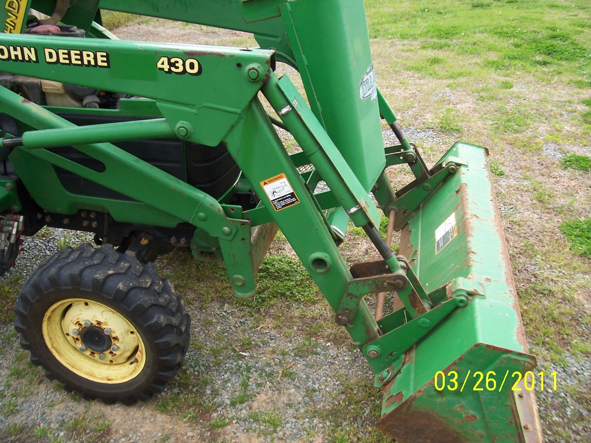

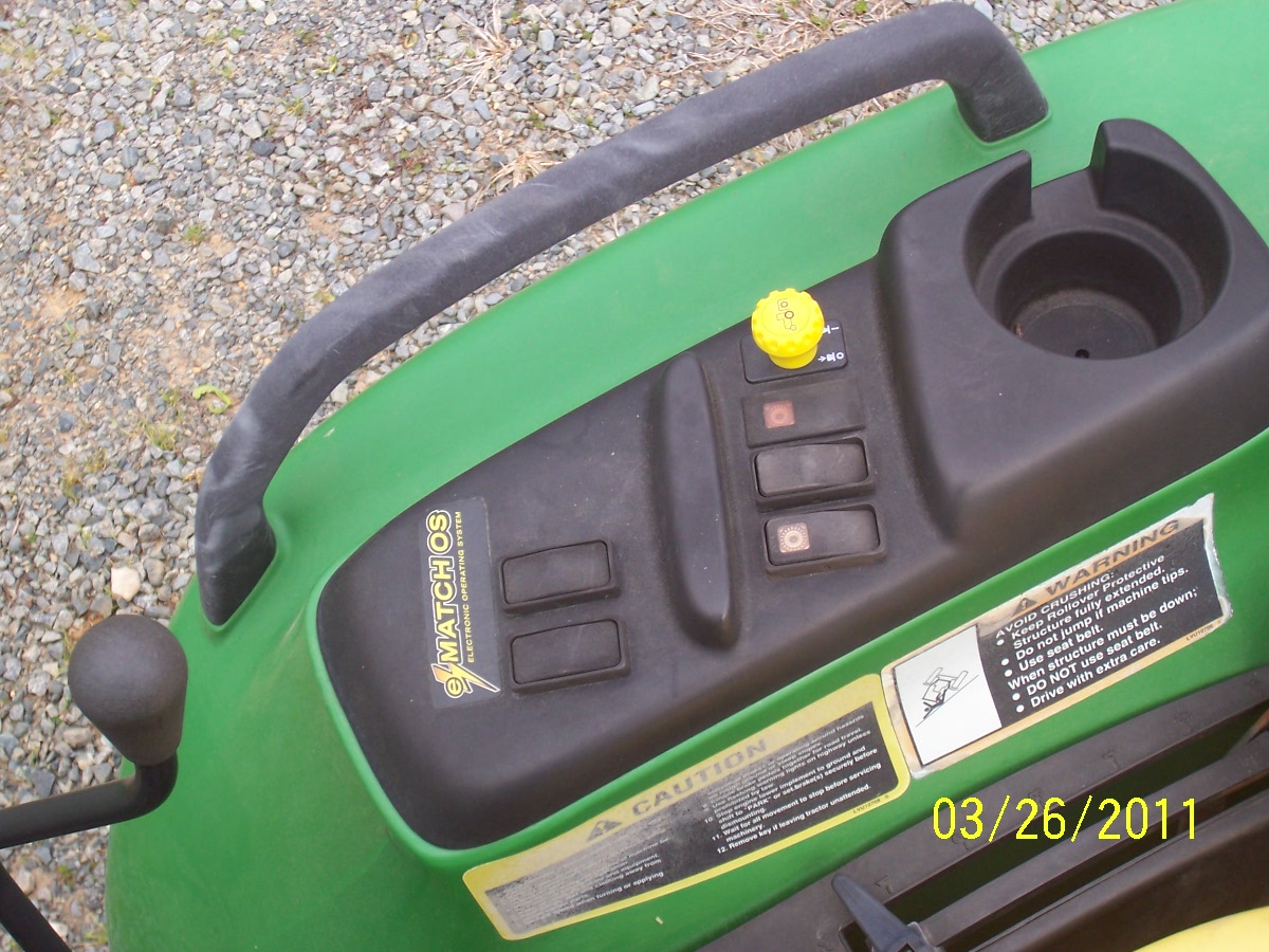

Got it cleaned up some today and some of the servicing. I think I got a pretty good deal. Nothing much wrong with it, resonably low hour, and the loader is mounted securely. When I took the side cover off to get to the engine oil filter I got a since of how this been used and service lately, the filter was marked as being installed at 800 hour (there is 950 on it now) and that was 4 years ago so it has not been seeing much in the way of regular use for some time. The air filter was very dirty so I replaced it today. Should be draining the transmission in the morning and the front axle as well as cleaning the suction side screen in the transmission.

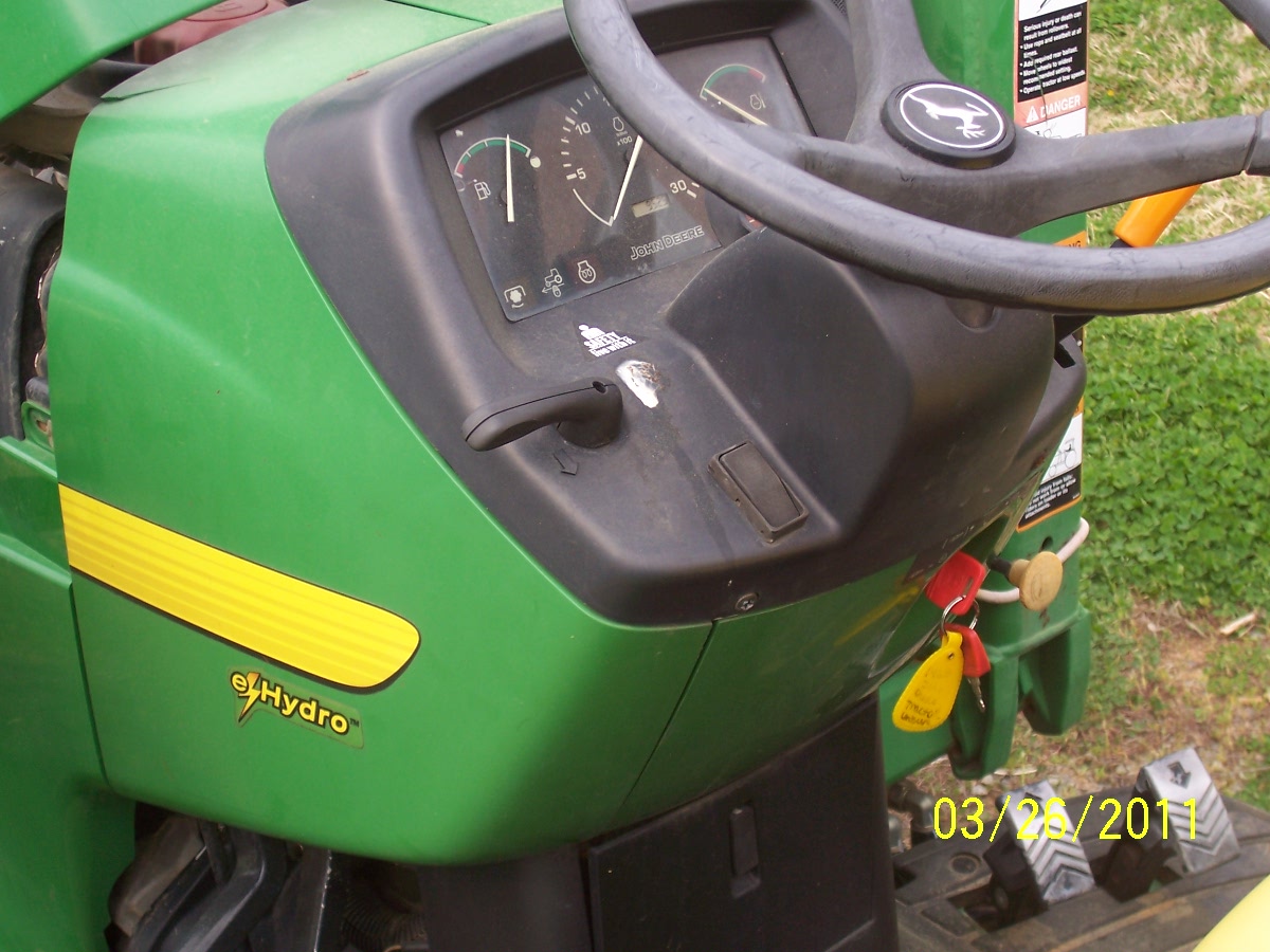

Congratulations on the 4410! It sounds like it is going to be a really good tractor for you. Is the Tach. meter working in the picture or is the tractor off? With your light i think it may be a corroded wire from sitting outside and seeing some use in abusive locations. Glad to see it has an owner who will take good care of it and make sure it lasts a long long time. :thumbsup:

The tractor was turned off when the pictures were taken. I haven't found anything that looks like it could be causing the problem with the lights but I haven't really gotten to any of the wiring. I suspect the fuse panel comes out and that the problem is behind there. I figure getting fresh fluids, filters etc. comes first.
