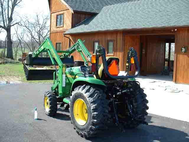

The loader sure is easy to take off and put on. The mower is easy but not as easy. Don't need any tools for either.
Time for the loader is 3:15 including caping the hyd.
Time for the mower is 9:15
The times will improve with experiance.

How often do you plan to remove the MMM? Also, what's the blue thing in the foreground of the picture?
/ 4410 Loader and Mower
I don't plan on taking the MMM off as much as I do the loader. The wife will be using this to mow with (and the 345) whem I'm out of town. The blue thing is a hyd jack I used to lift the deck after I moved it out from under the tractor. Its unbelievably heavy. The only way I'm going to get to the blades on this thing is by using the loader to stand it up.

jimmo, Your picture is hard to see back of tractor. Do you have a top & tilt? It looks like hydraulic lines looped around back there.
Yes, that is top&tilt. Here is a little bit better pic. (still not very good)

When I got the tractor the dealer had the tires loaded because of the FEL which I thought was a good thing. As it turns out I decided after 1 day that loaded tires are not good for mowing. Just too much compaction. After I drained the tires through the valve stem I laid them over and the bead broke and the left over water/alcohol drained out. Used a chinch strap around the tire to set the bead and after 15 minutes of pumping with my 12 volt pump I was back in business.
As far as I know the tires are standard size. Also the dealer said there was no "stance" diferance when mounting the tires. I measured the hub to rim size and there is a 2.5 inch diferance. So I mounted the tires on the other side for a wider stance. The only drawback to this is the valve stem is on the inside. There was a question about weather this would work with the 72 in MMM. There is no problem, plenty of clearance. I mowed the 6 acre pasture just to make sure. Great mowing machine.
