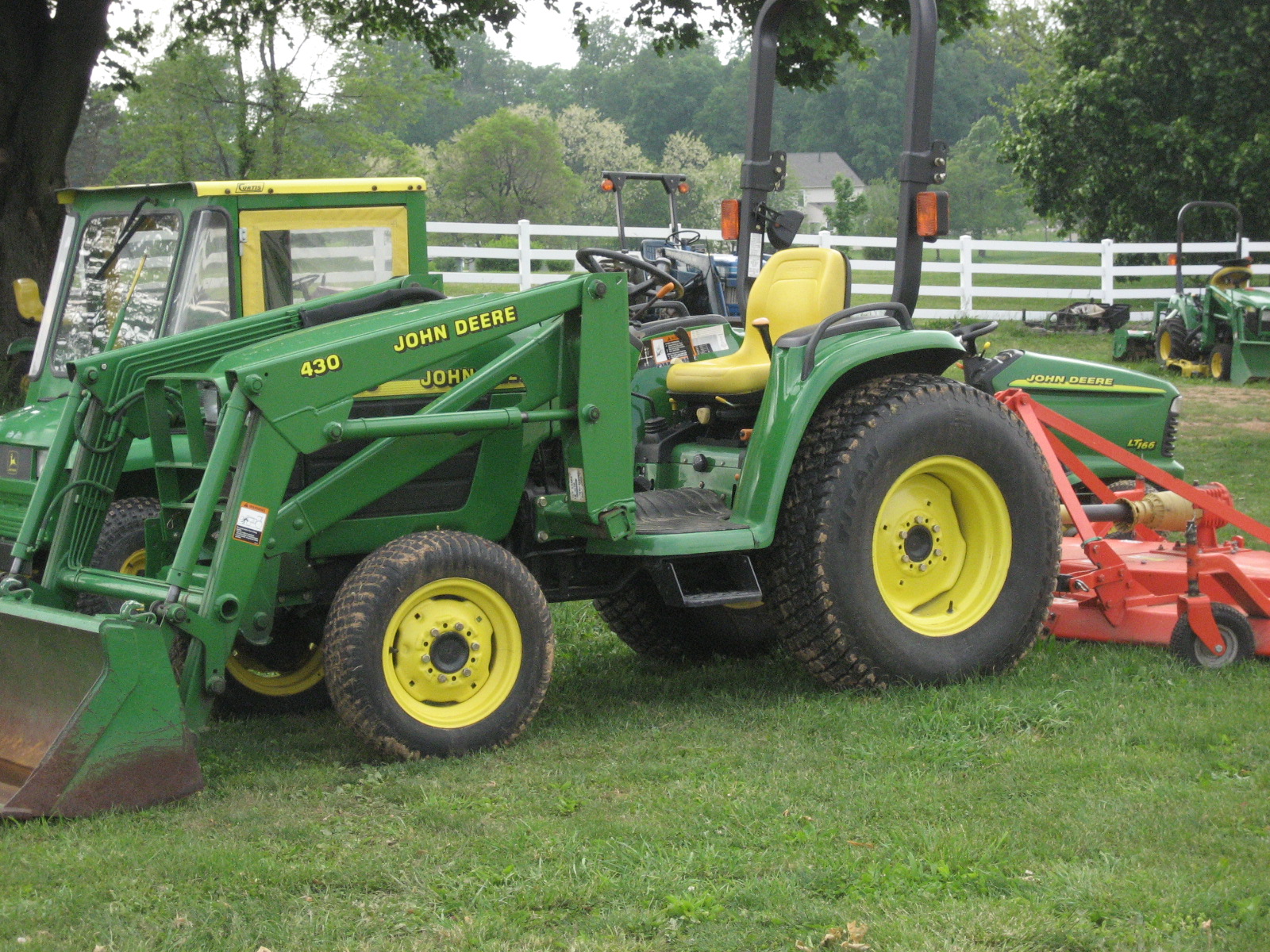

Just for comparison, I bought a 4400 (predecessor to the 4410) with 800 hours and in excellent condition for $13000 last summer.
This one has a reverser transmission.
The mower, a 7' Befco, was part of the package.
I do think I got an outstanding deal though.
If it's a good tractor, I wouldn't wait long...you'll miss it.

well i picked it up. got a 5' JD 513 brushhog, and old ford 5' disk and the 4410 for 13500 out the door.
already loving it. we are restoring an oliver and used it to move it around and take off the cab for it.
diesels rule!!
