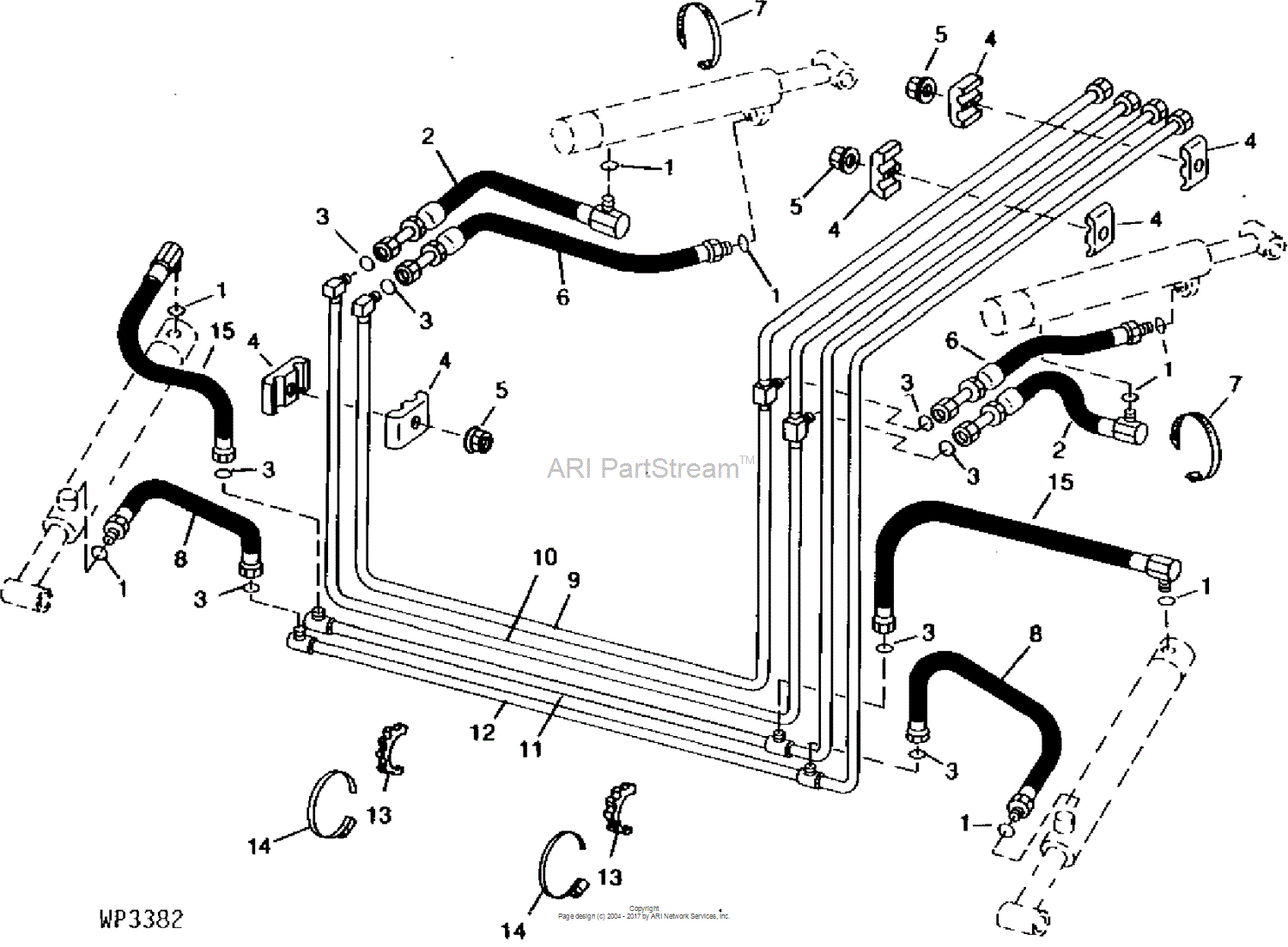

Hi,
I recently came into possession of a JD 870 with a 440 FEL. I'd like to replace all 8 of the FEL hydraulic hoses as they have seen better days.
My question is what type of fitting is used on these hoses? Looks like they may be ORB or ORFS but perhaps they could be a metric version as well.

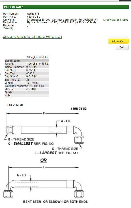

The information you desire is readily available on most parts on JD parts website by putting part # in ones shopping cart then left click on each part number to reveal part specifications similar to photo below.. There are many different hose configurations on a JD 440 frt end loader. I've been operating very successfully my farm equipment in a custom farming operation for 31 yrs under a different theory than yours which is "fix as fail IE if it ain't broke don't fix it".

I was told in my youth curiosity killed the cat so I'm wondering if you read the spec's in the photo I posted with correct size & type of hyd fitting plus correct ID & length of hose for that 1 particular hose for your FEL?
