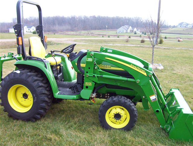

My tractor finally arrived today! Thanks to everyone for all the help. After all of the negotiations with different dealers I came in right at 20% off list.
A couple of things I noticed right away, one is the importance of 4WD. I went up to a pile of sand and started pushing to get a load and the tires started spinning. I figured lets see if the 4WD will make a difference and she pushed right on through. I didn't have 4WD on my 855 and now I know what people mean when they say it is a must. The other thing that surprised me was when I got the full load of sand in the bucket I shook the loader to get off the excess and the back wheels came off the ground just a bit. Scared the **** out of me. The tire are supposed to be loaded with Rimguard and that never happened on my 855. The bucket is now 5ft and on my 855 it was 4ft but I wouldn't think it would matter that much.
Does anyone know if there is a big weight difference in Rimguard vs. I think I had calcium chloride in the 855 tires?

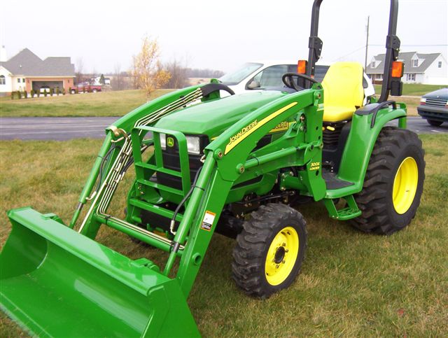

Another pic

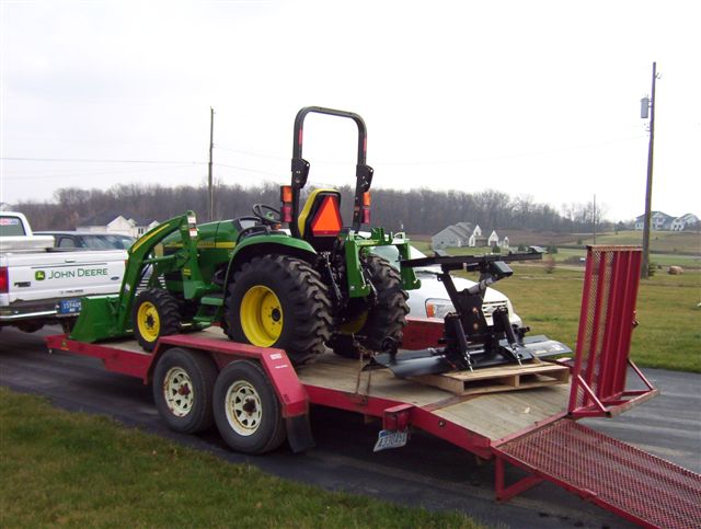

Last pic!

V E R Y Nice!! /forums/images/graemlins/cool.gif Congratulations.
Great looking set up. /forums/images/graemlins/tongue.gif
And you remembered pictures too! /forums/images/graemlins/smirk.gif You're definitely off to a great start.
Now get that ballast thing remedied, and dirty her up! /forums/images/graemlins/wink.gif

The Rimguard is HEAVIER than calcium. Mut I bet the bigger bucket is more capicty than you suspect... Rear ballast on the 3point is a must. A box blade might do the trick, but a ballast box is even better...

That is really a sharp tractor. The FEL has some nice lines.

Filling the tires helps, but the farther back the ballast the more effective it is. You'd best get something heavy hanging off the back. It's also possible that they forgot to fill your tires, or did it improperly, I suppose.

I might be wrong but I could swear in that last pic one of your neighbors is "green" with envy /forums/images/graemlins/grin.gif

Thanks guys! Much appreciated. I'll probably get either the imatch ballast box or a box blade. I just assumed that the loaded tires would be adequate. I noticed in the manual for the 300x that they recommend loaded tires and a ballast box. After looking at the bucket compared to my old woods loader bucket it is much larger.

Nice looking tractor Jim. I like that new loader, looks just right.

The new machine looks great! As I was looking at the pic (before I read the thread) I noticed your 4310 looked different from all the others I've seen. I then noticed you got the new 300x loader. Very cool! /forums/images/graemlins/cool.gif
