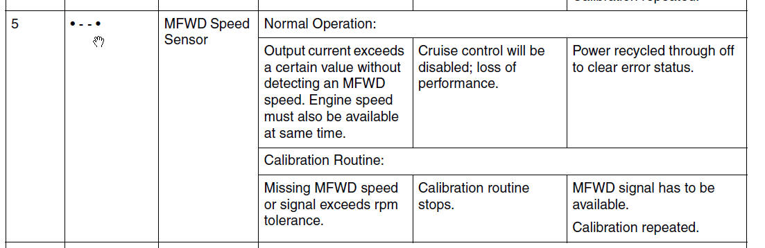

i have a jd 4310 hydro and i understand that there was a problem with the drive controllers/computer on some a while ago, where can i find out which ones?

What problems are you having?
the cruise control doesn't work at all but the max speed works
I replaced both console switches
both cruise and max speed use the T2 MFWD speed sensor so it doesn't appear to be that
I have the maint. manual and looking at the wiring diagrams I don't see any other parts but connections it could be
I checked the brake switch with a multimeter and when I press on the brakes the switch functions
there doesn't seem to be anything wrong with forward petal pot as it runs ok
would the cruise indicator light being out cause any thing
I did occasionally get a fault indication about the mfwd sensor, short long long short
what is the easiest way to get at the mfwd and flywheel sensor? for someone with stiff joints?
any help you could give would be appreciated
