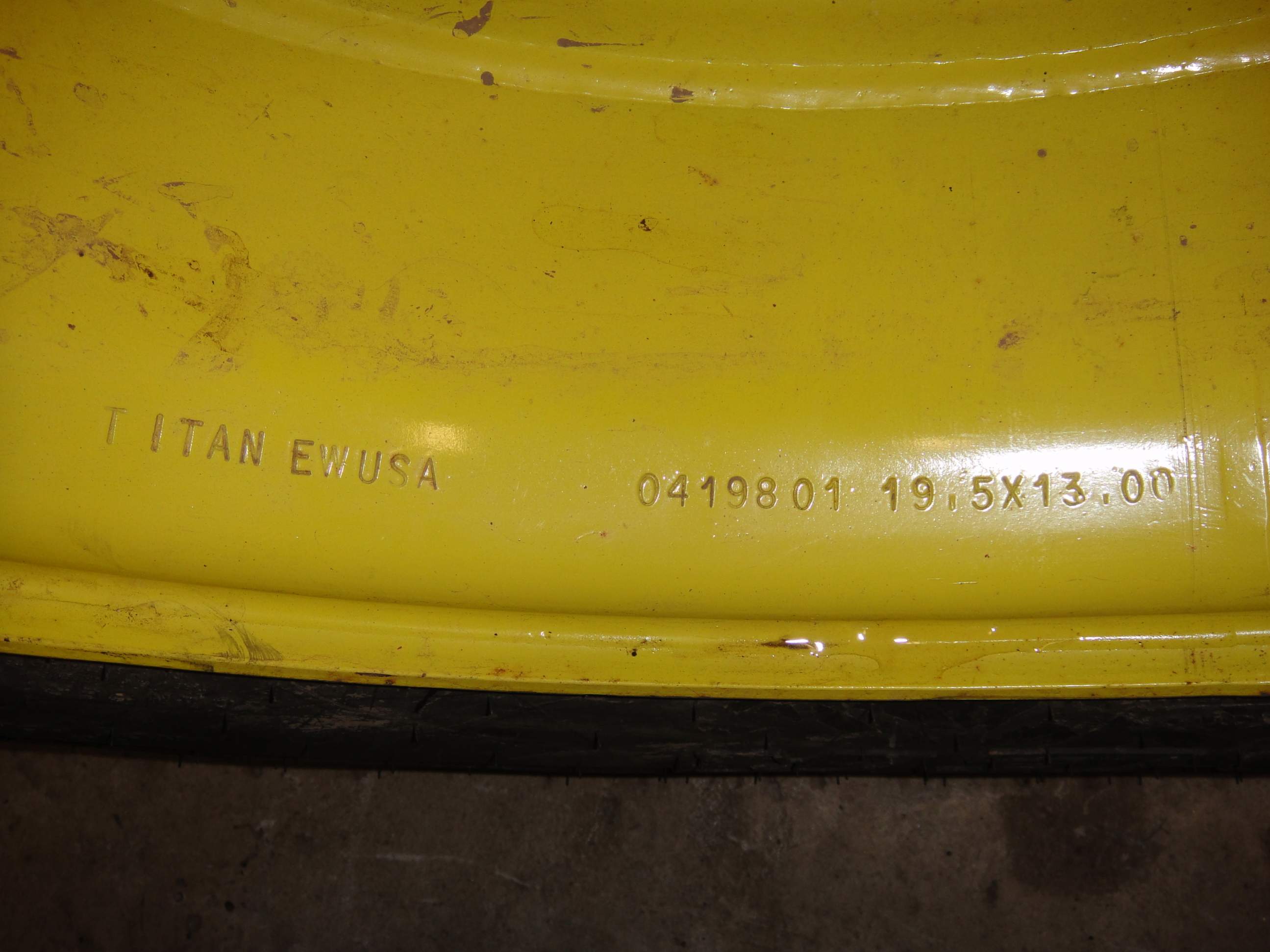

Does anyone happen to know if I can swap R4's with rims from a 4310 with turfs and rims from a 3720?
/ 4310-3720 wheels #2
Don't know, I have a 4310 with r-4's this is what's stamped on the rim. Maybe a JD dealer's parts dept question.
JB.

The wheels may physically bolt on, i think
the bolt patterns are the same.
what may be different, is the tire sizing.
i believe that JD changed tire sizes along with
their MFWD gear ratio, which would make older
tire sizes not compatable with the MFWD.
it is certainly worth confirming before going forth.

Just compared the 4310 with the 3720, and both specs list the same turf and R-4 tire sizes.
Turf 41x14-20, and R-4 as 15-19.5
/ 4310-3720 wheels #5
Did they change the size on the 4310 some where along the way, Look at the picture of mine, not sure but I assume that is the size?
19.5X 13.00 That's stamped on my R-4's rim.
Just curious :)
JB

I was thinking that might be a rim designation, rather than the tire. Others may know for sure.
What is on the sidewall of the tire?
/ 4310-3720 wheels #7
Good question, I'll have to check tomorrow.
/ 4310-3720 wheels #8
Yeah, that's the wheel size....your tires are 15" wide or 19.5-15 R4s.

Just checked mine and they are 15's, never paid attention to the tire size even when getting chains, since I custom made mine from surplus.

I kept my turf specials from my former 4310 for my 3520. Well the fronts went on with no issue but the Rears have a different bolt pattern so I had to buy a new set of rear wheels to make it work. No issues with the tire size.
/ 4310-3720 wheels #11
If the bolt patterns are different, that sure answers the OP question....can't be done.

Thanks guys. That is what I was looking for. One would think it would be cheaper to stay with the same tire and rim. Oh well.
