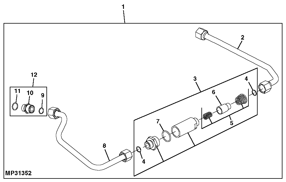

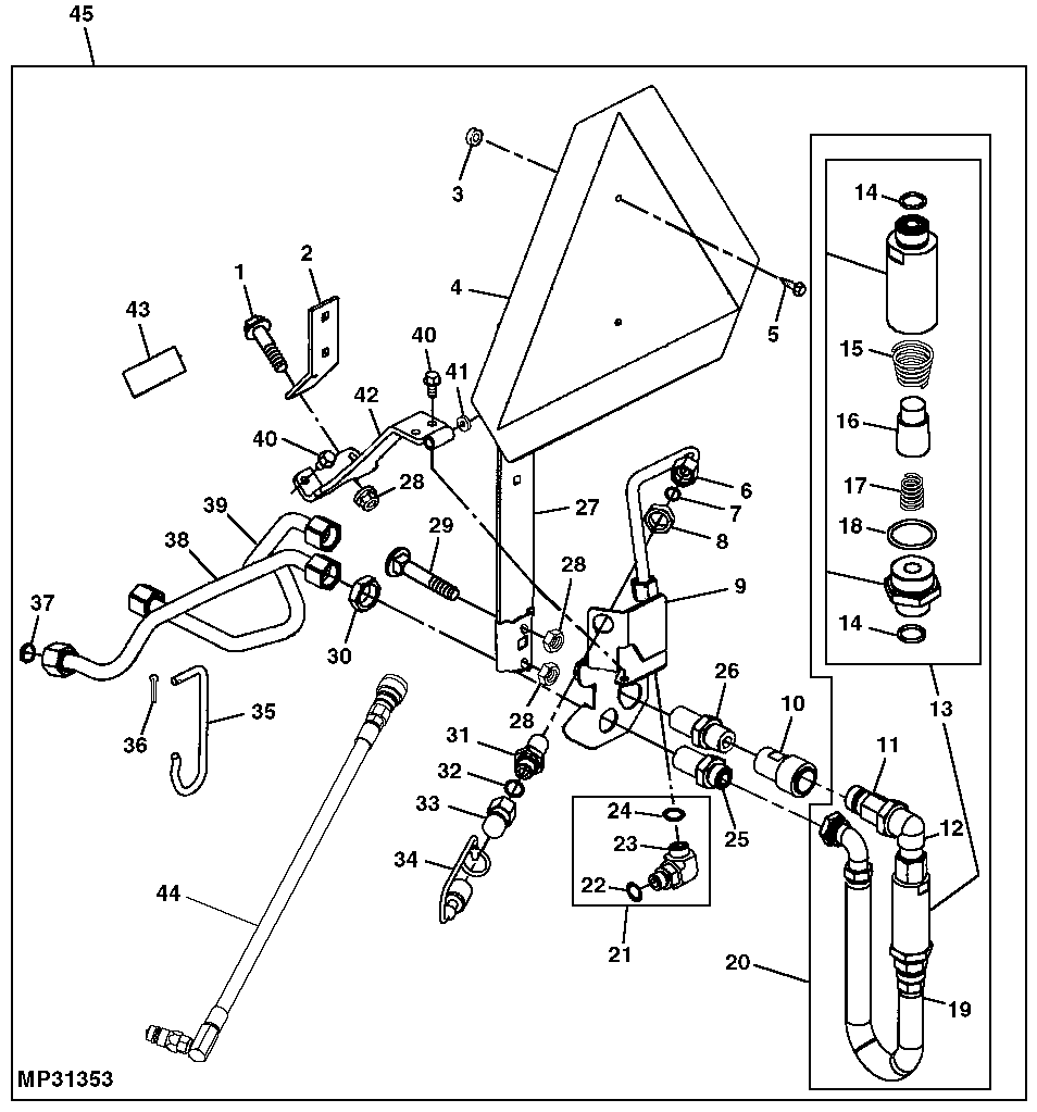

There is no "block" on your machine like the 2x20 series.
The tube that crosses the rear of your machine over the PTO (see first picture below) is replaced with the PB tubes (see second picture below).

Here is a drawing showing the layout and location of the pressure tubes. Shows the rockshaft pressure tube (2) coming from the 3 SCV valve feeding the 3 ph assembly, crossing over the top (right under the seat and just in front of the hyd oil filler plug).
Original 4300's had a screen in one of the fittings at one end, which was replaced by Deere with a tube that had a better screen about halfway in the tube (seen in kennyd's first pic two posts ago). The original screen was blowing out sometimes, and finding its way through the system which led to some debris problems.

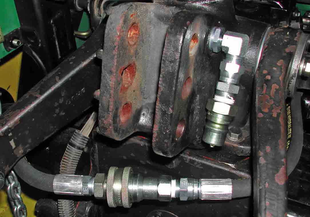

this is the thread i was thinking of....not a 4300 which is probably why i had trouble finding it again.
but, he shows some stuff that might help us...like the 'block' with the extra ports. i'm guessing this was already on his tractor as it may be on our 4300's?
Some tractors use a hydraulic block to add AUX valves; the 4300 does
not. What you may be remembering is the 4300 has several threaded plugs
that allow you to readily dump hyd fluid from the OUT of your last valve
into the sump.
I replaced the "rockshaft pressure tube" with two short hoses, which you
can use for the IN and PB of your new valve. Since a backhoe valve has
no PB, I used a port next to the toplink connection for OUT. Since you
need to use the 3-pt cyl with TNT, you will need a valve with PB and you
will need to have a low pressure OUT to the sump.
