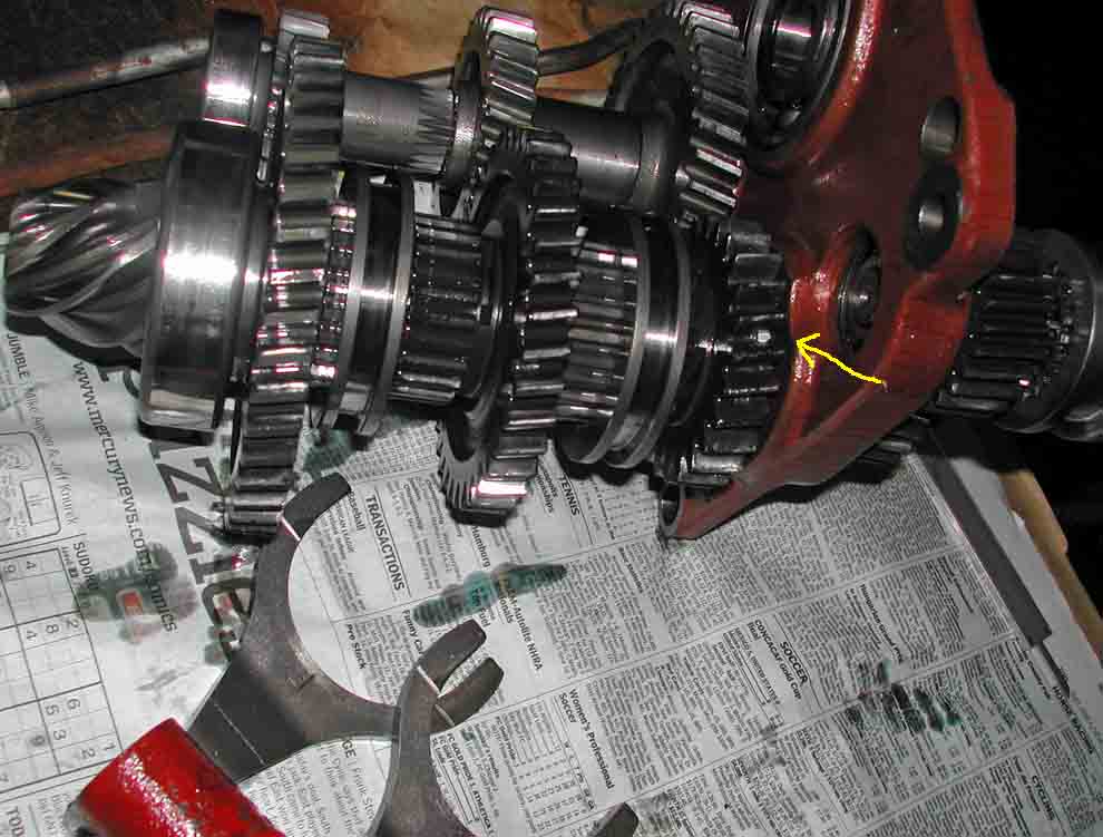

/ 4300 Range Shift Repair #20
So its not adjusted right I guess. Anyone have a picture of what needs adjusted?
Does anyone have an HST with a smooth as butter range selector? And really clear detents?
There is no adjustment really. That assumes parts external to the
gearbox are lubed well and not binding or sloppy. This photo shows the
two collars that are shifted simultaneously by the two forks. If all the
teeth are not lined up right, shifting will not happen. And it is very easy
to go right past the neutral position into the next range.
As for smooth operation, mine is very smooth and easy after my rebuild,
but the detents are not very clearly felt. I may have gone too far in
softening up my detent spring. It was hard to test at the time unless
all the linkages were installed. The shifter gives you so much leverage that
what seems hard enough to turn at the bell crank was way way easier
using the shifter.
