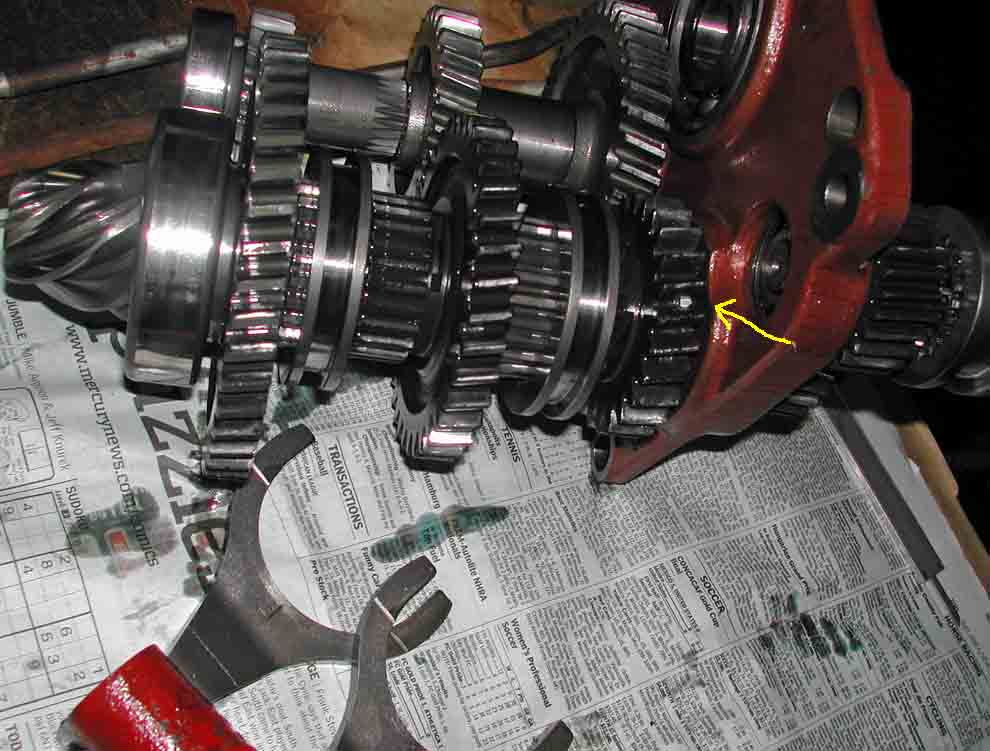

Thanks for these pics mine just broke this shaft!
/ 4300 Range Shift Repair #36
I sure wish the pictures were available for this write-up. Would help me a ton to understand what I'm looking at in my Shift Fork repair. Any way to get these pictures back?
