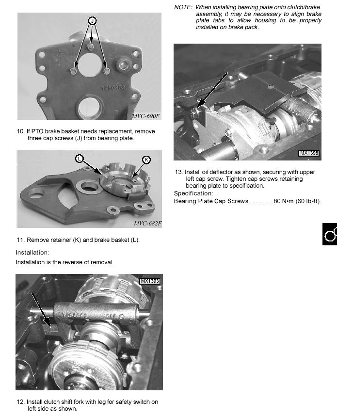

The PTO brake basket on my 4300 is designed to freely rotate maybe 120 degrees while the PTO is Off (braked) so you can turn the PTO shaft by hand to get the driveshaft to go on. It is not a neutral.
when my engine is off, i don't think i can spin the pto by hand in either the engaged or disengaged/braked position, only in the middle position.

All I can say is that I have the latest Tech Manual and parts PDFs from
JohnDeere, and there is nothing in either to indicate there is supposed to
be a neutral option. I operated mine many times with the top off to see
how it was supposed to operate. I still don't like it. If you can disengage
the PTO without jambing the brake on, that's a good thing. If I get the
last 4300 at the rental center, I am considering eliminating the brake
entirely. It is unnecessary and causes too many problems.

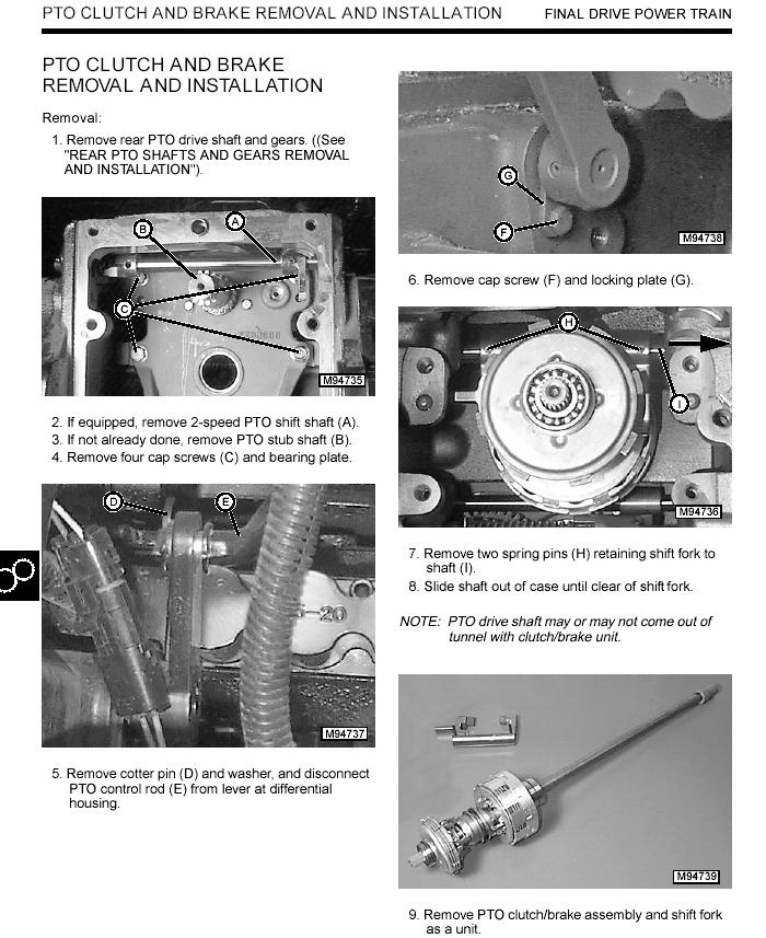

section 8-66 - pto theory of operation...seems to indicate only on or off...and that the pto should turn slightly when 'braked' to align attachments (which mine does):
A locking tab on the outside of the brake housing allows the PTO drive shaft to rotate approximately 330°, which, in turn allows the PTO stub shaft to rotate approximately 65° to aid in aligning the splines of attachment driveshaft during hook-up.

The only thing i waqnt to add is that wherever i had that lever "set" was obviously between stopped and fully engaged. I ran around mowing for 15 minutes hals-***** engaged, because my shredder kept coasting to a stop when i got into anything heavy...
Basically i was probably heating up the clutch discs spinning the **** out of them. wheni DID finally get it engaged, the disks were probably hot and stuck/melted together... now they won't come apart. I will answer that as soon as i tear it apart, it rained and i did not want to start tearing it apart where it sits. will do it this week.
