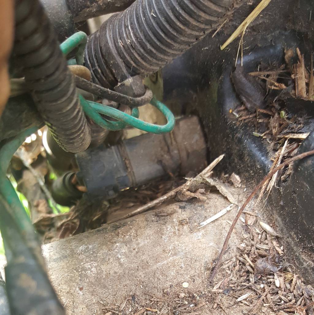

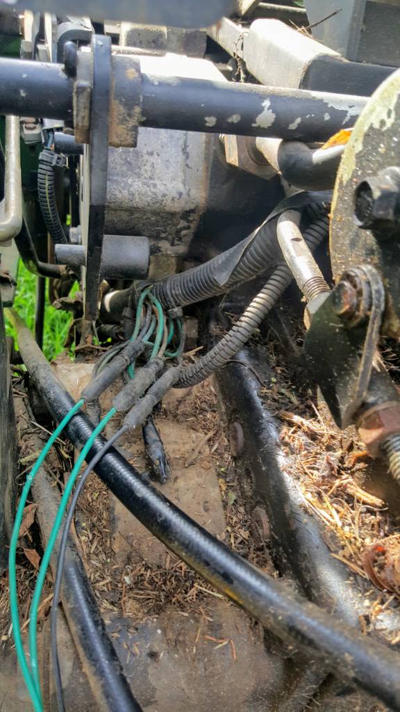

Switch is on the left side, below the rockshaft control valve. See photos below. Not that the left side plastic cover is removed in these photos.
You can barely see the switch under and right of the loose wires that are exiting the loom jacket. 20180908_091133~2.jpeg

There's an old saying that "a picture is worth a 1000 words".....I certainly believe it in this situation. I'd probably never have found it without these!
I really appreciate those pics!!! From the Deere site, it stated that this switch is NC...we shall see. I need to find a way to rig up a jumper for this thing....I'll figure something out.

Pulled the plastic cover off and STILL couldn't see it. Came back up here to the shop and looked at the pics again.
Drove back down there and, sure enough, there it was: live and in person, buried in dead grass and debris. I felt like an idiot.
I pulled the cable connector off and made a wire jumper to stick in it, PTO light went out and she cranked right up like she always does!!!!
The PTO seems to be working fine so I guess it's just a bad switch. Looks like it's gonna take about 7/8" wrench, but man, getting a wrench/socket in there is gonna be tough.
Looking at the parts catalog...almost $40 for that switch and o-ring.....geez. Part# M132725 on the switch and R26448 on the o-ring. I may just leave it permanently jumpered out.
