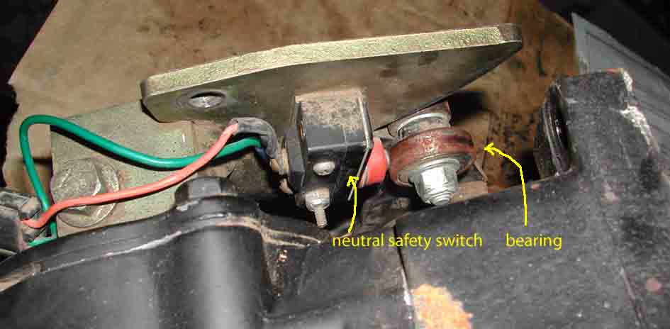

I don't have a picture, but if you lay on your back and look up through the cast hole in the bottom of the transmission housing, you will see it bolted to one of the plates. It's held on with two very small nut & bolts. Should be the only switch you see in the pedal linkage.
It looks just like the picture, not much bigger than a box of matches with a single plunger on the side. Hope this helps a little.
/ 4300 HST Nuetral Switch
Thanks for the description Joe, I found it. That thing is a pain to get off, holy smokes. I ended it just leaving it on after testing it and then bypassing the switch until the local JD dealer can have get the part in Friday. I'm not looking forward to replacing it.

The neutral start switch prevents the engine from starting if the pto is engaged, or transmission is not in neutral. (hydro pedal not centered on hydro)If you have a no start situation, you can bypass the switch to test if it is defective. Or the safest way to test it is to connect an ohmmeter to the switch.

Eventually, it will fail and leave you stranded. There is no clutch, so no
clutch safety switch. It is hard to get in there, as mentioned. In this
photo, you can see the switch has been replaced once. It is gone now.
I have also jumpered the seat occupancy safety switch. HST tractors
are inherently very safe, as long at the go pedals return to neutral.

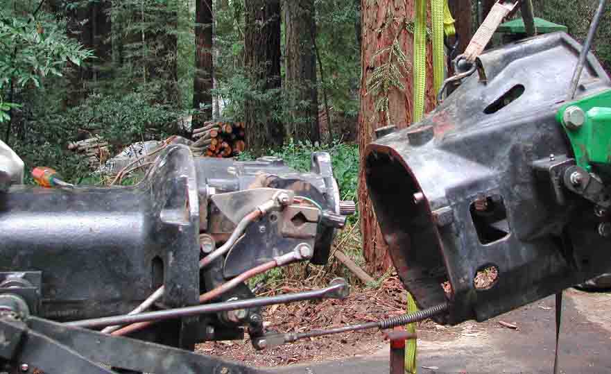

Where is the location of that pic, in general? Shot from below or above? Or with what removed?
Thanks for posting, as I want to locate it asap. :)
It is a pistol to get at with all assembled. That last photo is with everything
apart. This next photo shows more. To service the switch you have to
reach up inside the square hole in the bottom of the tractor. You can
disconnect the wire connector there, or trace it back to the left side and
jumper it there.

Wow! Thanks for the pic.
I really like the backdrop shown in that pic. Looks pretty peaceful and all. :D
