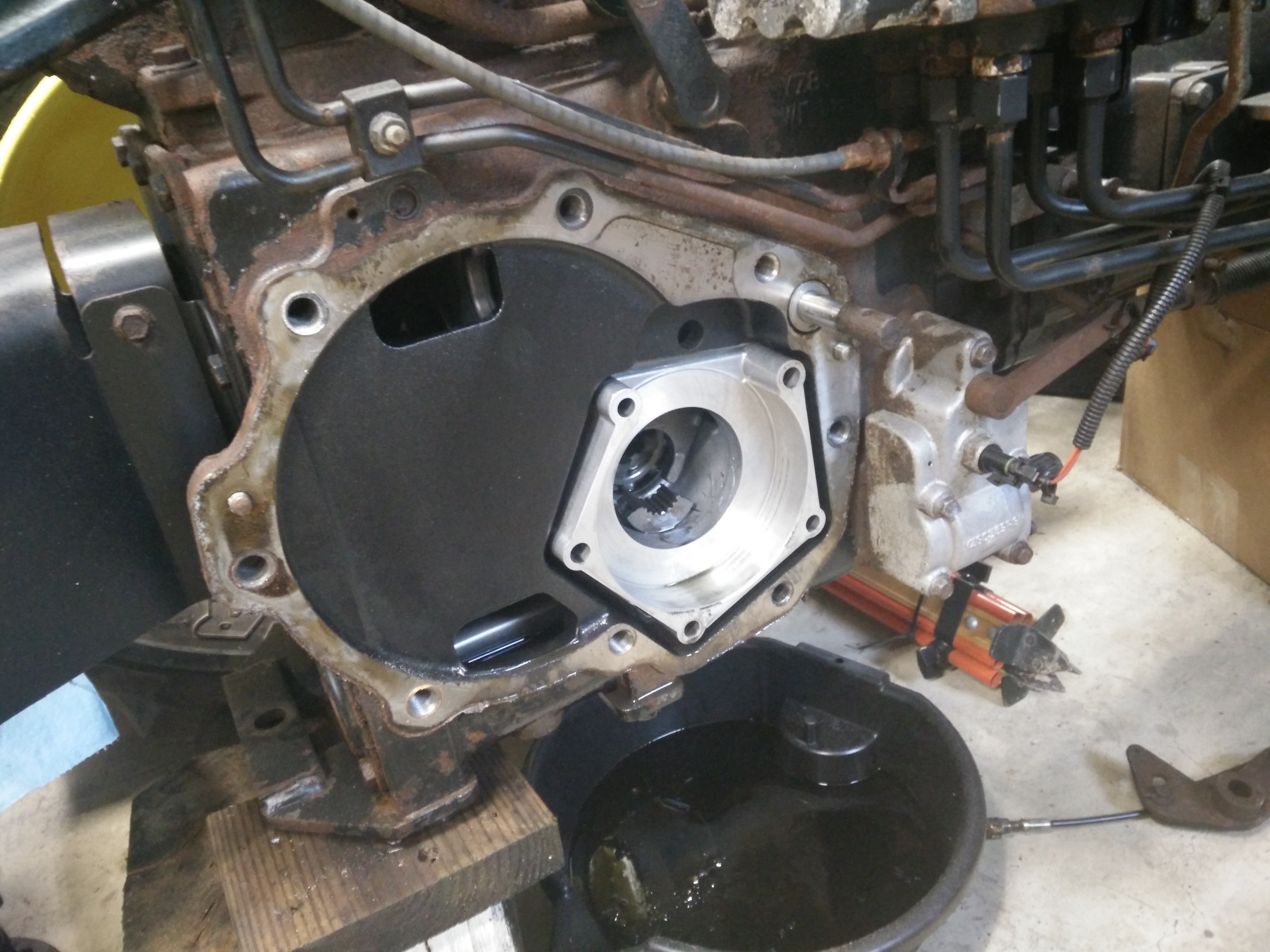

I just ordered a replacement locking collar for my 4300. So far I just have the right side final drive off enough to find the broken pieces. Is it possible to put the new collar in without taking the top off the transmission/rock shaft to disconnect the engagement fork? It looks like it will be close but until I have the new part I can't tell for sure. The previous owner managed to fish several of the pieces out so I don't have all of them to glue back together for a test fit. Thanks!

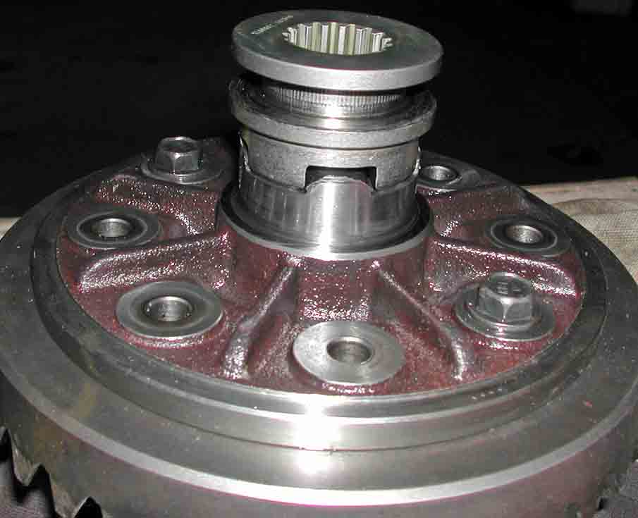

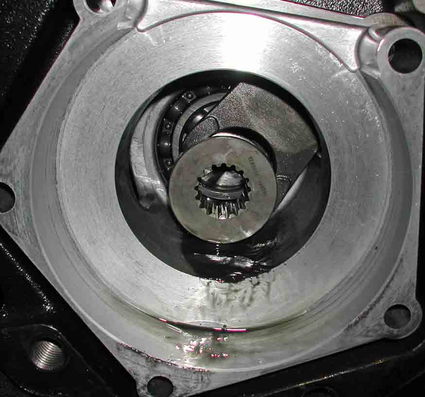

I do not recall if you can just slip the new part over the fork (photo), without
backing the shifter fork out a bit. I had mine all apart.
What is the condition of the other side of the dog clutch? Mine was worn pretty
badly, but replacing would require an all-new ring gear ($$$$).

/ 4300 Diff Lock
Thanks for the pics, that helps a bit. As for the other surface it isn't perfect but not bad enough I would consider pulling it out to touch up...certainly not bad enough to replace!IMG_20160522_141631.jpg

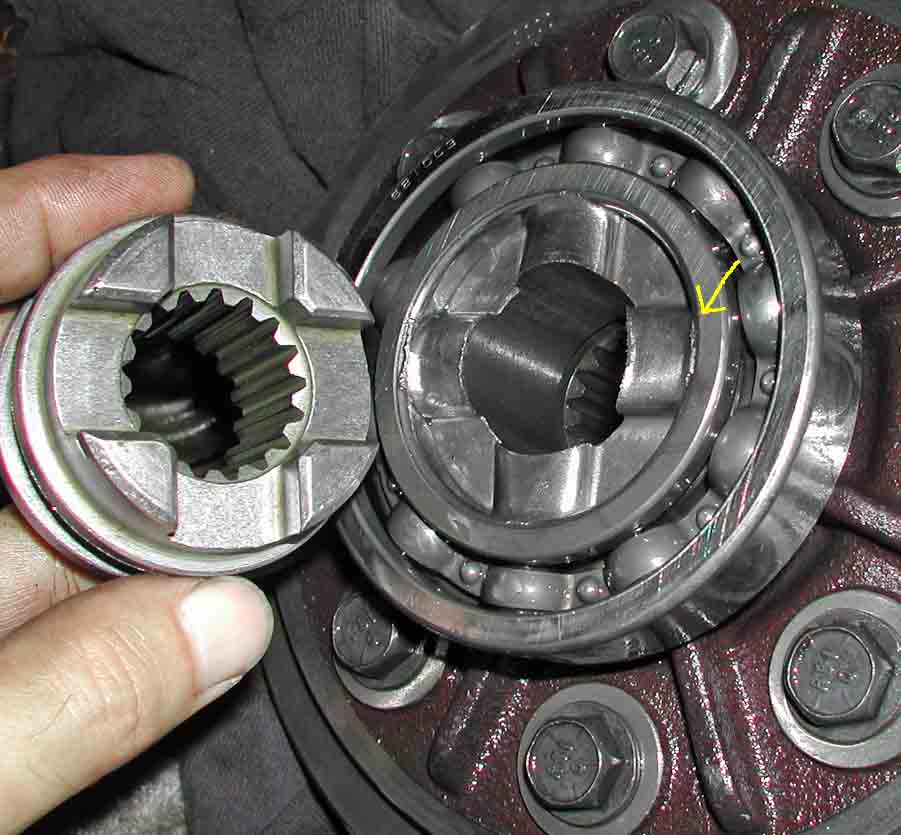

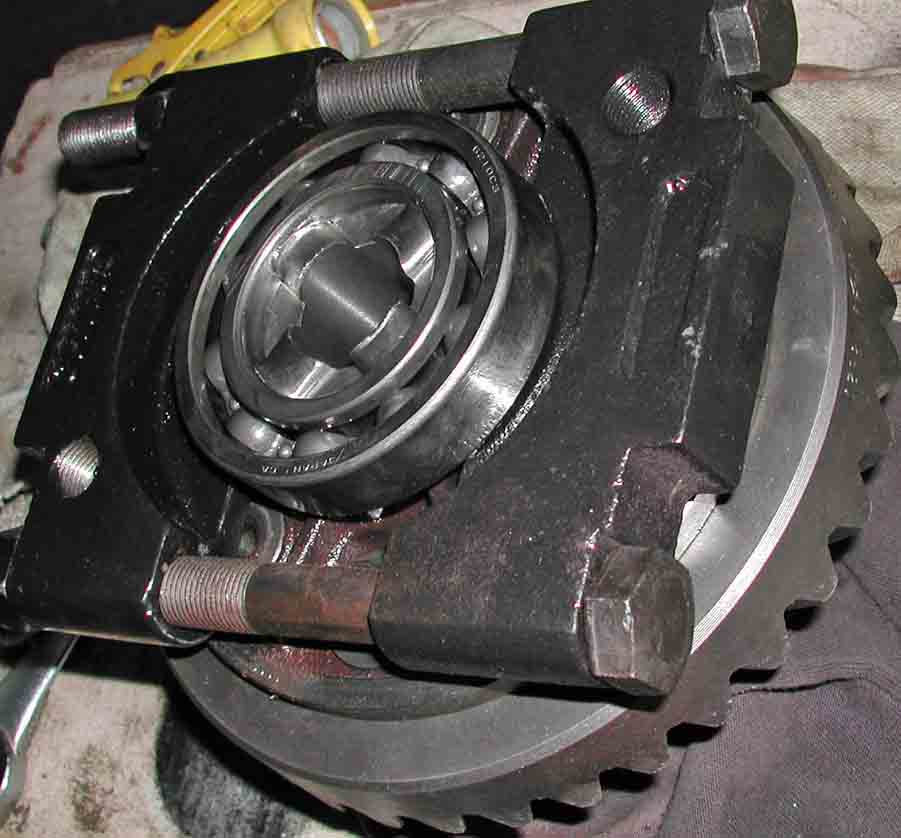

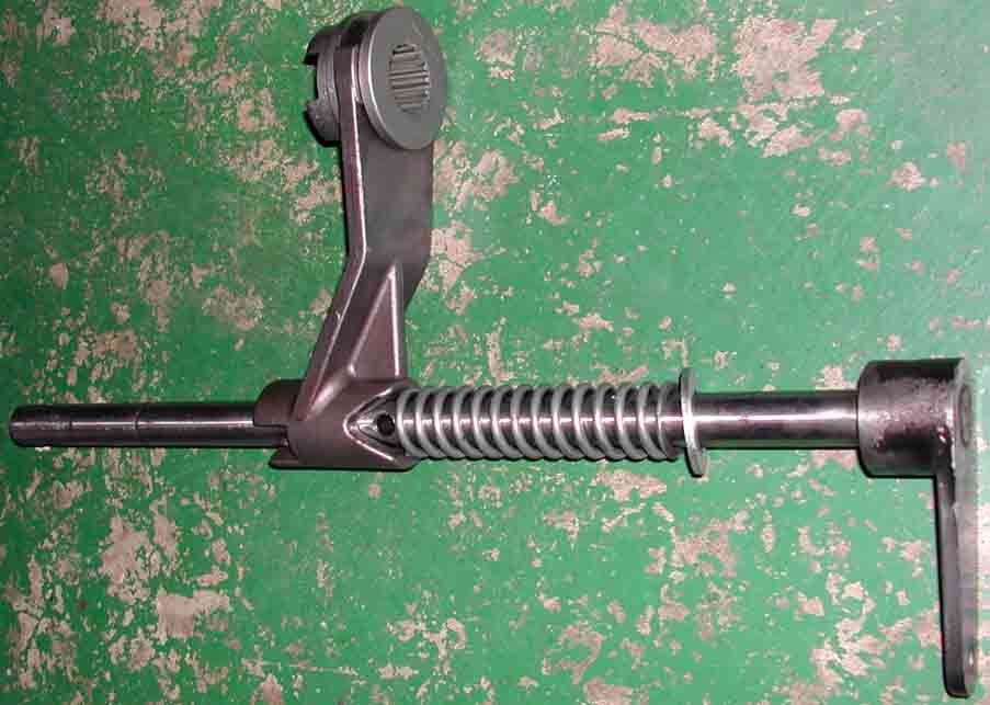

/ 4300 Diff Lock #4
Yeah, the inner side of this dog clutch is softer steel, and the dogs get rounded off.
It is part of the ring gear, so replacing it requires purchase of a ring/pinion set, which
is prob north of $500.
I just reshaped them a bit with an abrasive wheel.
