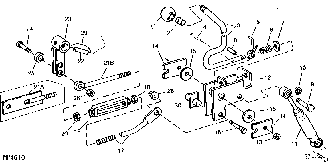

I've got a field I cut (flat and smooth, much like a lawn) and next to it is a hill.
I cut these yesterday. On the flat part everything was normal. (takes me about 2 hours to cut all this)
By the time I got to the hill part, I got most of it done. I kept noticing however, that the forward/reverse lever was acting strange. It seemed as though it was adjusting itself down the scale.
Meaning... I normally (on the flat straight part) have the lever in full speed ahead. When I turn, or otherwise need, I back off to appropriate speed. Well, it was going "full speed" with the lever in the detent location as opposed to full up. I later noticed that my reverse was wonky. Ultimately to later find out I don't HAVE a reverse. Even in FULL reverse, the mower is still moving forward at a slow speed. When I have the lever over in the "start" mode, the transmission is going at a nice clip. If I have it in the "cruise" detent, it's going full speed.
The above is sort of cutting to the chase because before I figured this out....I was going up the hill, it slowed down and near stopped (it's never done this before and just this spring I gave it a new filter and new JD transmission fluid)
Anyway so I'm going up the hill and all the sudden it pretty much stops and the lever starts vibrating/chattering. I pulled it back to "stop" (hahahahaha since it still wanted to go) but the chattering stopped. Then after it calmed down, I could proceed. I have some flat spots that I cut adjacent to this slope and when I went on them, it worked fine (though the range of the lever seemed to have shifted down the column)
I'm a bit perplexed unless there is some attachment near transmission that can allow this to be adjusted relative to the transmission. That however, doesn't explain the chattering (made noise too)
I've never had this happen until yesterday.
Thoughts??
