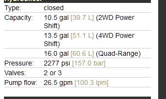

Have a 4250 JD & need to know the gpm flow on the hydraulic pump. Tractor is a mfwd with powershift.
Also is this a closed or open type system? Tia.
/ 4250 Hydraulic ? #2
Closed center. According to Tractordata.com here's the hyd spec's.
