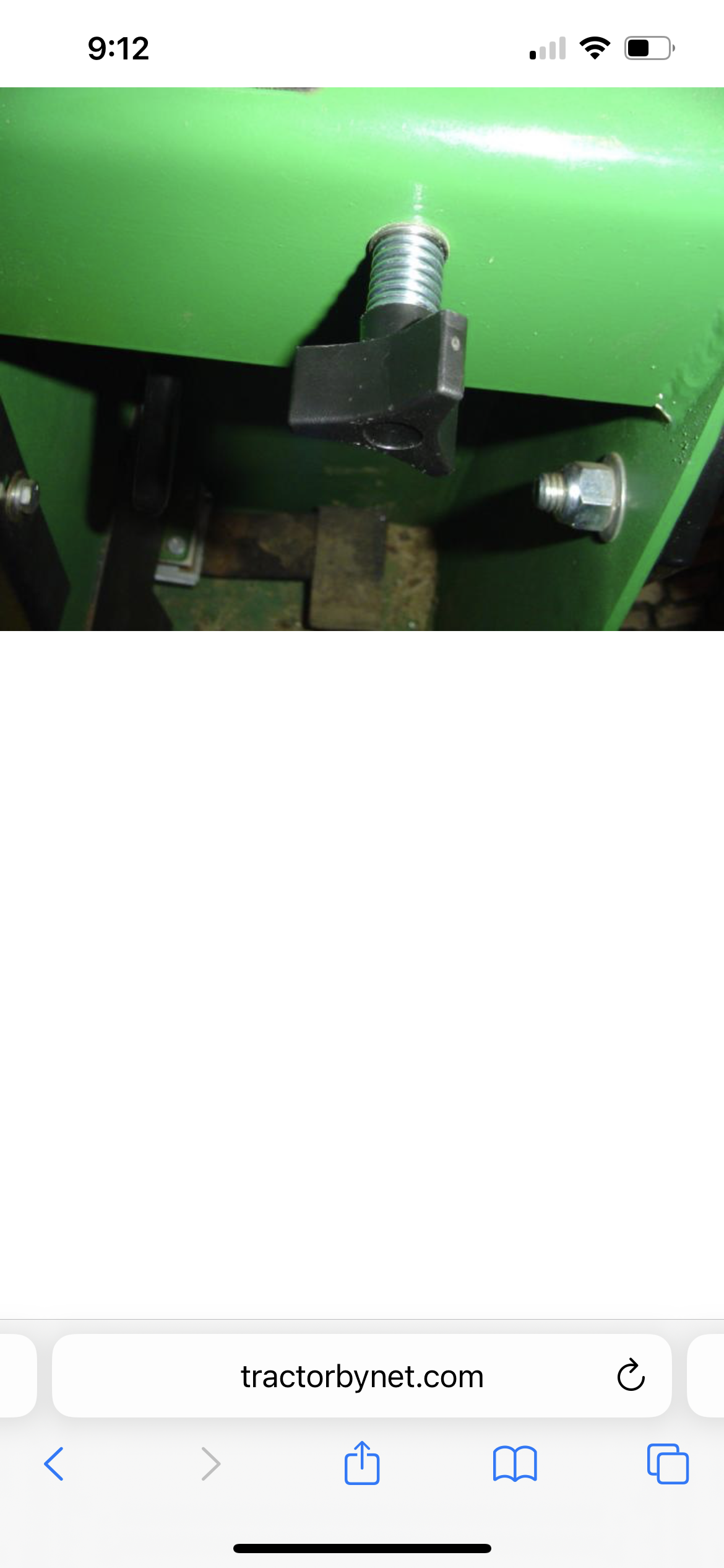

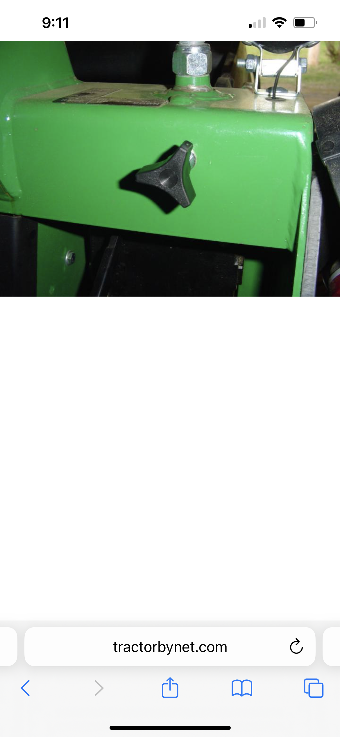

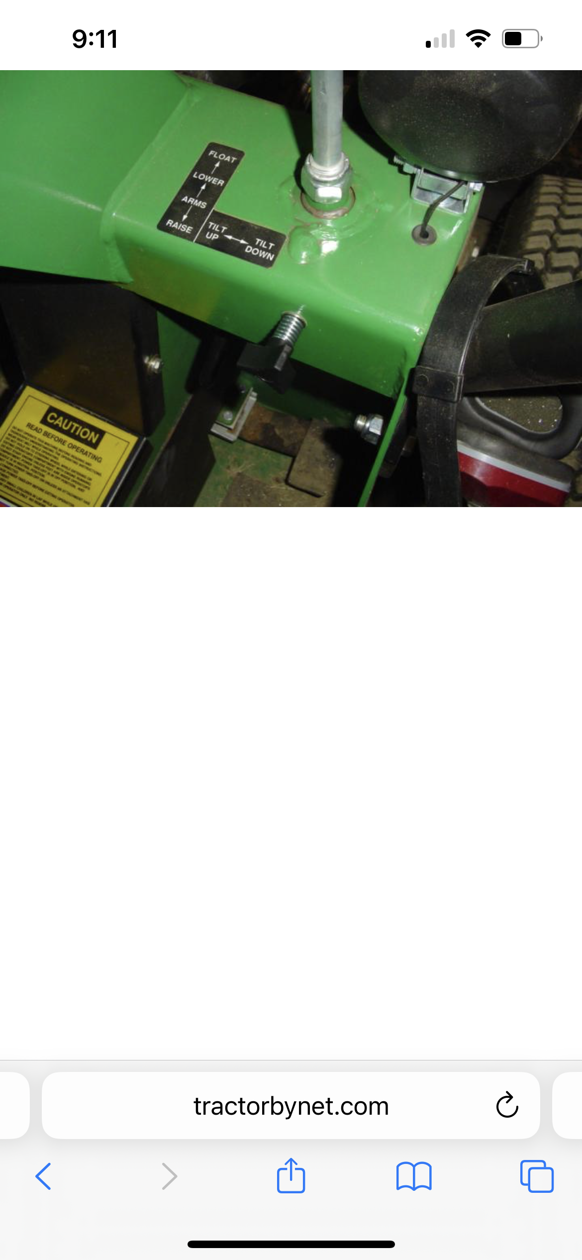

I haven’t logged on in years! Boy I missed this place. Still loving my 425. I use to mow a lot with my 425 and I have what I call a “country” lawn. Mine would jump out of float as well….over bumps, so I installed what I called a float lock. It’s just a star knob with I believe 3/8-16 thread shaft. I drilled and tapped a hole in the dash and when turned in it won’t allow the block behind the dash attached to the loader arm to lower and operate the linkage. (Sounds complicated…..it’s not) The spring just keeps tension on the knob so it stays put when not in use. Weird thing is that for whatever reason I don’t need it anymore. Your problem definitely may not be the same as my problem was. Hopefully an adjustment or lube can get you squared away. Mine problem was more the weight of the heavy handle itself on bumps would be enough to overcome the valve.

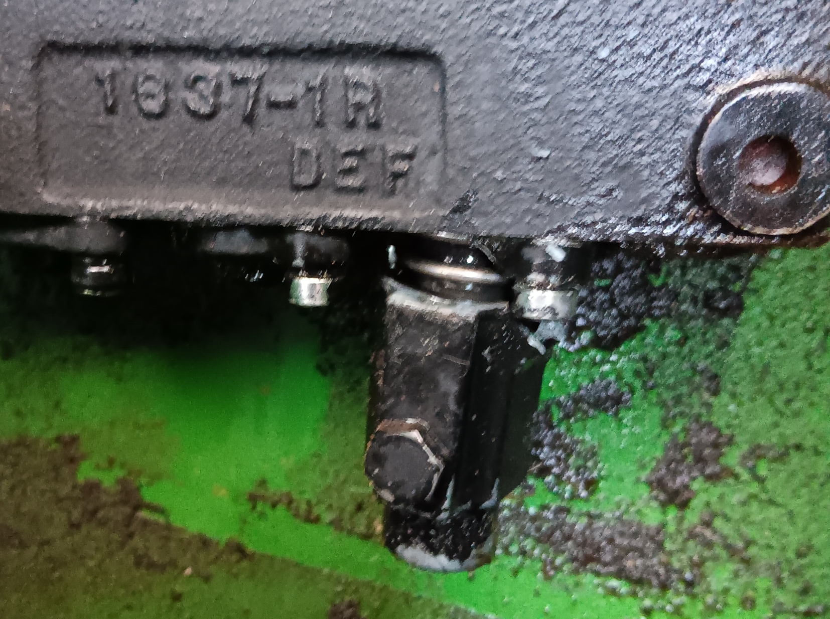

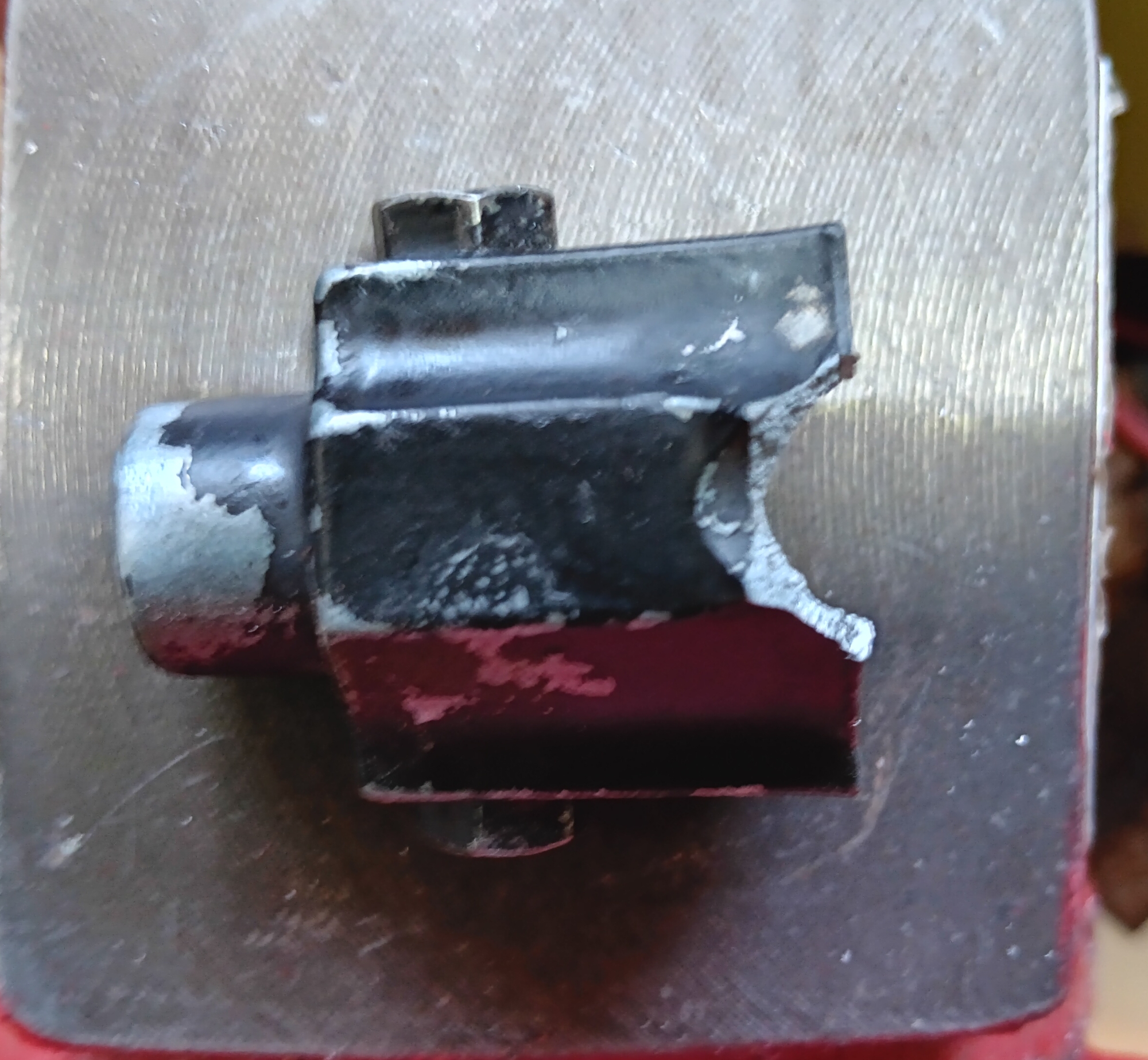

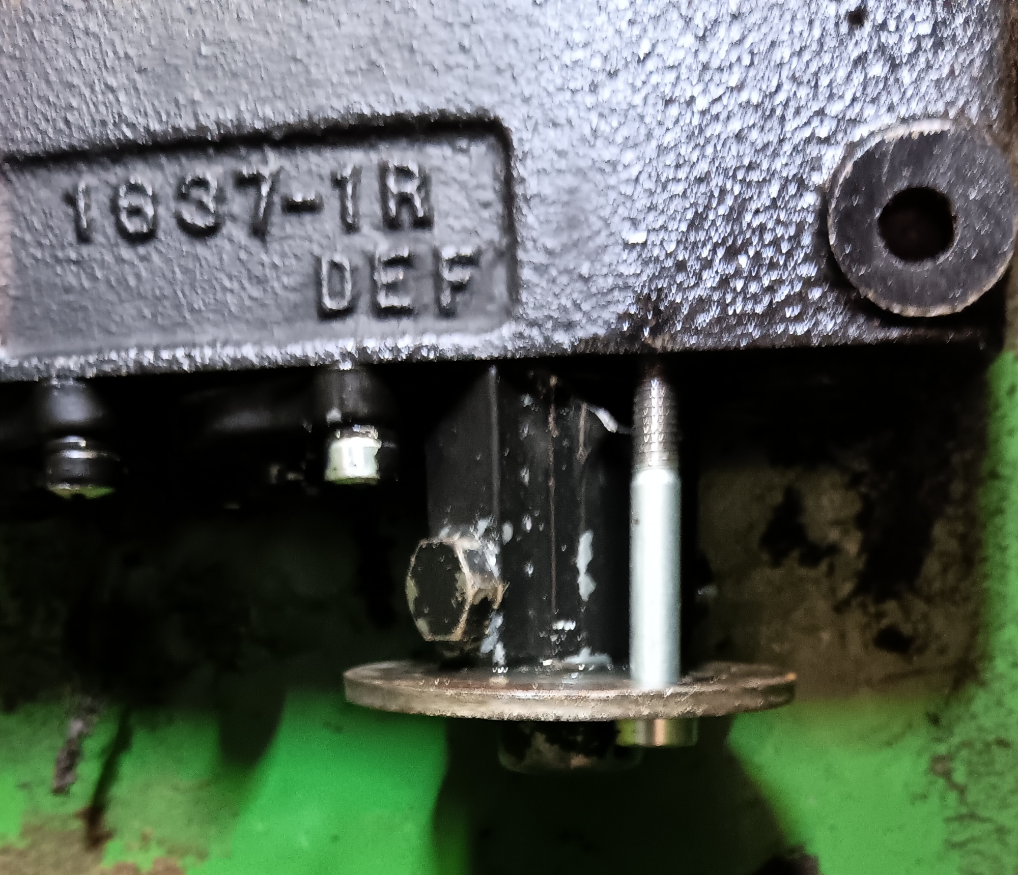

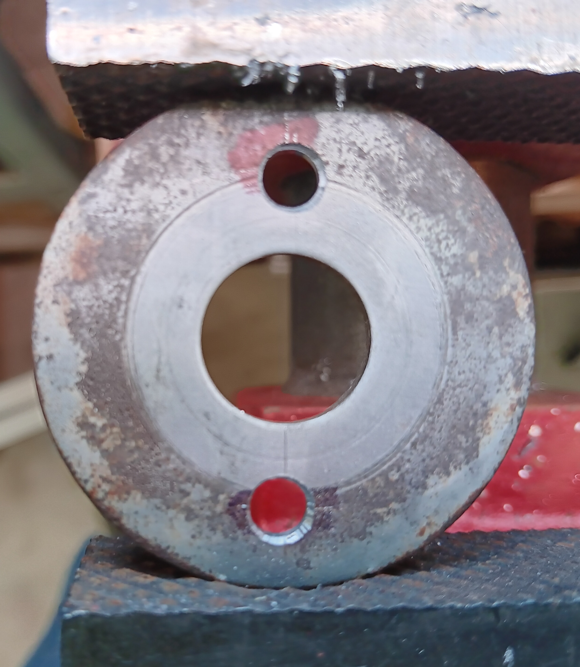

My PT425 started having weirdness with joystick operation and float a couple of days ago. On inspection, the housing that the float detent is in had broken off. It's held on by screws through two ears, both of which had broken off. I performed a "field expedient" repair today and got it working again. It'll be interesting finding out on Monday whether the part is still available and how much it costs. Danfoss sold that division to Dukes, and I couldn't find a part number. It's not clear whether they sell repair parts.
If the part isn't available or is insanely expensive, I'm pretty sure I can make one. It's not a precision part.
Photos of field expedient repair attached in random order after I trimmed them down. Sorry for the blurry shots. My hands shake a fair bit these days.

Thanks! I don't think it's quite centered. There's some drag that keeps the spool from snapping back to the neutral position. I'll have to see if I can adjust that out. But I was able to do my mowing before the rain chances increase this afternoon, which would have been a problem without working float.

I called PT for the replacement part. $275. No, not $2.75. Yeeeoow! Keith was unsurprised when I didn't buy it.
There's still some drag interfering with the spool returning to center, so I have more work to do. I may try to make a new piece. It's not terribly complicated, I've got a lathe, a mill-drill, and several welders, and I'm expecting several rainy days this week.
