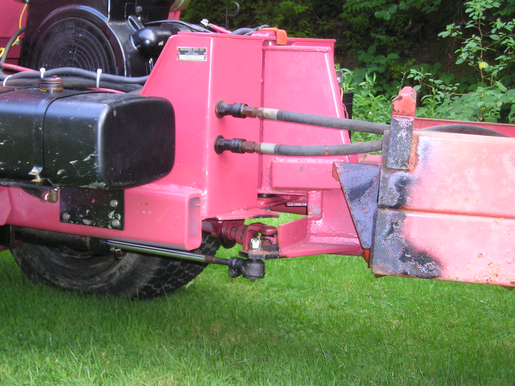

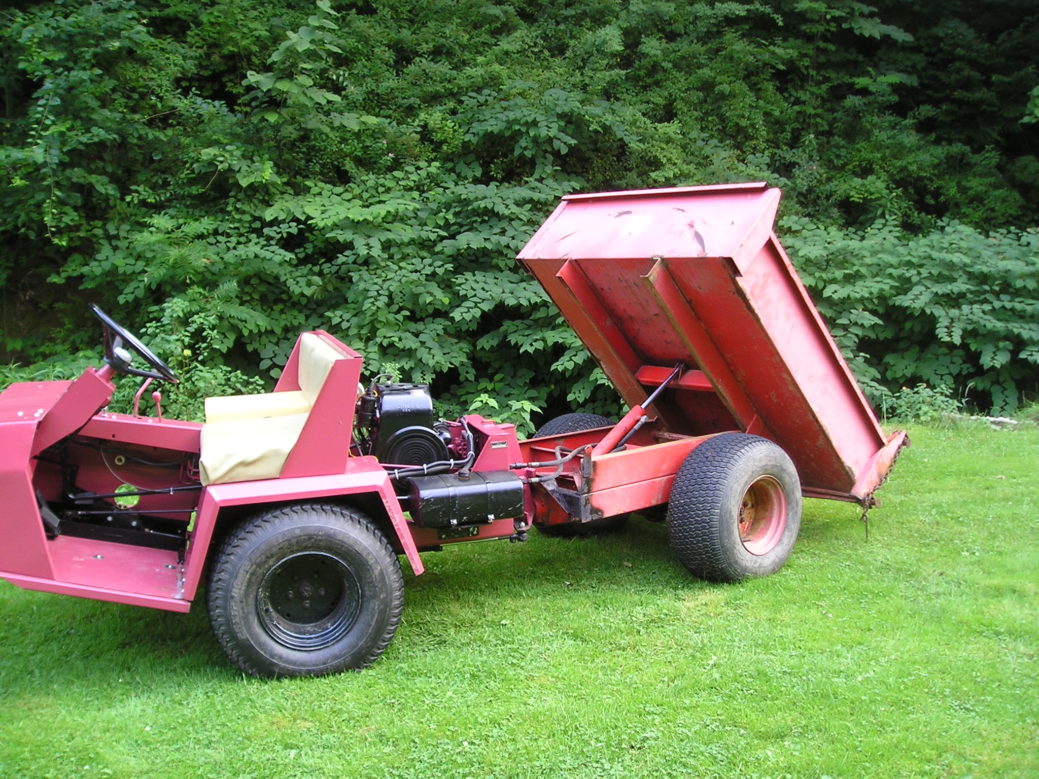

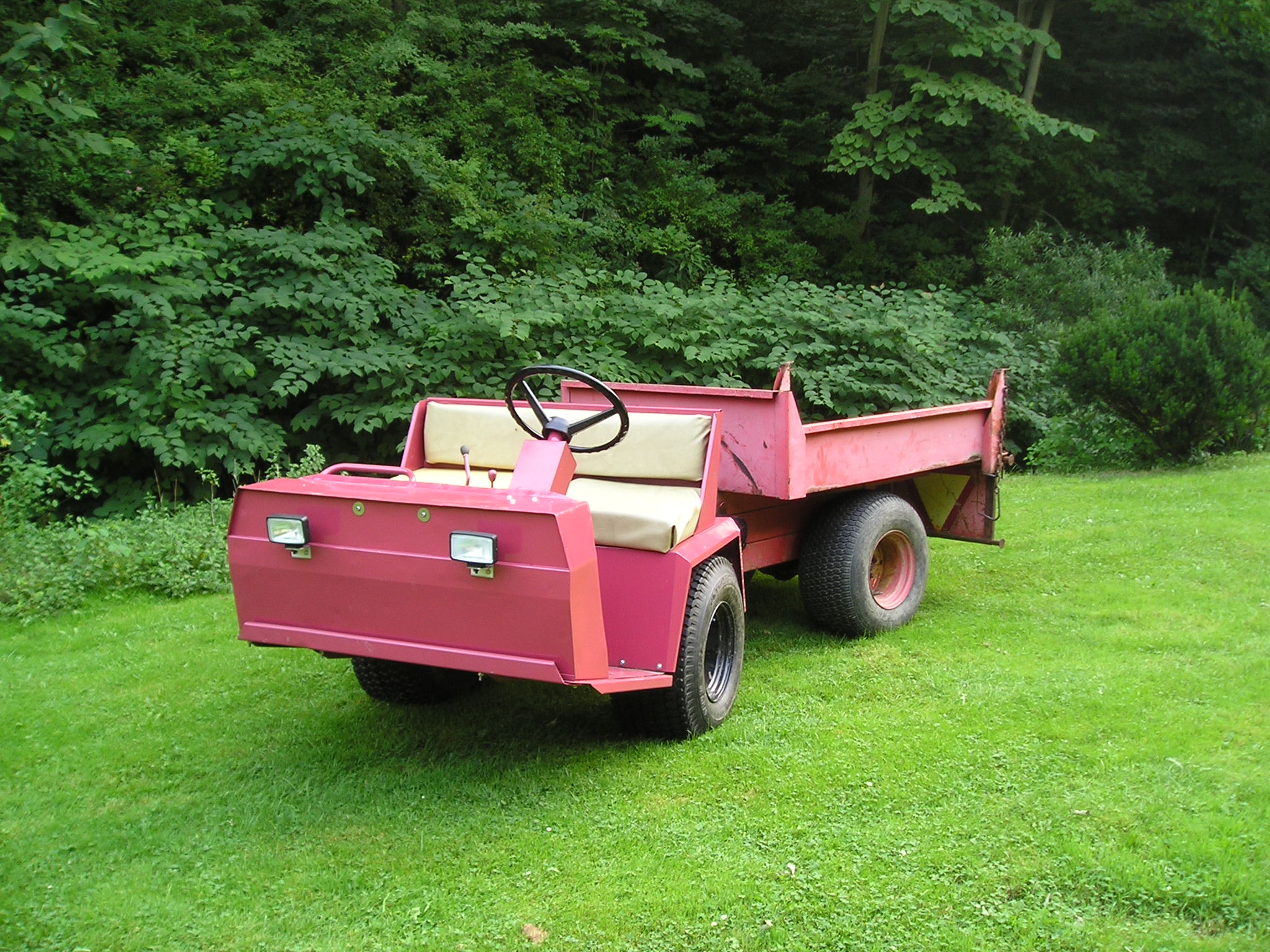

2deeskip said:
As requested I am posting photos
Interesting unit!! What do you use it for? How old is it? Does it go in snow?
PS: For future reference:
It is best to 'Crop' your pictures to just show the relevant object, such as the tractor, and eliminate background, such as the lawn and the woods. Then 'Resize' the picture to no more than 800 wide and 200 KB.
In this case, I easily edited your picture to 800 x 441 and only 92.7 KB, making it easier to view and much faster to download.
