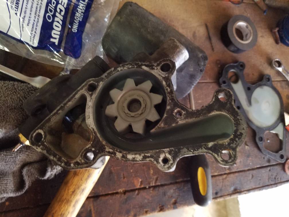

I would. Not sure what the pump looks like but if there was an opportunity for internal leaks then the pump just cavitayes and doesn't pump. You need to pull the thermostat to flush the block.
/ 4200 engine rebuild #42
How many hours on the tractor?
/ 4200 engine rebuild #44
17000 or 1700? Either way I would replace it. You can try to put the plate back on and seal with rtv.
/ 4200 engine rebuild #47
How long have you had the tractor? How many of the 17000 hrs did you put on?
/ 4200 engine rebuild #49
Then I would replace it. For $200 it's worth it.
/ 4200 engine rebuild #51
Do you drive that thing to work? Lots of hours. With that many hrs i would double check for air bubbles and flush it good.

I still say a good flush and replace the pump.

When I rebuilt my engine I took the radiator off and took it to a local radiator shop . They flushed it , dipped it and cleaned the outside. Repainted and pressure tested it for last than a 100 dollars. Well worth the money. Also easier to work on the water pump with it removed.
/ 4200 engine rebuild #58
If you are sure that the temp gauge/sender is working correctly (confirm with IR temp gun on t-stat housing), the water pump is spinning, coolant is moving, and there are no bubbles in the radiator cap, cooling system isn't clogged, and it isn't being overloaded, then it isn't going to overheat. One of those must be the issue.
Pull the t-stat housing and lower hoses and blast it with a garden hose in and out of everywhere, make sure everything is open. 17,000 hours is a lot, possible that the trans or a hydro pump has an issue and is overloading the engine?
