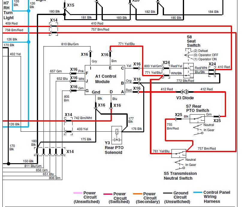

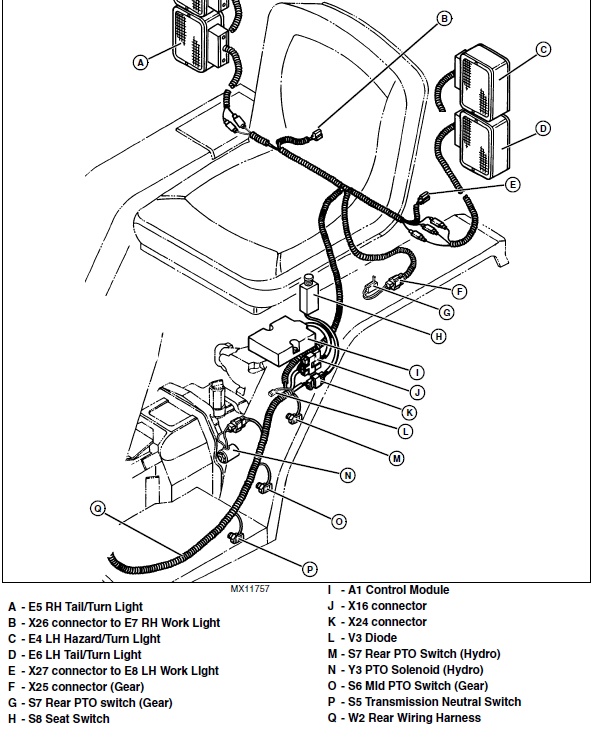

Hi folks, hope you all are doing well. I was pushing some brush around today and when I put my 4110 into neutral and got off the tractor it stopped as though it were in gear, got back on and turned the key and got nothing. I think it is getting the signal that it's in gear,but I don't see any switch by the shifter. The only wiring I see is a sensor above were the shifter goes into the transmission. Any one know where this switch is?

Not sure, but it is likely a stick poked up from underneath and pulled the wire off. I'd climb underneath and look for a loose wire.

Hi fellas, I read a similar post that sounds just like my problem . Thanks to beenthere for posting a page from the service manual that shows the location of the neutral safety switch.
/ 4110 won,t start ...Gear selector switch? #4
This one?
This one?
Yep, That's it. I'll crawl around under it the first chance I get and see what I can come up with. It was raining here most of the evening.
