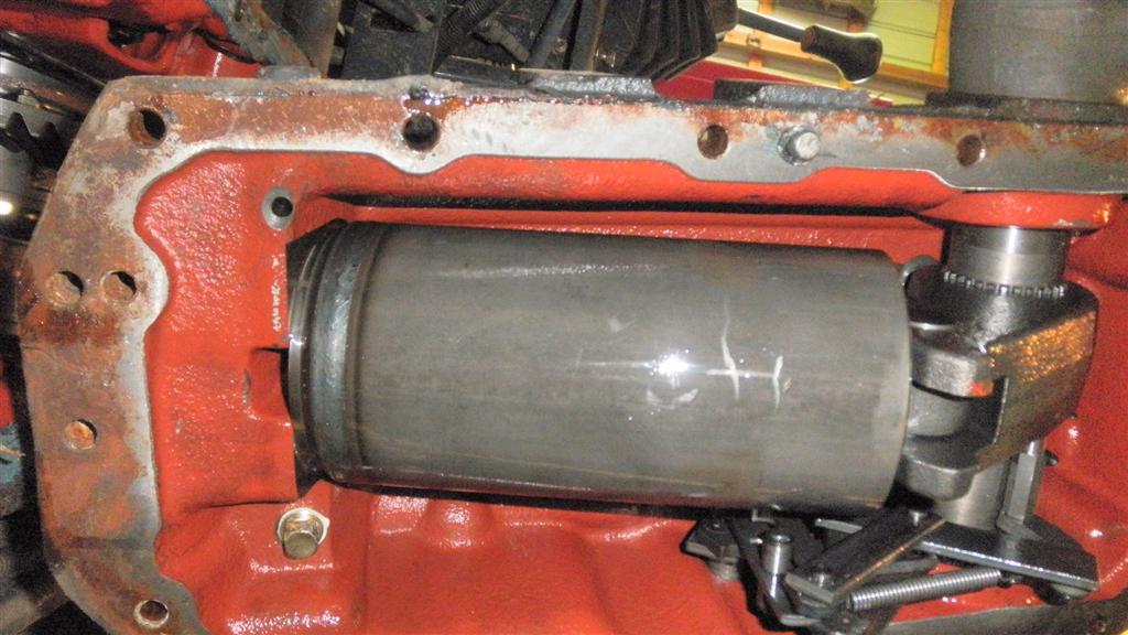

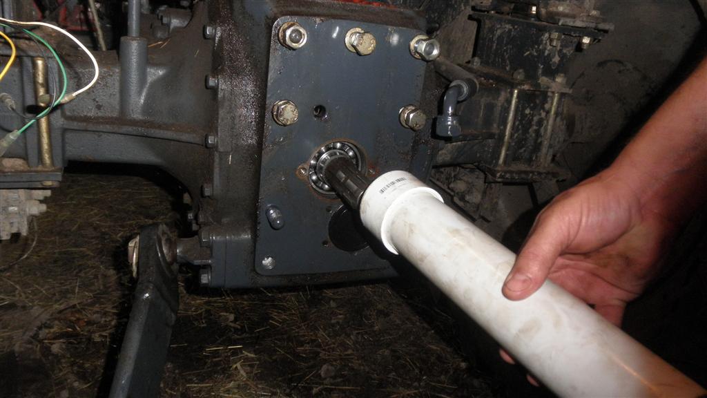

A 2" pvc coupling and short section of pipe made a great tool for tapping in the PTO shaft. I do not have pics tonight but I also installed the gear shifter fork.
BTW - I found the spring and ball for the shifter fork in the oil when I scooped and soaked up the last of the oiul from that chamber. They must have dropped there when the shaft came out of the fork. I made a tool from 1/4" round stock to compress the spring while I reinstalled the cotter pin behind the spring.
It is descision time now. The mechanism needs some modifications to prevent a repeat.
options:
1. Keep both 540 and 1000 rpm functional. I need to move guide shaft for gear shifter fork forward to get better engagement. this will require a spacer behind the top link mount to prevent the shaft from later shifting back to original position becuase the set screw at the front of the shaft has proven inadequate, not only in the failure but also tonight while I attempted to set it up in the original configuration. Also need to address the fact that there simply does not seem to be enough vertical stoke in the the selector to securely seat the shifter into the 540 rpm detent. I took the shifter off the tractor tonight after putting the shafts and gears back in.
2. Dissable 1000 rpm. I would probably with 1/2" pipe spacers over the guide shaft for the shifter fork. not easiler reversible, but it is reversible.

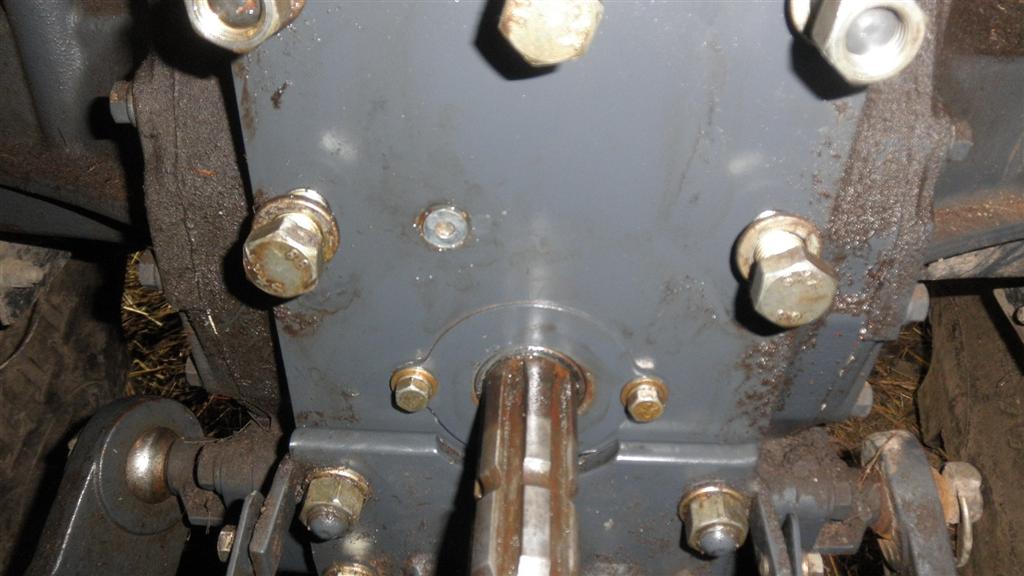

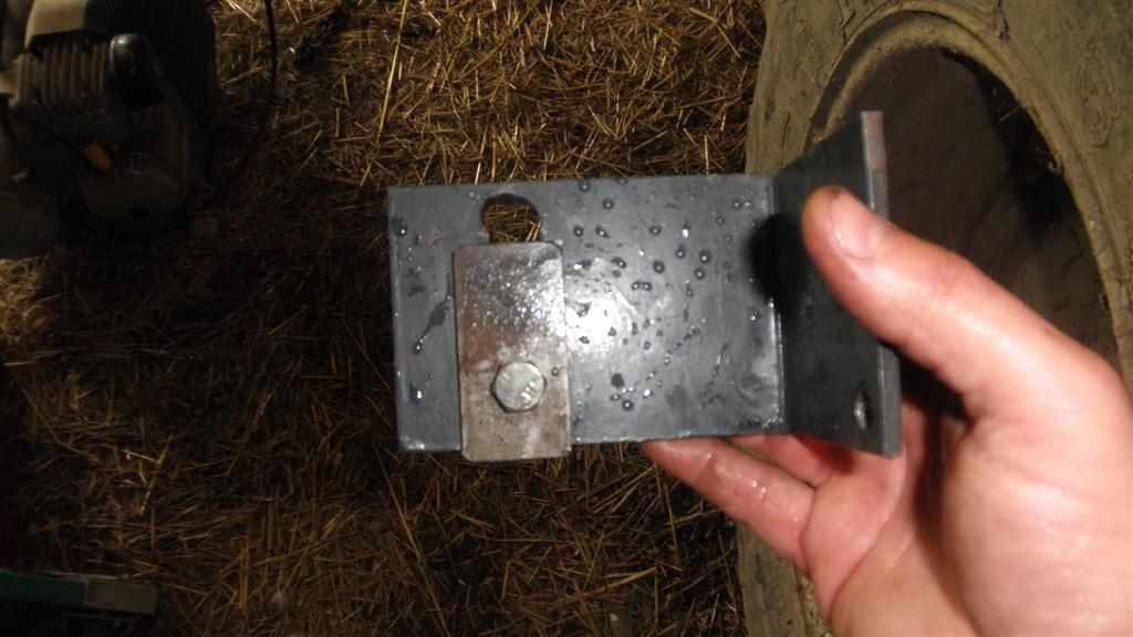

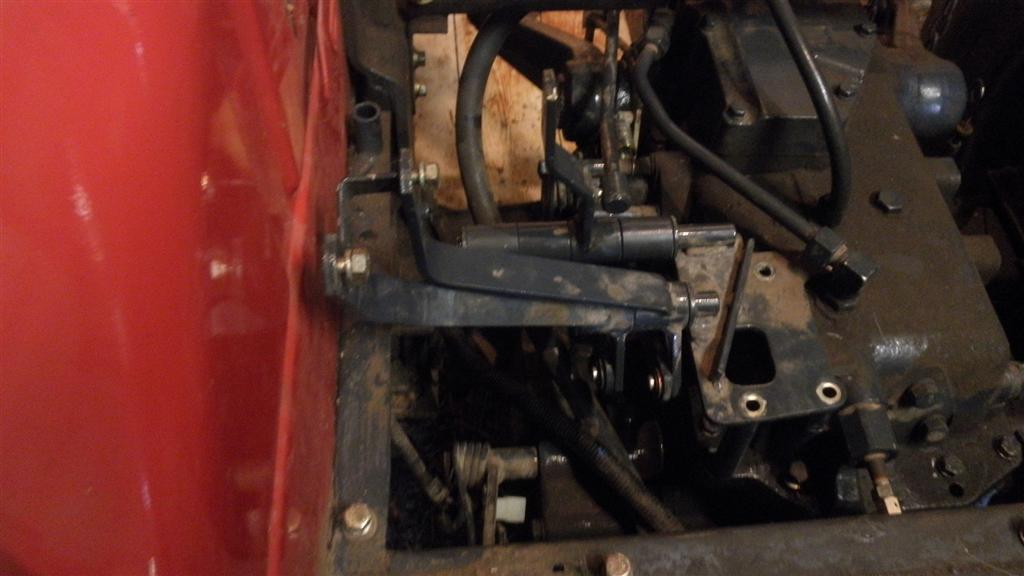

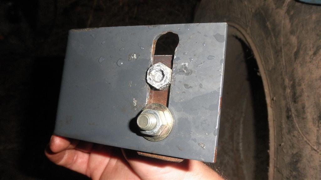

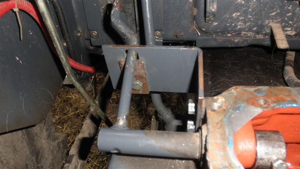

Modifications to improve location of shifting detents and a modification to limit the machine to 540 were completed Friday.
1. In the first picture the drilled dimple in the shifting shaft (upper left corner of tranny case as seen in photo) was deepened to around 1/4" deep and then reinstalled.
2. Second picture is back side of bolted in blocking plate to keep it in 540.
3. Third picture shows front side of same bracket
4. Fourth picture is the bracket with blocking plate installed (as seen from back of tractor). Note the shifter extension that goes out into operator platform is left off.
5. The last picture shows the washer I used as a spacer to hold the shifting fork guide shaft slightly forward.

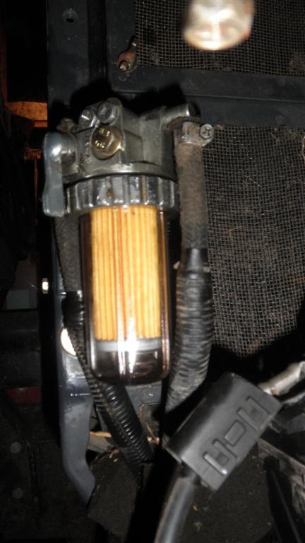

It looks like i got every once of life out of that fuel filter. this was one of the small jobs tonight. I am going to get alot of long overdue maintenance done while I am motivated.

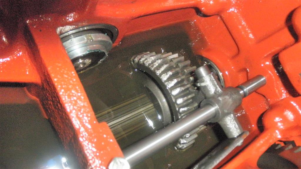

I had a look at Windyacres tractor with the top cover off and I see where the detent slots in the fork slider rod are not spaced correctly to let the upper and lower 540 gears mesh together fully, actually only about half.
