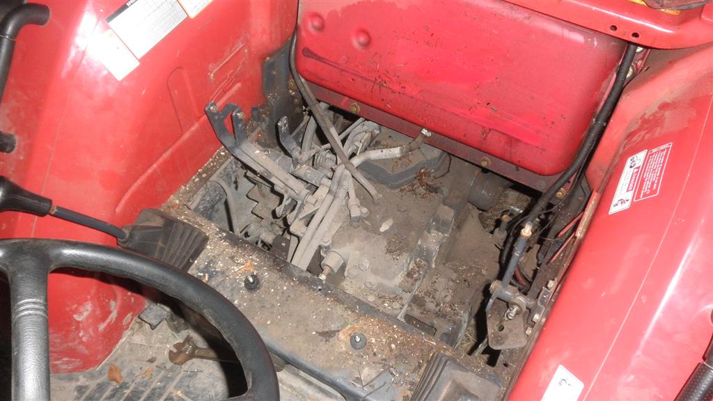

My PTO on my 4110 will not run in 540. it will run in the 1000rpm setting.
When I start the pto in 540, the selector lever jumps a couple times and drops out to neutral. Holding it engaged gives me the distinct impression that the gears have been damaged. I suspect someone stepped on the lever and forced it out of 540 while it was parked in the barn. Given that it runs smoothly in 1000rpm, I suspect that either i am dealing with two completely seperate pairs of gears or that the common gear is undamaged.
Has anyone had the tranny apart for anything?
Can I get into what I need to see by pulling the seat and body panels, then a top cover?
/ 4110 pto speed selector
#2
Removed the seat, the various levers and a little sheet metal. Getting close to finding out how bad it is.

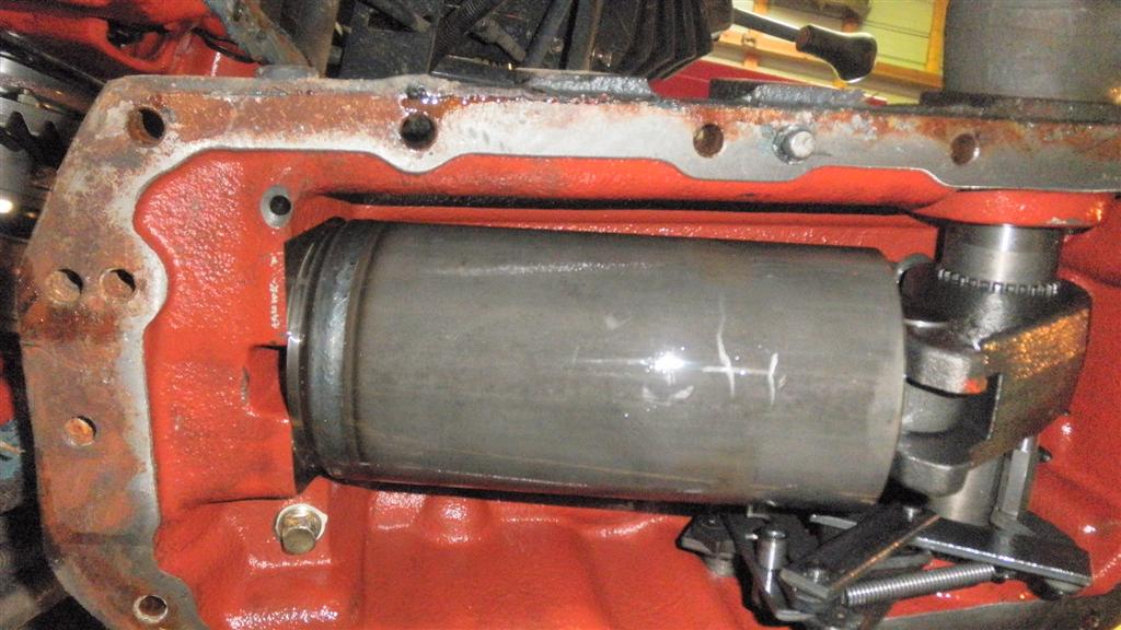

Rockshaft assembly looks good. Both the gear on the upper shaft and the one on the PTO shaft below it are shot. I found plenty of metal filings in the bottom. Looks like some linkage components inside the transmision slipped out of adjustment where only a setscrew holds it. The shifting fork doesn't seem to move the gear all the way into the detent in the guide shaft. The operator lever hits the sheet metal before it can pull into position all they way.

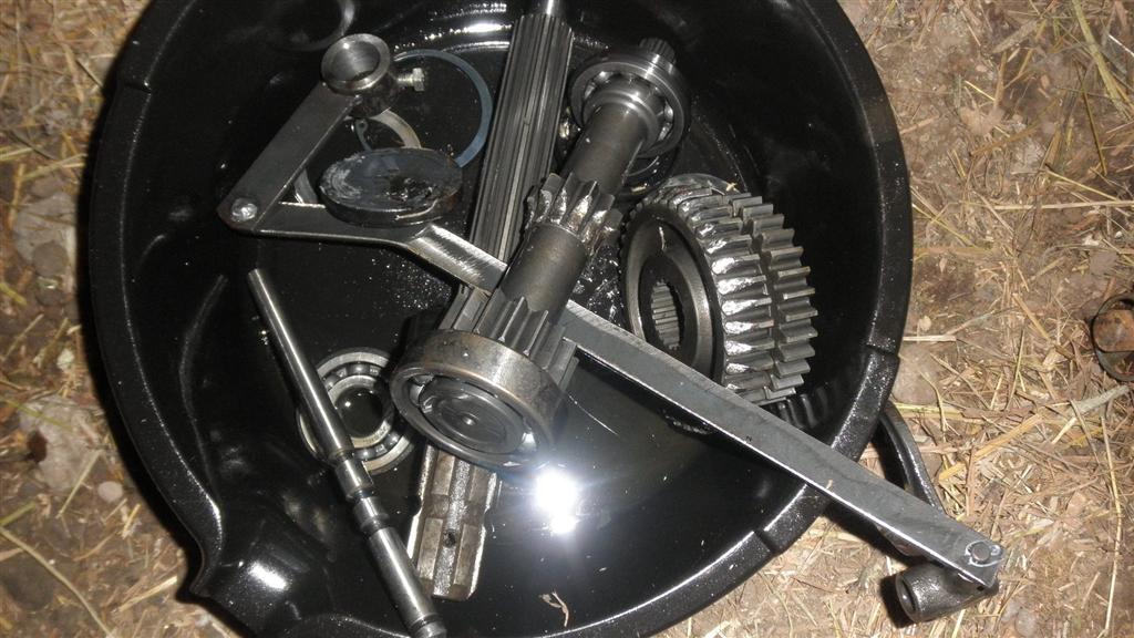

Step 24. loosen bolt (setscew) on PTO shifting linkage and pull that linkage off the shaft
Step 25: loosen bolt on shift fork guid bar and drive the bar backward out of transmission housing

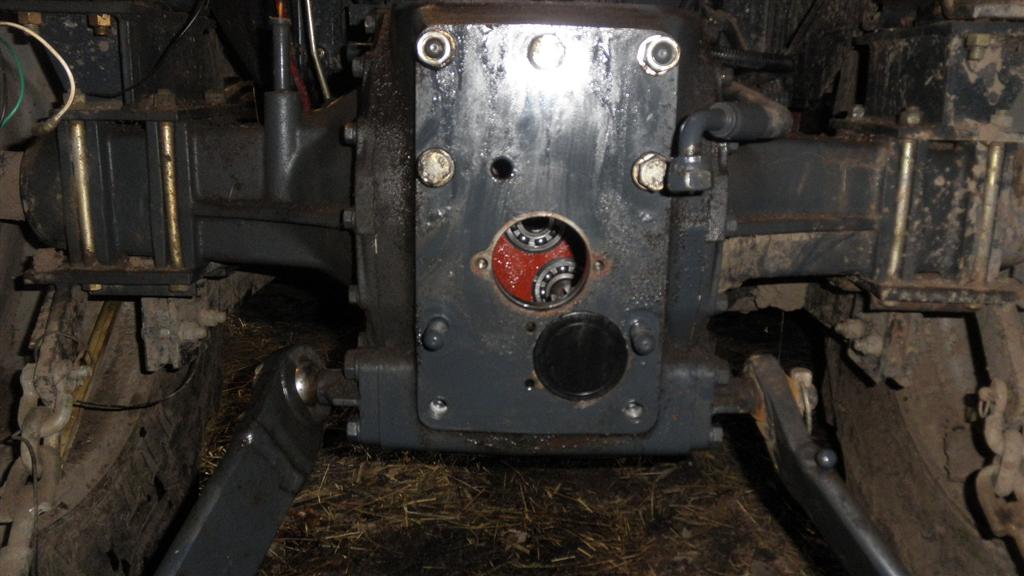

Step 26: remove bolts from retaining plate around pto shaft at rear of tractor. pull the plate off. pull out the seall under it.
Step 27: remove snap ring that is exposed now that you have removed the seal. pull / drive shaft rearward out of tractor. rear bearing comes out easily. Front bearing can be tapped forward off shaft after it is dislodged from its socket .
#15
Step 28: Remove fixed drawbar . this exposes the rear end of the drive shaft.
Tap the drive shaft out of the back of the tractor.
Dissasembly is complete!!!!!

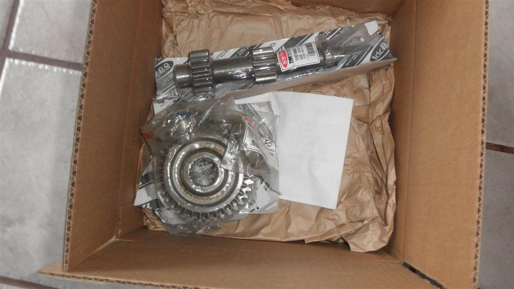

Parts came in! Still waiting on filters, but I can move forward with this

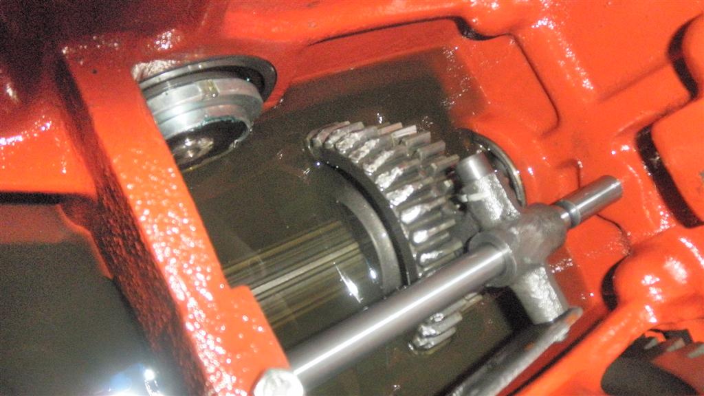

drive shaft assembly went pretty well. Big bearing went on easy, but I needed to get to a press to install the small one. The assembly slid in prtty easy, I supported the mating shaft with a nylon sling while lining them up. after the shaft was in place, I tapped the seal /cover in and bolted on the drawbar.
