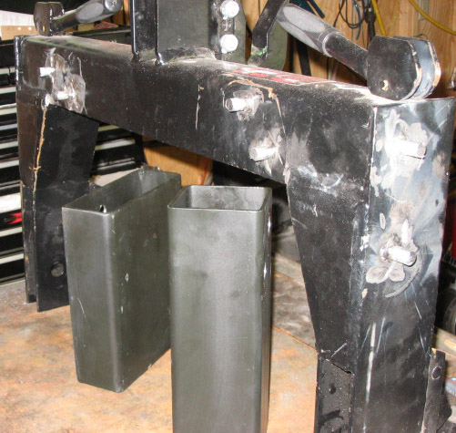

Finally got around to these. Here's the finished product. Wound up attaching them to the Speedco. Spent 4 hours skidding trees today. Box location was pretty handy to stage chains. More details with 2nd picture.

Here's the welding table shot. Used 1/2 inch threaded rod. I carry a 16' 5/16, 16' 1/4 and 8' 1/4 chain. 4x4s bolted to the PTO side of hitch have a few inches clearance when hitch is fully raised. Also enough space for PTO shaft. JD green paint courtesy of Fleet Farm (or is it Farm & Fleet???)

Forgot to include box dimensions. Square ones are 4x4 od, 12 inches long. Rectangular side boxes are 8 x 3 by 10 inches long. Square ones easily hold the ¼ 16foot chain, rectangular ones just hold the 5/16 16 footer. There’s space for 2 ½ inches longer side boxes. I scrounged a piece of 8x6 box steel and cut in half (and welded on a back) to make the rectangular ones----it happened to be 10 inches long. Attaching holes were drilled at 5/8s so my welds could be a bit sloppy.
