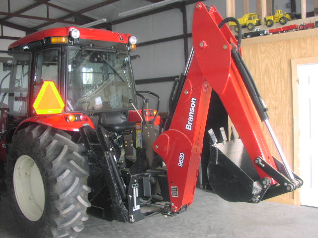

Good evening,
Still battling my last question but I have a new one. Will your stabilizer arms on backhoe lift the back of machine off the ground, with loaded tires without assistance from pushing down the backhoe or anything.
I ask because mine won't and the dealer says that's probably ok. Engine revving or not, good fluid level. Haven't used it yet,
Thanks
Hans

My 6640C Branson will
