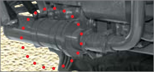

Is this similar to the hose you are talking about.(The suction hose from transmission screen before the pump)Or am I not understanding you correctly and it is a line from your aux valves.
As I am not familiar w/ the 35 series this is a pic from a 30 series and they very well may be completely different
If it is building presure in your transmission then I would think the tranny is not venting properly.(Plugged or frozen vent)
