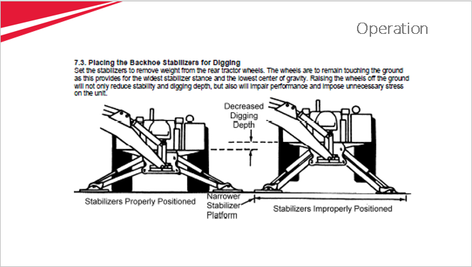

You're being dramatic. Taking the bulge out of the tires is hardly like the image on the right you showed. Read the caption. It says to take the weight off the wheels. I have never said To raise it way off the ground. Get the bulge out of the tires or just barely lift off the ground for maximum stability. If you don't, your risking the wheels actually bearing more weight than you think which leads to an unstable platform because the outriggers which are designed to hold the weight aren't. I've never had someone argue over something so trivial. I would venture to guess most people don't out enough on the outriggers and that's why they have such a wild ride.
Take the bulge out of the tire or where you can slide a piece of paper under it is all that he needed.

That's a Bradco unit on his tractor.
Directly from the Bradco manual..
.."Once the unit is positioned, lower the stabilizers to the ground. The tires should still
be supporting most of the vehicle weight with the stabilizers relieving only part of the weight
and mainly acting to give the unit a wider base for increased stability and to keep the unit from
moving or bouncing with backhoe use."
Or are you saying you know more than the Manufacturer?

Those instructions were clearly written by a lawyer. A couple things to keep in mind when reading those instructions.....first, the manufacturer will always say to operate as conservatively as possible to help them avoid excessive warranty claims. Second, often times these backhoes are designed by a third party for use across multiple platforms. They are attachments, and can be exposed to a wide array of operating conditions. Picking the back of the machine up on a 3 point hitch backhoe, for example, might not be recommended. A subframe should be significantly more capable.
Bringing the wheels off the ground will not significantly change the digging depth or stability.....nor will it increase stress in the area that the OP frame was broken. If anything, lifting the tires would reduce stress in that area when applying force under a tree root or stump.
I pick up the back of my machine all the time. Often times that's required to get the back end level if it's not on a perfectly flat surface. If it breaks, I'll weld it back together and make it stronger. I bought my equipment to use, and I will use it to its capability. Every once in a while that means I need to improve a weak area in the original design.

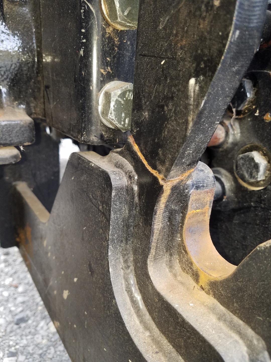

As I said earlier - if this was my backhoe I'd weld that back together, reinforce it so that it doesn't happen again, and go back to using it without overthinking things.

Your cars owners manual also says to obey all local and state laws. Do you ever speed or not use your turn signal in the distance frame required by law? Your tractor states to always have the rops up and seatbelt on. Can you honestly say you’ve done that 100% of the time? Are you smarter than the engineer or lawyer?
If you have ever been around heavy equipment or anything that uses outrigger you’d know what gives the most stability. If you use the manual as gospel than good luck. I was giving real life advice on operating equipment. Most on here have very little true experience or this is their first piece of equipment.
This subject has been beat to death and I’m exhausted going back and forth. If you don’t understand what I’m saying you will never get it. This isn’t rocket science or really a complex issue. It’s common sense which obviously isn’t as common as it once was.
