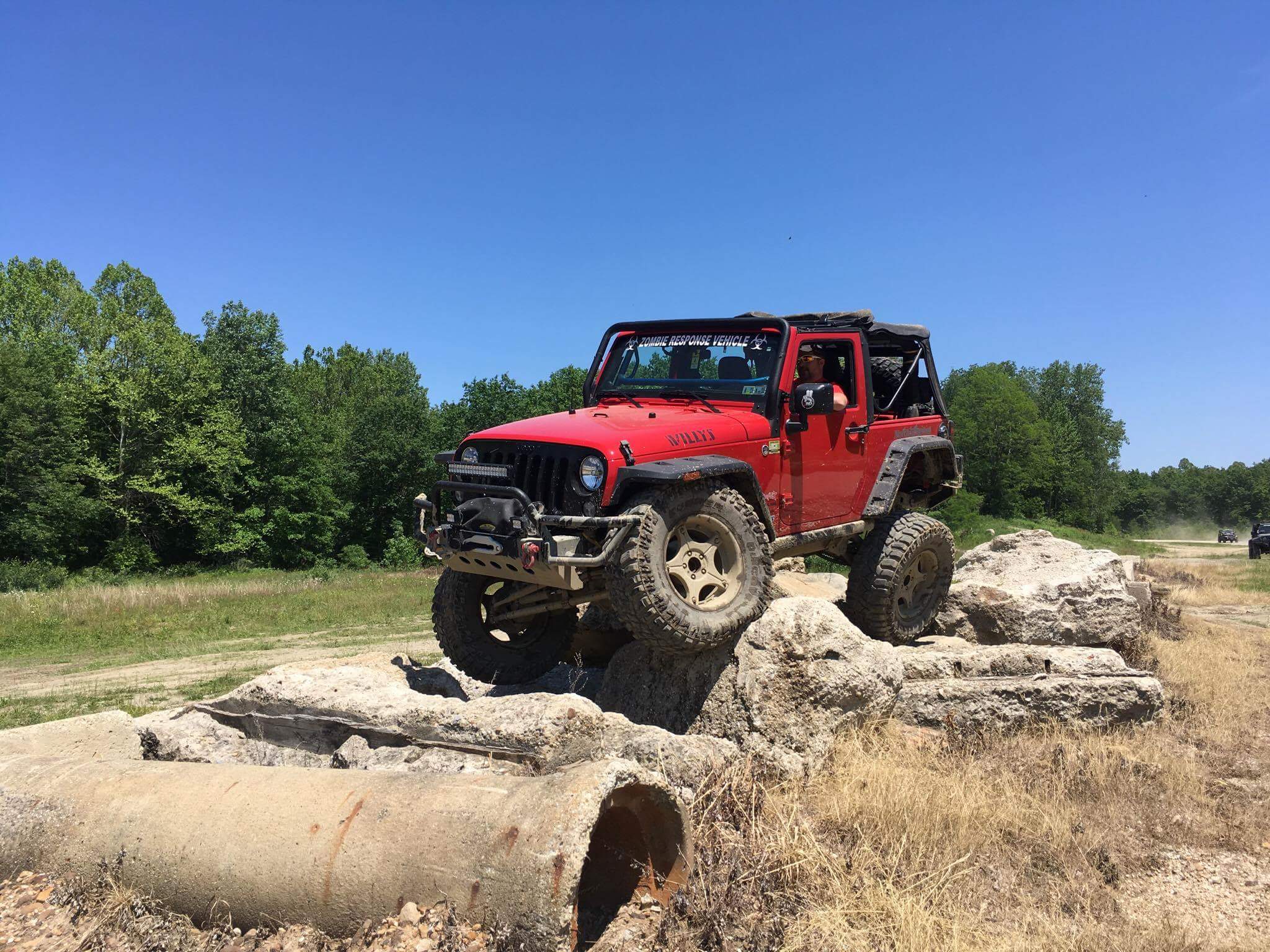

I look at the manufacturers safety type blurbs the same on my tractor as on my Jeep wrangler. If you offroad your "trail rated" Jeep Wrangler and mark up the bottom, you stand a REALLY good chance of warranty denial from top to bottom. But, I bought it to do a job... entertain the heck out of me while I beat that thing into a pile of twisted steel! I bought the tractor to do certain things as well. If it ends up beat into a pile of twisted steel along the way, so be it. Both a tractor manufacturer and Jeep will void the heck out of your warranty if they can prove that used the machine in a way not afforded to you by the terms of the warranty. So use your junk at your own risk :) I beat the dog-snot out of my new Jeep, but the warranty is in the tool boxes in my garages. I do not go to Jeep for anything. I do things to it that are specifically not allowed per the words of FIAT/Chrysler/Jeep. Screw them.
Those types of warnings/statements are liability related from the manufactures point of view. Like you or another said recently within this thread, it also allows them to put limits on what would be covered by warranty. I hate warranty repairs... you die of old age waiting for some shop to diagnose, get approval, order parts and finally do the repair. This can be a week, 2 weeks or maybe more. I can fabricate, build or repair an awful lot of in just a day or two. I do not have the patience to wait in line for warranty repairs.
Luckily for me, I do my own repairs on just about everything I own and what most people I know own. I also don't trust the average mechanic to touch my stuff. Some mechanics are exceptional and I have met a few, but there are a mess of them out there that are dumber than a bag of hammers.
If I tore the outriggers off, I would weld up bigger/better/badder ones. I have a welder/lathe/plasma table/mill and I am not afraid to use them.

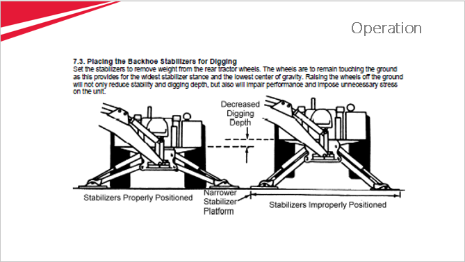

So, the manufacturer puts a specific requirement in instructions, which according to some here make the unit MORE unstable. Which would mean the manufacturer would be MORE liable for any mishap using their instructions? That makes sense to some of you here? All I can do is shake my head in wonderment.
Rock crawler. Point being that if you roll that wrangler off the rocks and crush your skull, make sure your family doesn't file a lawsuit against FCA.

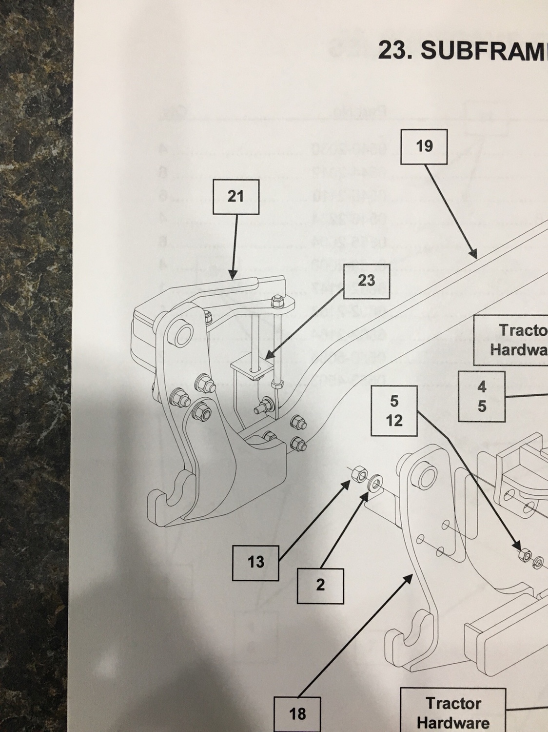

Not sure how this happened, but the subframe has sheared in 2 places just above the lower mounts. Is this frame cast iron? Is this reparable, or am i looking at a new subframe. Tractor has 70 hrs on it, and very little backhoe use.
The set up on my 2538 is similar but the bracket that the backhoe seats into looks like it could be removed with 6-8 bolts. It is all mounted to the subframe. It doesn't look to be anywhere close to a $1000 part per side. Part 21 on mine, Top Plate Assembly RH or LH.
They don’t want increased warranty claims because they build a product not up for use as advertised. If it’s not strong enough to work while supporting the tractors weight then I have zero use for it. It’s typical CYA by business that are reducing quality to increase revenue.
Anyone that has actually run construction equipment knows the difference between the outriggers supporting the machine vs the tires and the outrigger having ground contact. My statement all along and I’ll do it in caps for ease of reading is the following
THE MOST STABLE PLATFORM WHEN OPERATING EQUIPMENT IS WHEN THE BULDGE IS REMOVED FROM THE TIRES. How anyone can argue that is beyond me. That is a basic fact with backhoes. Lord forbid you ever get off your tractor with the PTO engaged. It’s a miracle you haven’t been sucked into the shaft and sued the manufacturer....or you have and that’s the reason your the way you are. If that’s the case, thanks for all the warning stickers on m stuff
For those that go by the owners manual as gospel....don’t think for yourself, follow your instruction booklet blindly for your own safety.

I have been doing some reading of deeres literature. On some of the units they are calling the arms that contact the ground stabilizers. They specifically said they were not outriggers. That lends me to believe they aren’t of the same build quality to be considered as a traditional outrigger. That is a shame. If I rented one of these little units, I would operate it as I always have but will concede you should follow the manufacturer recommendations to CYA. I’m genuinely disappointed that they are passing off these products while charging a ton of money for them. I will never recommend anyone buy a TLB and instead use the money and rent a track hoe when needed.
Using the tires for stability isn’t a safe practice in the world I work in. Tires can fail and leave you with an unstable situation immediately.

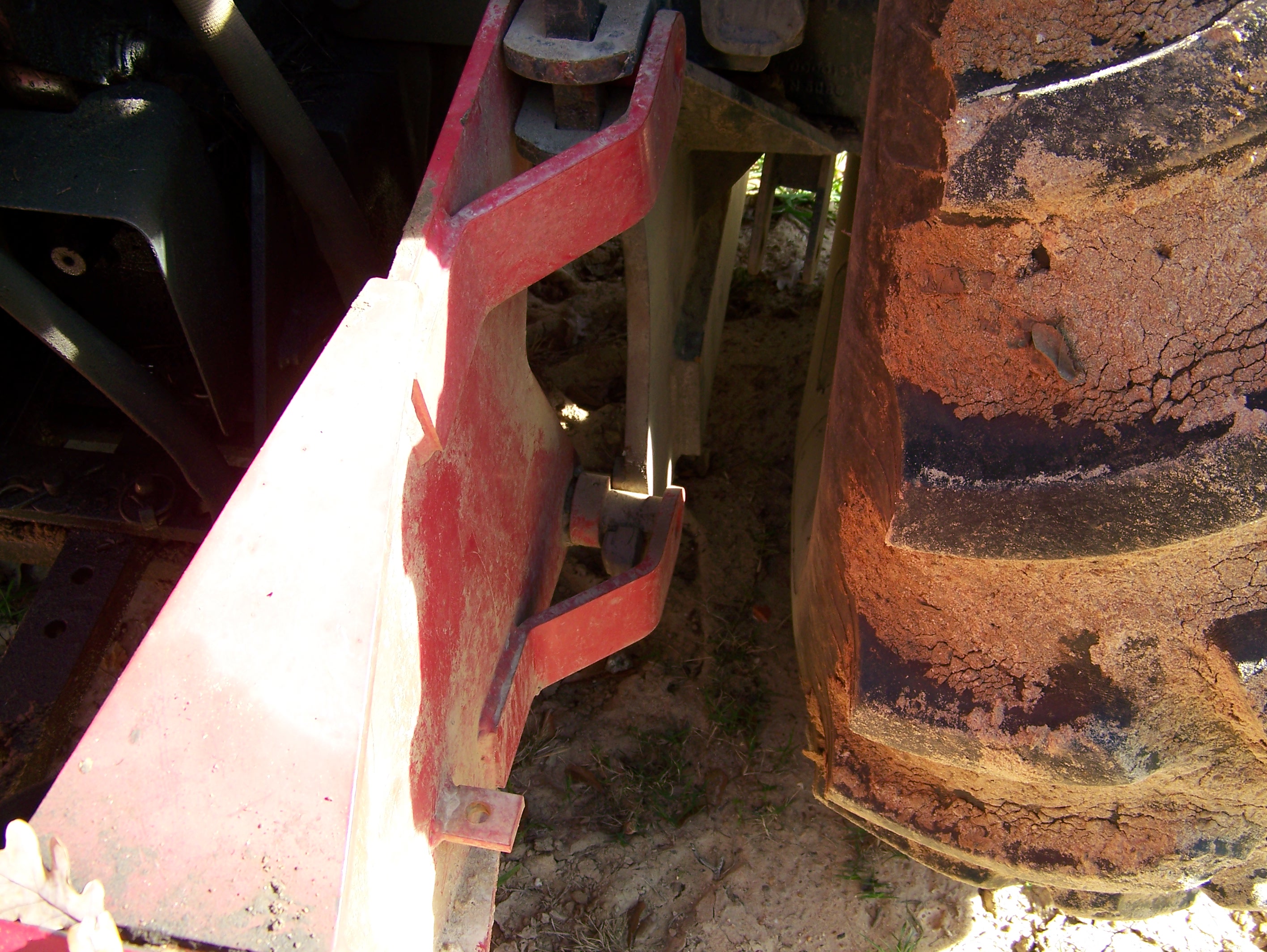

I have over 1200 hours on my 6520 and lots of that time was using my Bradco/Mahindra 511 (same hoe and subframe as 509 but with longer cylinders ) backhoe. If I just put a little weight on the outriggers, the hoe can pull the tractor. I put the whole weight of the rear of the tractor on the outriggers to keep from sliding. Lots of times I need to raise a wheel to make it all level. Both wheels are raised to walk it. I can't see tire bulge while hoeing, it is all by feel and seat of the pants experience
Of course my subframe is an inch thick with the added "J" collar at the mount for over 1.5 inches of bearing surface (per side) for the backhoe to sit on. Walking a backhoe puts stress on the upper mount. Continually digging against unmovable roots puts stress on the lower mounts.
The OP's lower mount is the same design as my lower subframe mount is. I think it was just a bad weld that concentrated the stress at the cracked place. I have found the more surface area you have on the ground while digging is better, with all the weight you can manage on the stabilizers. Just dig with your loader bucket raised to see the difference.
In the attached photo you can see how the lower mount just rests on the subframe and how much extra "meat" is below the mount on my subframe. I don't think it has that much metal below the op's cracked subframe.511 Lower Subframe Mount Meat Below Mount.jpg511 Lower Subframe Mount.jpg
I am sure about how that happened ..... It just happened to me, same tractor, same BH, same break ....
1 or more of the bolts on the top back mounting plate for the subframe loosened .... This allowed inordinate stresses on the subframe where the BH mounts.
Hopefully I can get the subframe welded this week.
On a lighter note, I noticed a strange creaking / popping noise so I started to take the tractor back to the shop ....
After roughly 50 ft down the road, the backhoe just fell off my tractor onto the road ....
the looks on the faces on the two guys I was working with ---- priceless ....
