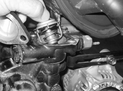

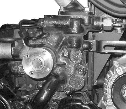

It's barely time for our fat, lazy newspaper lady to bring the paper by (promised by 6:30 vs. ALWAYS here by 5:30 when Wash Post was doing it); so, I copied a couple pictures. They're shown below, of the water pump and thermostat area.
I couldn't figure out how to capture the exploded parts views in the CD.

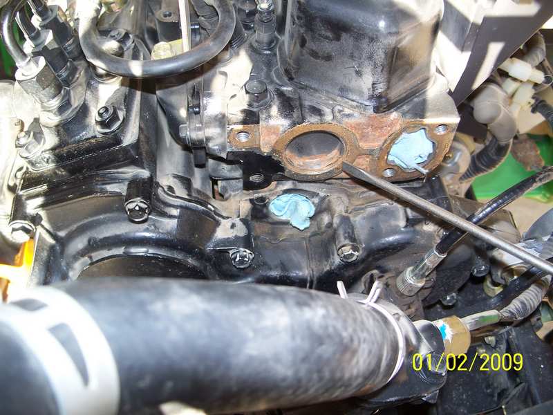

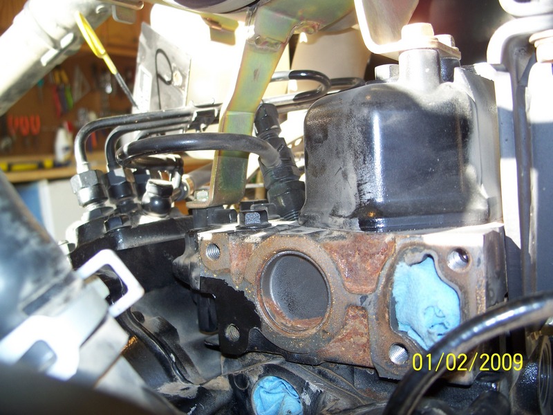

I think I found my problem. After removing the water pump it appears that the freeze plug (?) on the cylinder head next to the water intake is leaking. This plug is larger than the plugs on the cylinder block but don't know what else this would be. Anyone else have this problem?

Sounds like you may have found the problem but I wouldn't be surprised if it only appeared to be the freeze plug. The best way to be sure is to pressurize the system with equipment (probably you do not have) and see where the leak is.
I recently went thru exactly what you are going thru on a 4320 which was still under warranty. Being the type that trys to find/correct problems to avoid transporting back to dealer, I looked and looked and thought the problem was either around the water pump or hoses. I tightened all hose clamps to no avail and called dealer to fix. Dealer found there was a very slight leak in the radiator which only seeped under pressure when running and the fan sucked the coolant back into the front of the engine making it look like the leak was in the area of the water pump. It was found by pressurizing the cooling system w/o running the engine. So, a new radiator fixed the problem.

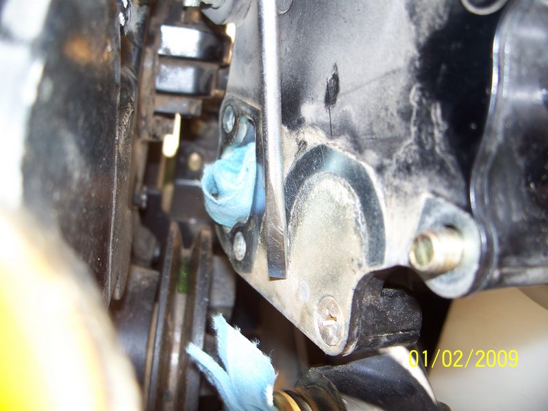

It doesn't appear that the back of the pump has a weephole. When I removed the pump the area where the screwdriver is in the pic was wet. I would have antifreeze that would leak out on both sides of my engine which also led me to believe that it was leaking out of this plug. It would drip on the block below which is sloped in both directions and would cause it to go to both sides of the engine as you can see in the last pic. The leaking doesn't occur while the engine is running. Fluid will show up in a couple of days.

If I compare the picture I posted from the CD with your picture, it appears that the water pump casing covers that freeze plug area. So, I'd think that any freeze plug (the one shown in your photo) leakage would not be to the outside.

Thanks RalphVa. The water pump does not completely cover the freeze plug, there is a portion of the bottom of the hole that sticks out below the water pump. After visiting with the dealer/mechanic this morning he seems to think that it is a bad head gasket. So much for trying to fix this myself. I'm going to put it back together again and let them fix it. I would hope that John Deere would step up to the plate and help with the repair cost since it's only got 154 hours on it and it's four years old. Might have to look at blue or red next time........
