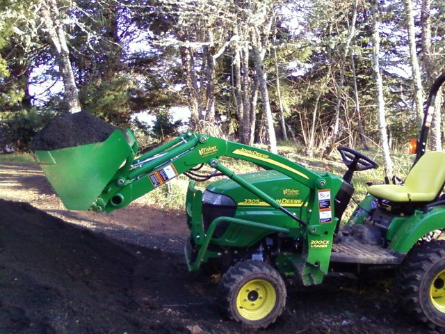

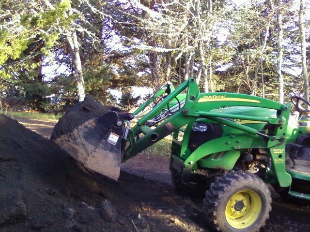

/ 400CX vs 400X #7
Do you have the CX and X reversed? Looking at that doc the rollback/dump angles are 43/45 degrees for the CX, and 32 and 46 for the X, so it seems a little better on the CX than the X.
The roll back angles are given at ground level. As I raise the cx, the angle stays the same. As some one without a self leveling raises theirs, the angle appears to increase. Some to the point that the bucket opening appears straight up. A heaped bucket with the cx will lose material. I will try to get a pix this afternoon and post it.

As promised, pict. Better late than never. Moot point for the original poster, but for others. The comparisons are not exact, but compare the edge of my 2305 with 200 cx with the 4520 with 400cx. Full loads of 3/8- crushed. All three pict full rolled back.

I think the capacity of the 4n1 is less than the standard bucket. And the length of the bottom of the bucket and the depth (length of the sides) is correspondingly less.
So, I'm wondering if the problem of "losing part of your heaped load" is not nearly as bad with a standard or HD bucket and the SL loader as it might be with the 4n1?
