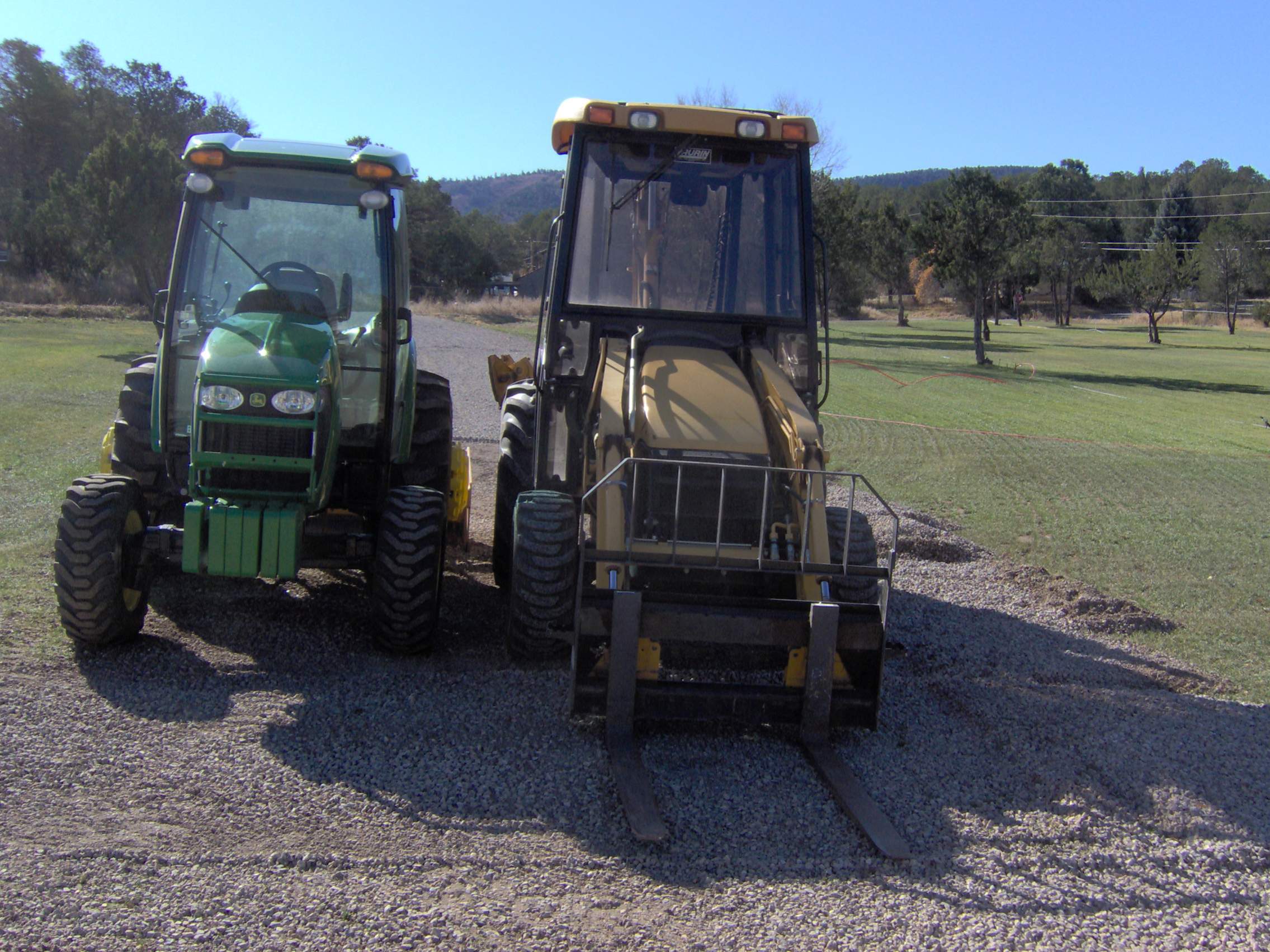

The 110tlb is quite a bit taller than the 4x20 cab tractors see picture. The 110 with cab or rops is the same height and wouldn't fold so you would likely need to park it outside. After eight years I am glad I went with a cab on the 110 and haven't broken any glass so far. I bought the 4520 cab in 2009 and the two work together very well for me.

I will get a measurement for you this evening, but I think its close to 15 feet.
/ 4000 Series Questions #8
I think a 4720 cab will go under a 10 ft opening with room to spare. Height to top of cab on my Kubota M7040 is 101"s which is 8.4 ft.
/ 4000 Series Questions #9
I measured about 14' 6" from the bucket to the draft links...a shade over 16 feet with the iMatch and ballast box. My open staion is about 8' 2" to the top of the ROPS. I recall that the cab model is actually a couple inches shorter than that. All my measurements could be off an inch or two.
/ 4000 Series Questions #10
I think you are pretty close on those numbers, I know my 4520 cab is very close to 8' tall.
