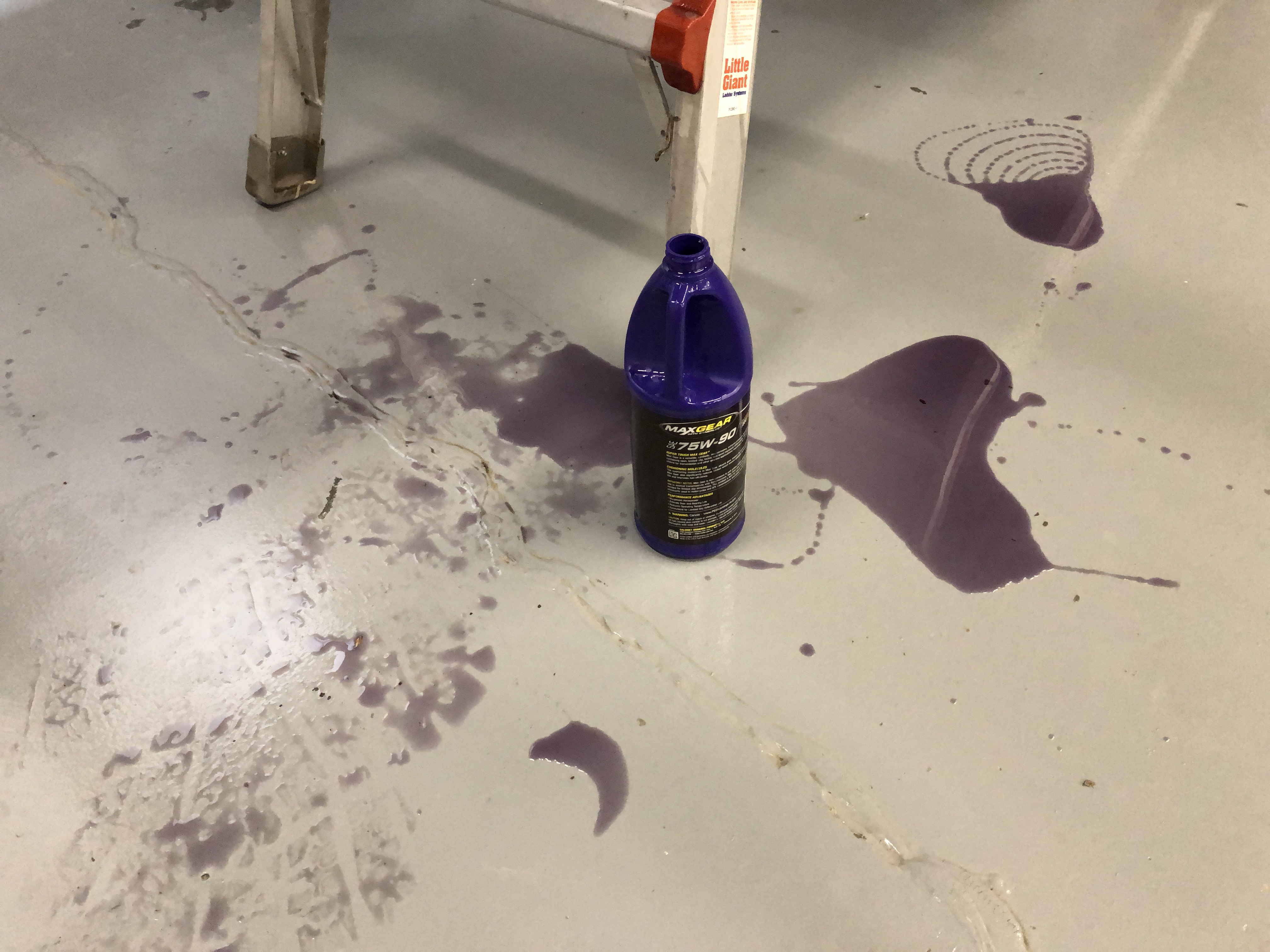

One final thought that might give you guys pause...this is what happened when I changed the fluid in my car's differential.
View attachment 679176View attachment 679176

Nothing a few rags can't clean up. And if you do it yourself, you know its done properly. The dealer (like mine) might even have a kit for you. I did my full service this spring and it wasn't bad.
