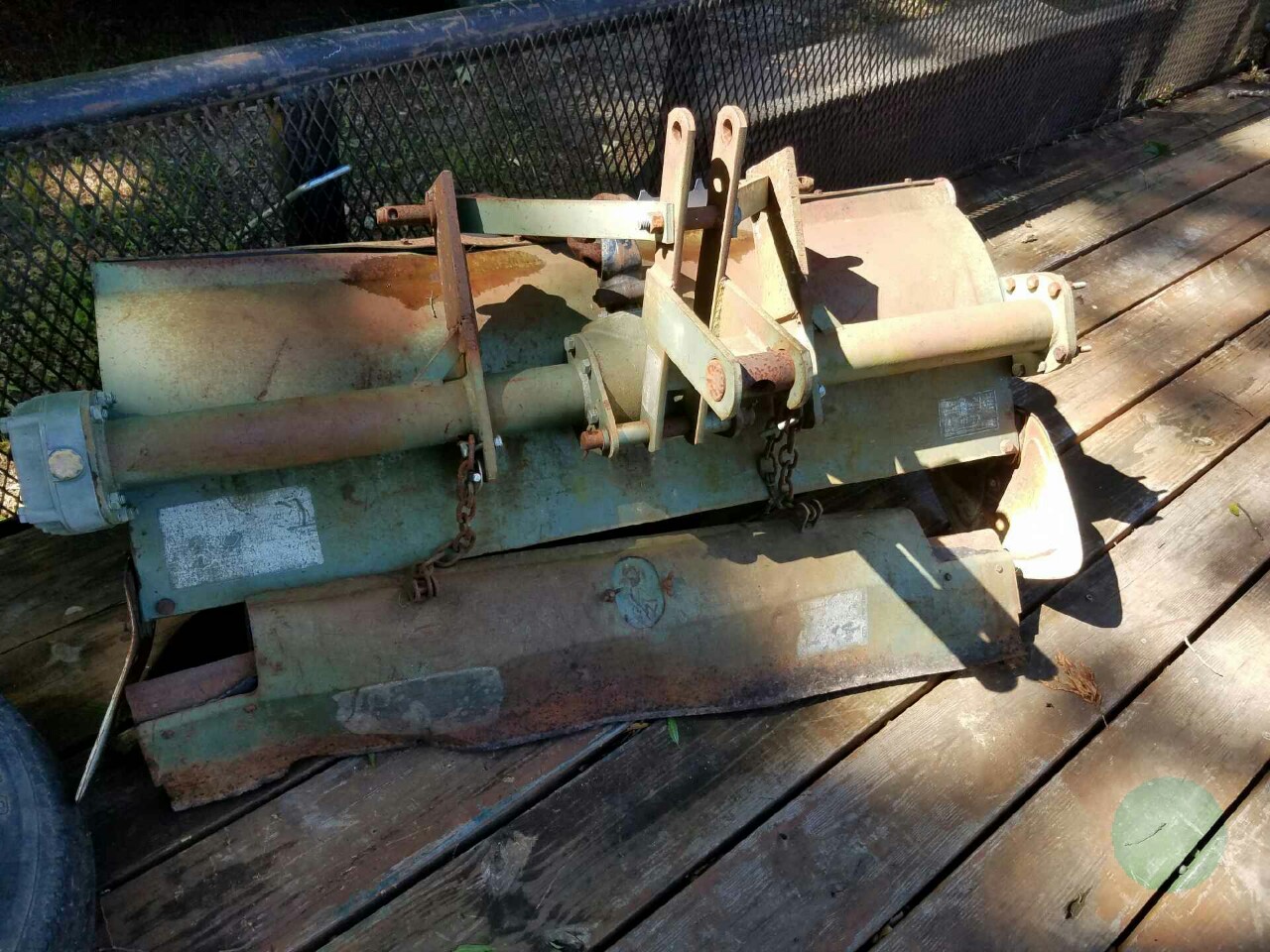

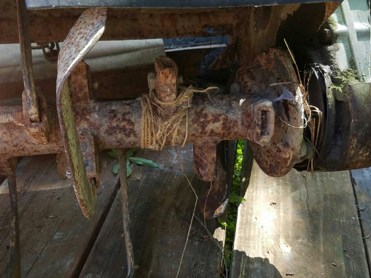

My buddies dad used it this yr. to do their garden. It needs 6 tines and some work, thinks it's either a Yanmar ys/rs 1200. Anyone know for sure? I can get it for $100, is it worth it ? thanx Jim

Should work! Looks like it either doesn't have the rear wheels or is not an option for that model. 100.00 bucks the Dr. Shaft worth half that.
/ 4' Tiller #3
$100? When anything else you will see is $500 and up, why not?
I wouldn't use that to earn a living but for typical homeowner use I would just change the 90 wt gear oil (There's always water in there) and put it in service. See if it really needs those missing tines, or does sufficient work without them, before spending more money on it.
These things are near bulletproof. There is one part you need to check, and replace if needed: at the dumb end of the tine shaft, there's a ball bearing that will chew up the housing if it has rusted in place. It's simple to check, and cheap to replace with a standard sealed bearing.
You will likely conclude it is worth buying a set of tines and restoring it. Aside from that bearing and worn tines it should run for years with little attention.
You only need wheels if your tractor is underpowered, say under 15 hp, relative to the tiller. I needed them to use my tiller intended for 20 hp on my 15 hp (pto) tractor because it would dig too deep and bog down, didn't need the wheels for the 20 hp tractor.
That was about the last model that had wheels, they aren't needed when the tiller is matched to the tractor's hp.

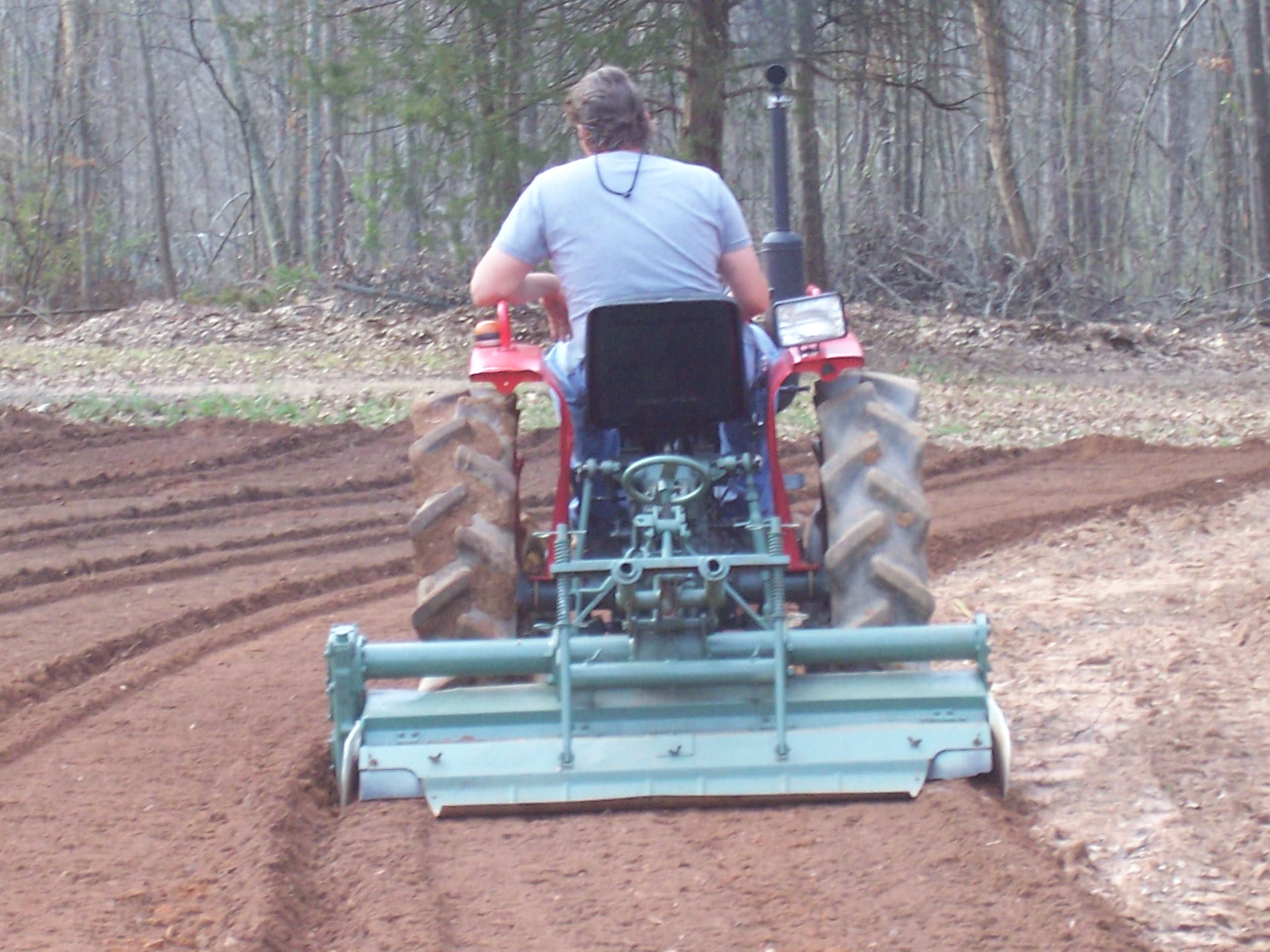

/ 4' Tiller #5
RS 1500 behind my YM2000. My mothers garden that's been tilled by a walk behind. I agree to go through a fix everything because IMO. your YM1700 won't have any problems with it. Notice no rear wheels either.

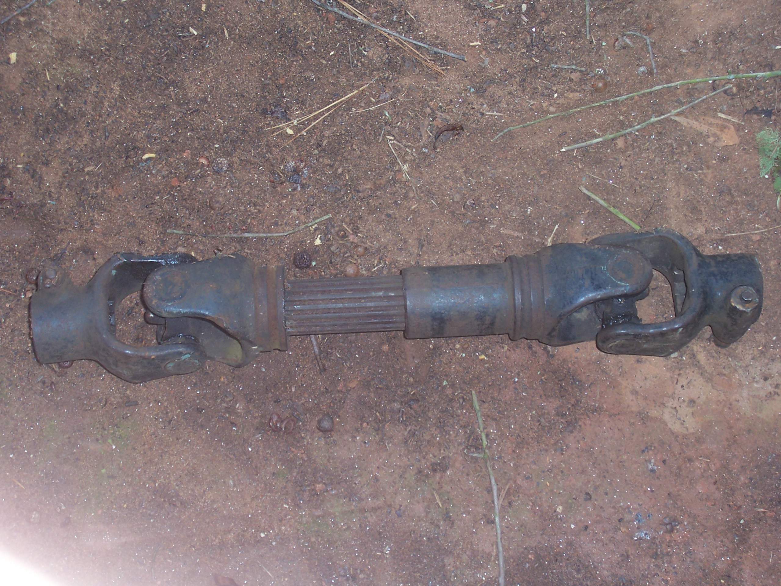

the PTO shaft is as old as the unit it looks like, and quick look there is no "shear bolt" let alone a slip clutch. you may need to get a new PTO shaft for tiller. if there is a belt on the side that can serve as a saftey device. if it is chain then look at PTO shaft with a shear bolt.
double check you do not need a new PTO shaft. different tractors can result in longer and/or shorter PTO shaft. a couple inches is a couple inches when dropped down into dirt and PTO shaft coming apart on you in a dangerous way.

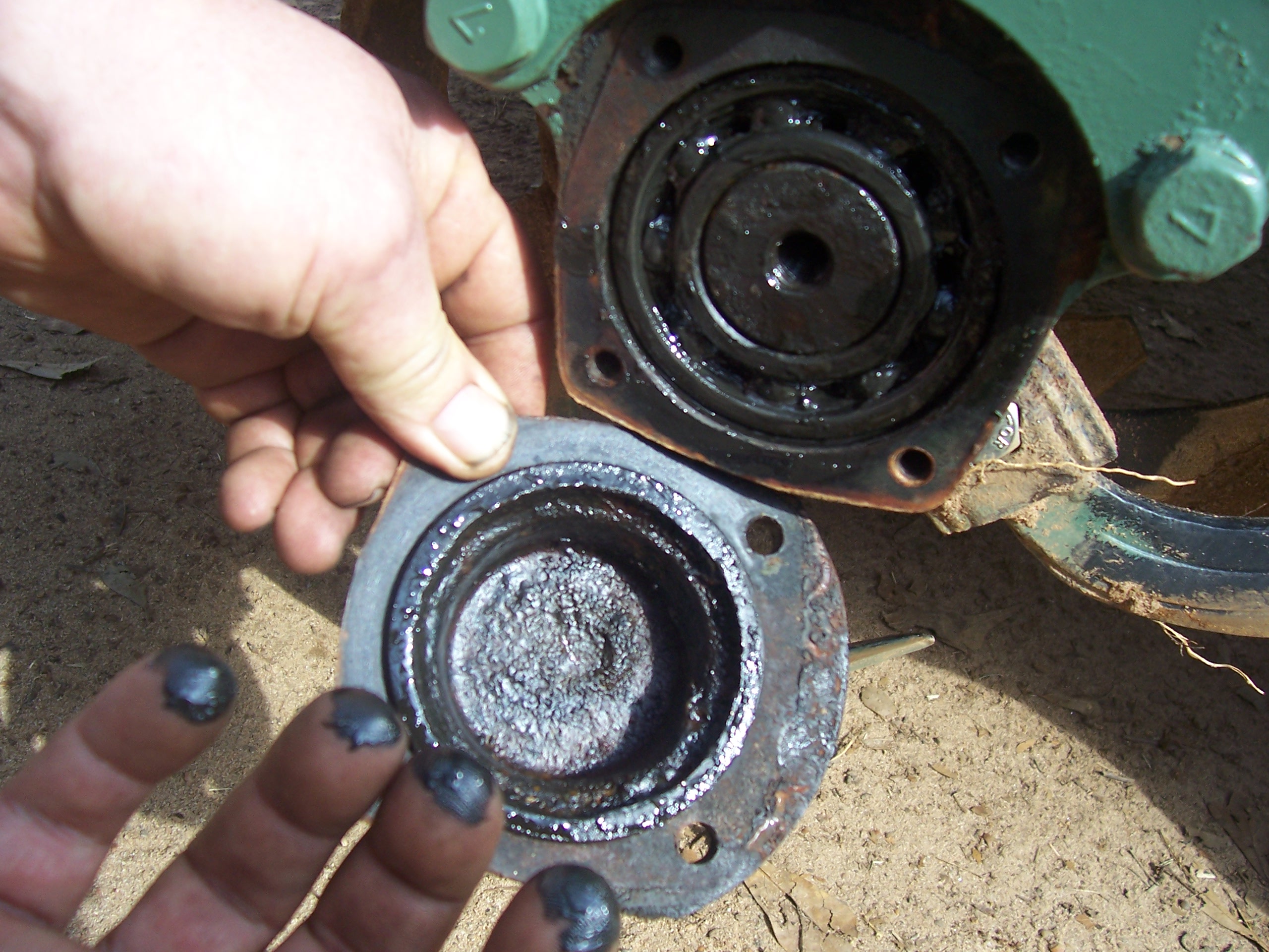

I have a shortened Dr. Shaft for it should you need one. I don't have much into it and it hasn't been used for anything for Yrs.. so I'll let it go cheap. Catch the bottom bearing that seems to be a common problem. I was lucky and opened mine up to find this............
