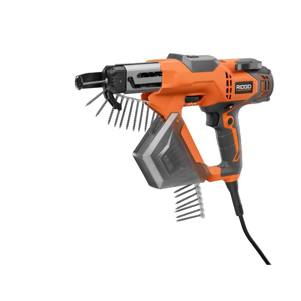

Something like the above? would solve some of the issues mentioned.
