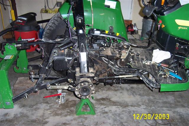

Well I decided to install the 3rd SCV myself and everything went okay. Taking the right fender off and the right rear wheel made the job easier to do. I didn't set any land speed
records doing this and spent 5 - 6 hours which included a trip to town to buy some 3/8 inch drive hex male sockets.
I couldn't budge the plug in the bottom of the SCV with
an allen wrench.

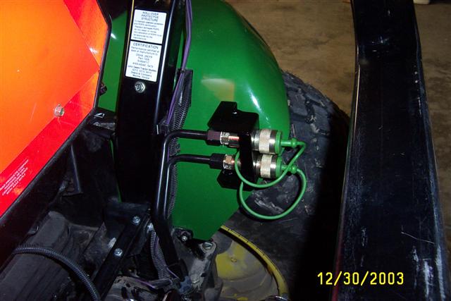

Here's another picture of the finished product.
I thought putting the rear wheel back on was going to be a pain but I used two 5 foot long oak 1 X 4 's (I have a sawmill)
one slid under the tractor on each side of the tire and lifted
the wheel and scooched it back on to the hub. A real back saver. (the wheels were not ballasted)

Nice photo, clean job. Hope you enjoy yours as much as I do mine. My hoses are extended up front for my 4 in 1. What else do you plan to do with yours?
