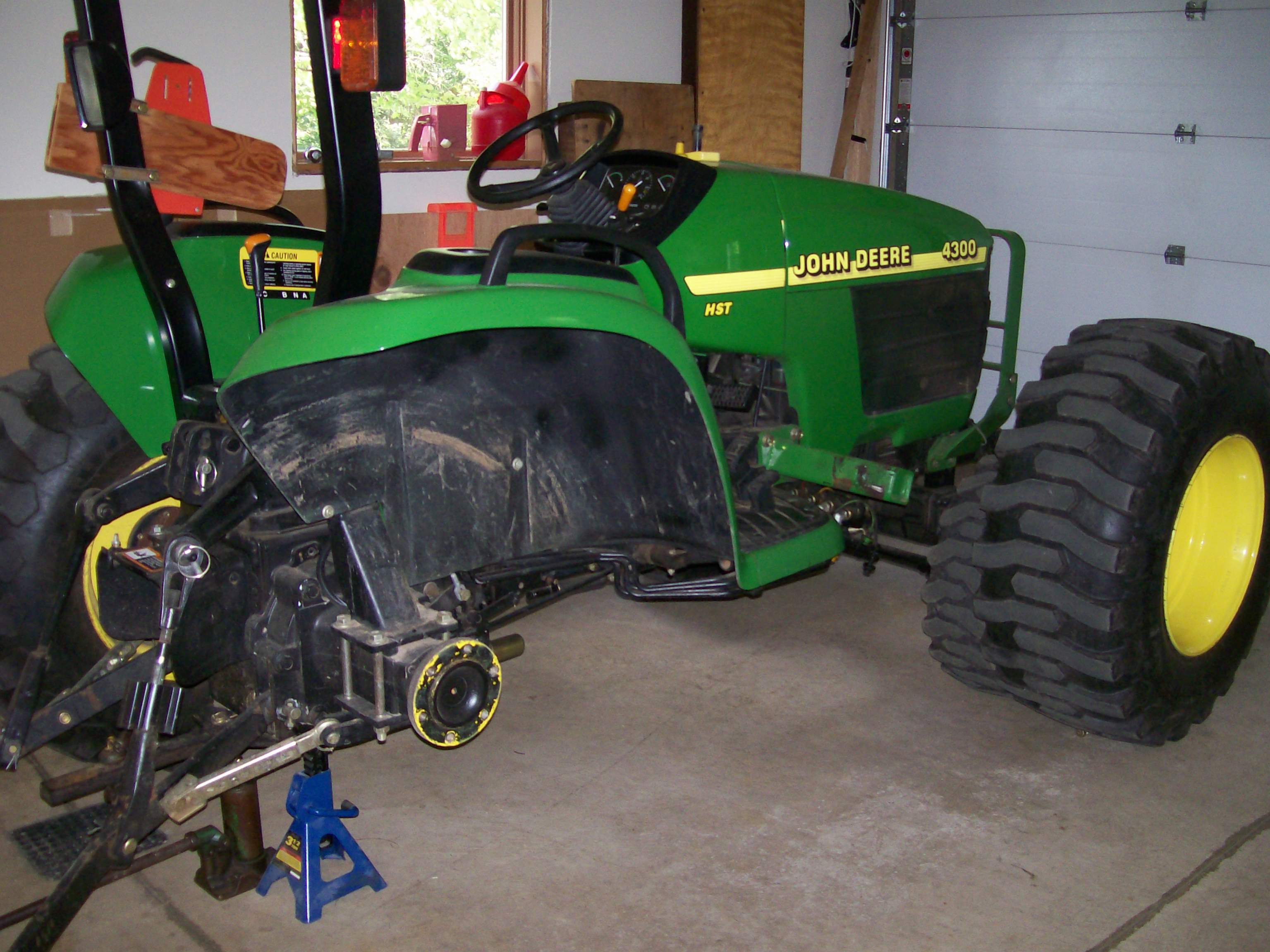

Did you complete your install? Do you think it would be possible without removing the tire? Handling a ballast filled tire is the only thing that keeps me from taking on this install myself on my 3720 with cab.
/ 3rd SCV 3320 #10
I did complete the install, yes. I can't remember all the bolts/hardware there were to get the fender assembly off, as it was a few months since I've done it, but I'm thinking that it would be extremely difficult to do w/out pulling the tire off. Again, though, that's not to say it couldn't be done, I just don't think that it would be too easy if it could done.
/ 3rd SCV 3320 #11
nhemmer
If you have R-4's, then handling the tire is no major problem... they will stand up. Just need to be careful that if they do go, there is a place for them to fall without you under it. :D
This pic when I added the 3rd SCV and the tire was loaded.

Thanks for the input. I'm more comfortable about pulling the wheel since as pointed out the R4s will stand on their own BUT I don't think I will need to. With the cab tractor there is a hole already present for the cables to enter the cab console to attach the lever and the cab has much greater clearance around the axle making access to the SCV much easier. Provided I can tighten the hydraulic lines with a crows foot from below I have no reason to remove the wheel. I will try to post pics when I do the install. My machine is a 2007 and it takes the same kit as the open station. I understand the 2011 and newer use a electrohydraulic control better suited for a grapple, etc. but overkill for my Clemens Radius under vine weeder. Simpler is better in my case. thanks again for the quick response to my questions

Well, it is done. After receiving the wrong kit (it is not the same as open station) the dealer ordered the right kit for early serial number 3rd SCV cab tractors which is nearly 1/3 the price of the newer electo-hydraulic 3rd SCV. I completed the install in 1 day WITHOUT removing the wheel. To do this I had to disconnect all lines to all three spools of the SCV but it worked. I'm not sure that is needed when the wheel is removed but I suspect it is. The new hard lines run behind the existing and fishing hard pipe through is a challenge no matter what. It was easy enough with the right tools and some patience. Altogether about 5 hrs of work to install the kit.
