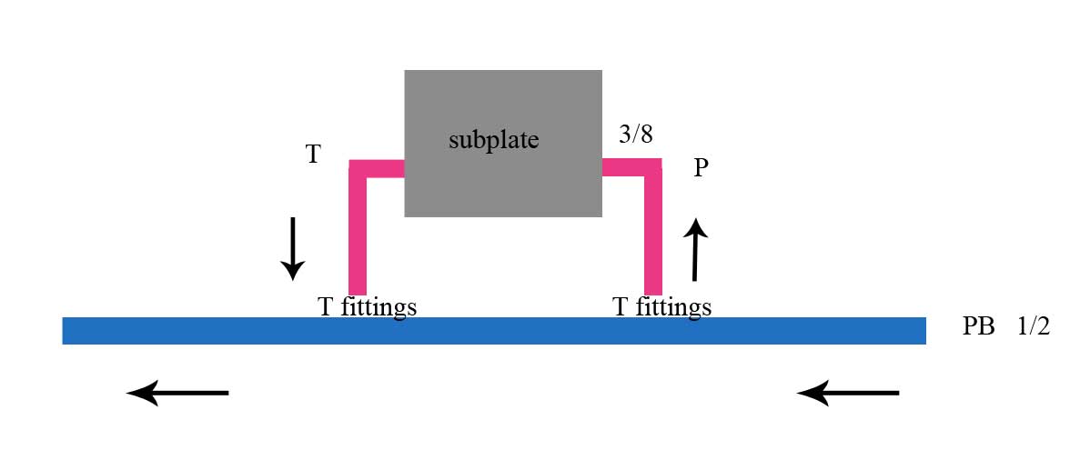

#36
Ok. I am having trouble finding a D03 subplate with 1/2 connections. Most all have the #6 3/8 connections. So here come my weird questions again.
Would going down to a 3/8 in the series with the PB limit or squelch my 3pt lift capability? I have to pull an 8' heavy duty cutter that weighs nearly 1400#.
What about doing this type of hookup? Would that have any negative consequences on the circuit?
My idea is to let the 1/2" flow through the PB uninterrupted but T in the 3/8" subplate in a side loop and then back to the 1/2". Not a lot of extra cost by it would keep the 1/2 flow being reduced to 3/8.
If I go to the D05 valves which seem to be standard with the 1/2" the flow rates go up significantly.
/ 3rd Function on Mahindra 4350 #37
#39
You are right, I don't like the price. That's why I was searching for an alternate solution. One of the first subplates you posted had the proper connections and was $88 though it says it was for parallel.
That path of least resistance... you are saying that it will not take the path to the subplate as it will just flow through the 1/2 inch lines. I figured if it was under pressure that it would fill all lines and work. I can see how I might have a back flow problem but a one way valve would solve that.
I take it that reducing my lines down to 3/8 should not affect my lift capacity only my speed of the lift. Is that right?
I am not the first guy to do this. What is everyone else using? Do they just pair down to the 3/8 and back out to the 1/2?
/ 3rd Function on Mahindra 4350 #40
What is the size of hoses used on your tractor?
What is the smallest hose in the series path from pump to tank?
