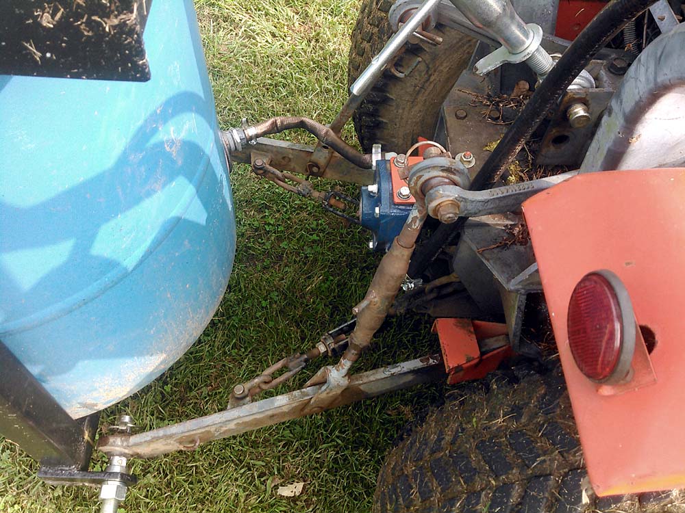

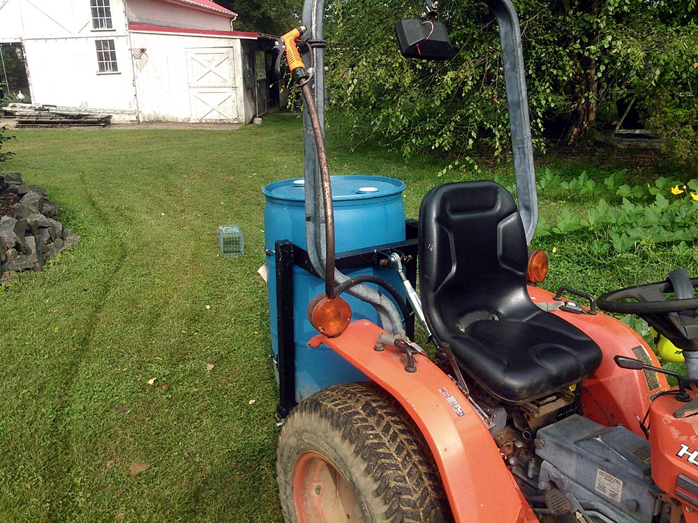

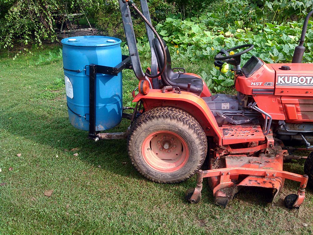

I built this to water rhododendrons my wife planted on the other end of our property, out of reach of the hose. We used to haul water there by wagon and bucket, now I can water from the tractor seat. It is just a barrel and roller pump for the PTO.

Looks useful. How is it plumbed? A roller pump, being positive displacement, needs some kind of pressure relief unless you squeeze your nozzle prior to pump engagement.

Looks great but take off those rubber tarp straps and add some web straps.

Thats what I do - hold the nozzle open while I engage the PTO, I might replace it with just a jet to make it foolproof. With just a hose it pulses :)
The barrel is pretty much balanced, rubber straps is all it needs.

Not a fan of any PTO powered stuff unless there is no other way. Maybe a 12v transfer pump?
Why? That's what the PTO is for. I prefer the pto pump over a 12v pump, it'll do more volume or more pressure, just all around more useful. I'll do a 12v pump on a pickup because that's all the power source I have.

Roller pumps are bulletproof and rebuildable - unlike cheap electrical pumps.

LOL, ok. So you think that the two rubber bungees are holding 260 pounds each? :D
The main problem isn't 520 pounds when full,it's 390 pounds sloushing around when only 75% full.:yes:
On secound thought,520 might also be a problem when tractor pop's a wheelie.:D
/ 3pt watering solution #14
The problem is barrel tipping backward on any incline plus sloshing. The bottom rubber strap holds little. Put a web strap on the top.

I have to find a hose that does not cringe and make a loop - for the water to the pump line. The garden hose is not ideal and the distance is changing with the lift. Ideas?
/ 3pt watering solution #20
Standard Ag EPDM sprayer hose should be available by the foot in most farm and garden stores. Cut it a little long so it can loop a little.
Add a bypass valve and good to go.
