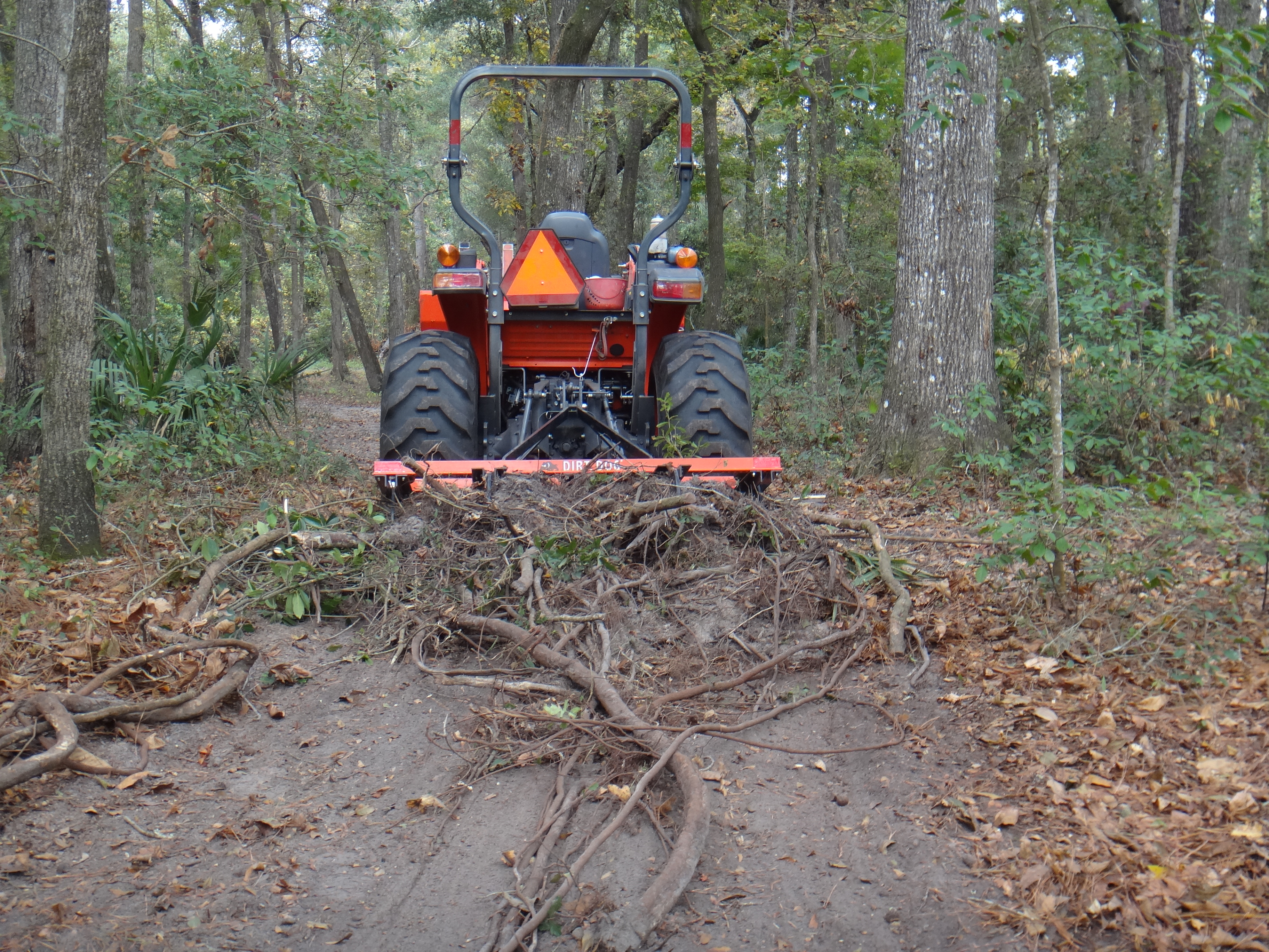

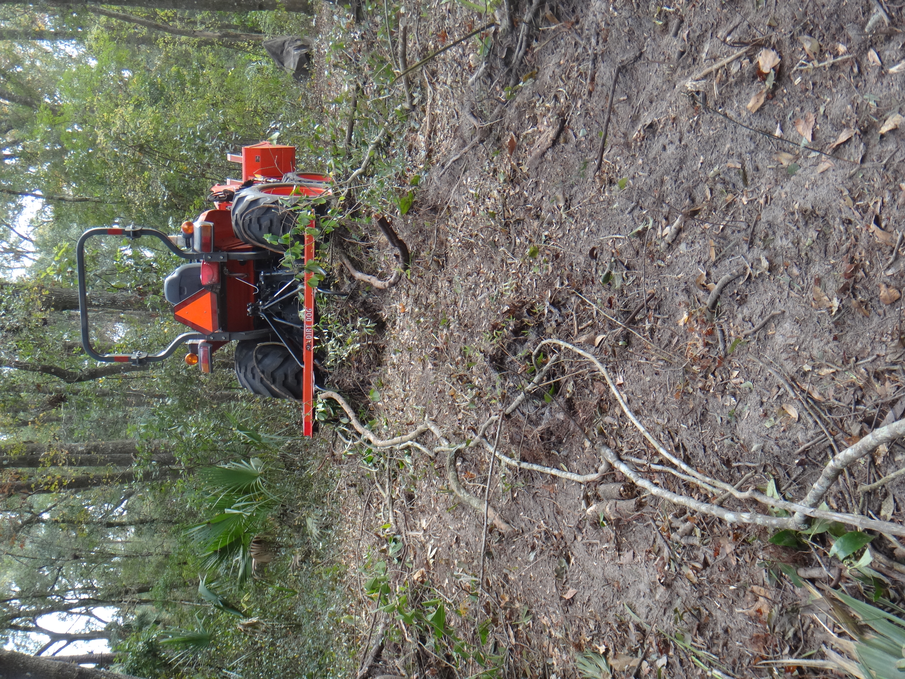

FIELD CULTIVATOR is the best implement for removing vines and corms and transporting them easily to a disposal site. If you chop vines with a roto-tiller some of the chips will propagate into new vines.

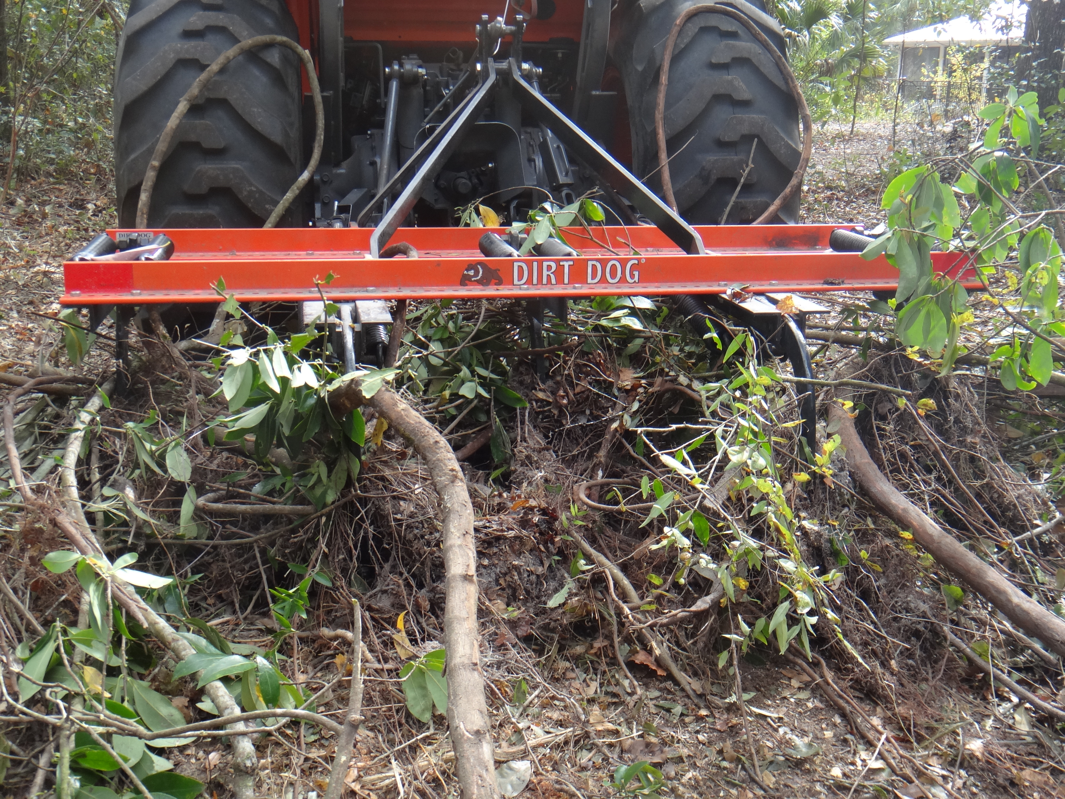

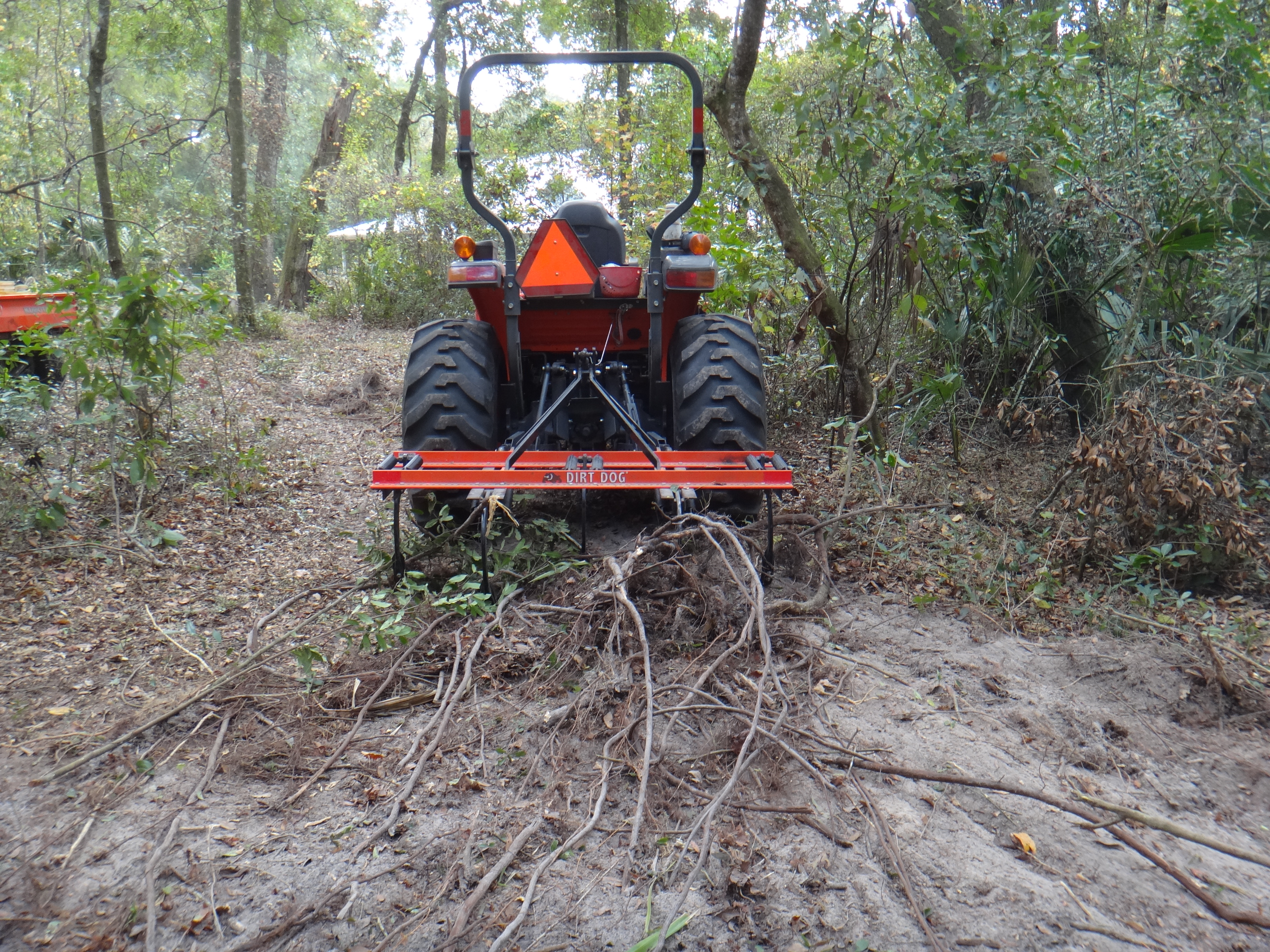

With a Mahindra Max 26 you can pull a 48" three tine or a 60" four tine Field Cultivator, which would be a five tine with one tine removed. Five tines will stall your tractor.
Here is a link to Iowa Farm Equipment, a Dirt Dog vender.
Dirt Dog 48" 3-Shank All Purpose Plow
Everytfhingattachments.com sells the Fred Cain Field Cultivator.
Fred Cain 5 Shank Field Cultivator Ripper Tillage

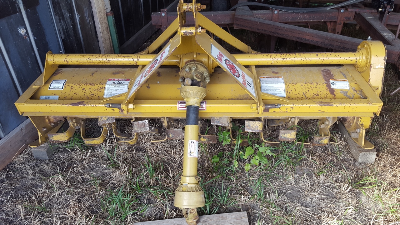

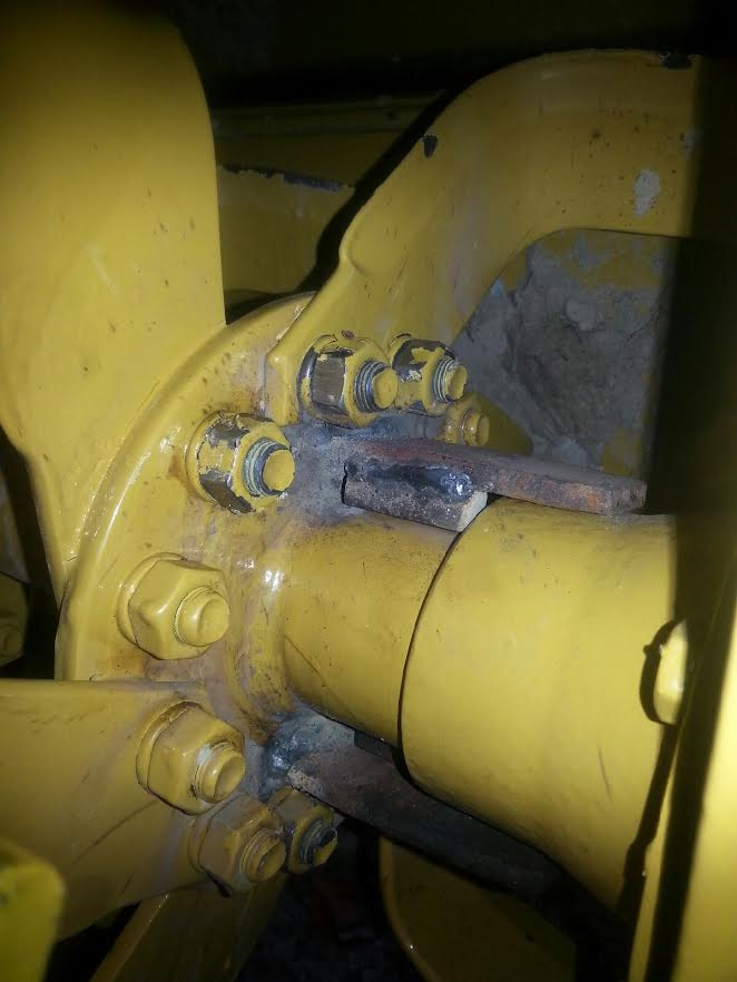

Oh, I am the one who put up the "trash guard" for tillers post and pics also. Here is the picture of a set on a 60" KK tiller I made:D I have yet to do seals in any of my tillers but have done seals and a rebuild on a pardners woods tiller due to stuffs wrapping around and ruining seals.... Woods tiller did not have said guards.
My KK tiller has guards similar to those on it. Appear to be factory. I don't have any pics of them. It's the only KK tiller I've been around and bought it used. So not sure what's offered on new KK tillers. My local Farm and Home store sells them, I'll try to remember to take a look at them when I'm in town today.
It still wraps trash but doesn't seem to get into the seals.
