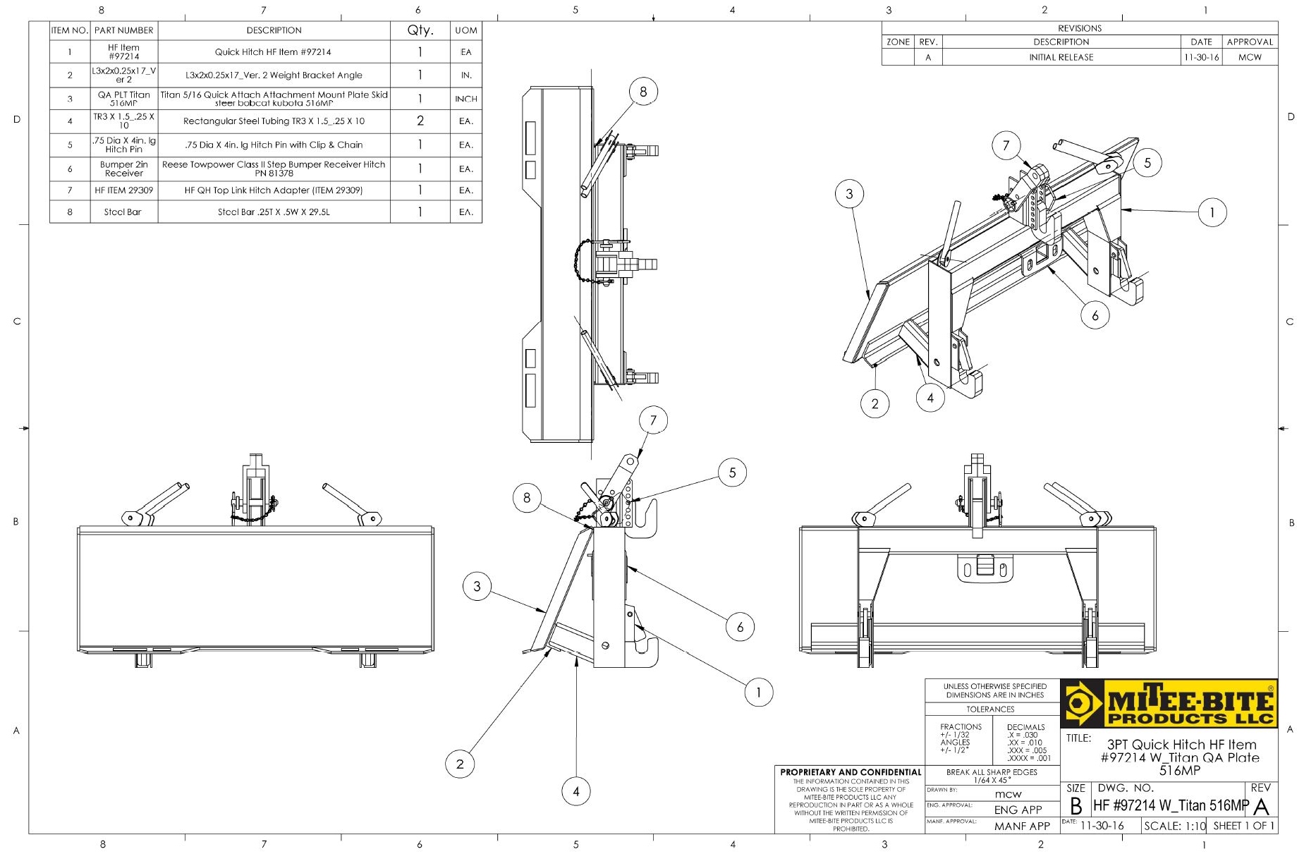

  • HF quick hitch# 97214_W_Titan QA.PDF

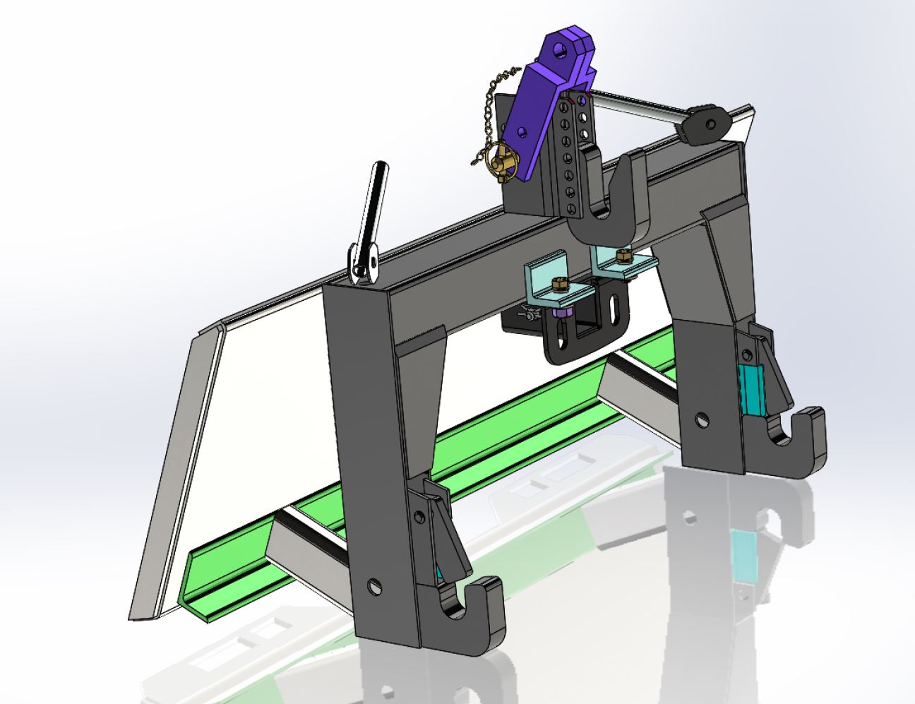

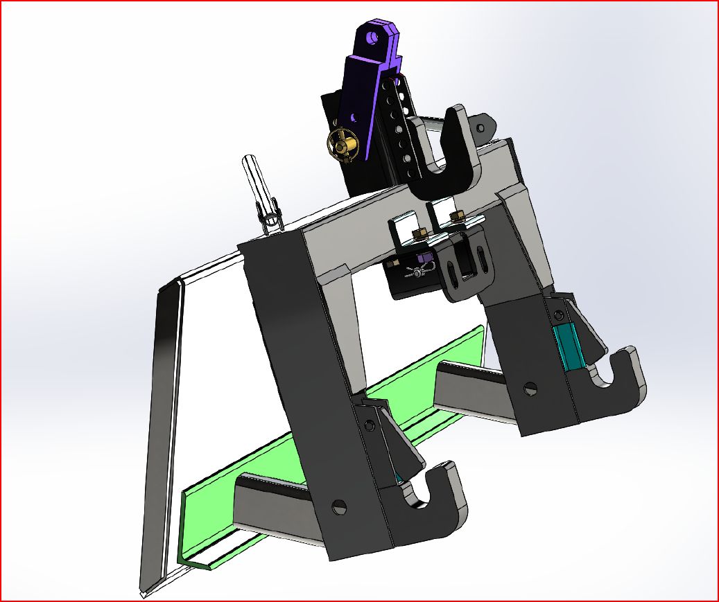

Re: 3pt QUICK HITCH WITH ANGLED QA for your Loader. PARTS LIST AND DRAWING
3pt QUICK HITCH WITH ANGLED QA for your Loader. PARTS LIST AND DRAWING.
  • HF quick hitch# 97214_W_Titan QA_2D 11-29-16.PDF
  • HF quick hitch# 97214_W_Titan QA_3D_11-29-16.PDF

My build will have the HF QH pivoting at the bottom, and use about a foot of chain at the top,,, for "float"
I already have everything,, just a little assembly is needed,,,

Below explains why I want a bit of pre-built rollback angle.
http://www.tractorbynet.com/forums/kubota-owning-operating/371960-back-dragging-fel-bucket.html
The 3PT on the FEL will be for light work, going slow, and moving 3 pt Stuff around, Cary all, man lift etc. My excavator has a dozer blade.
