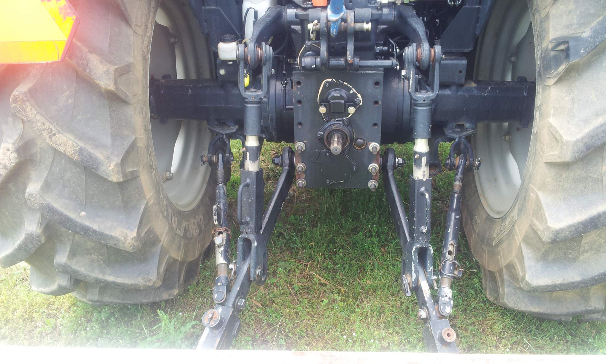

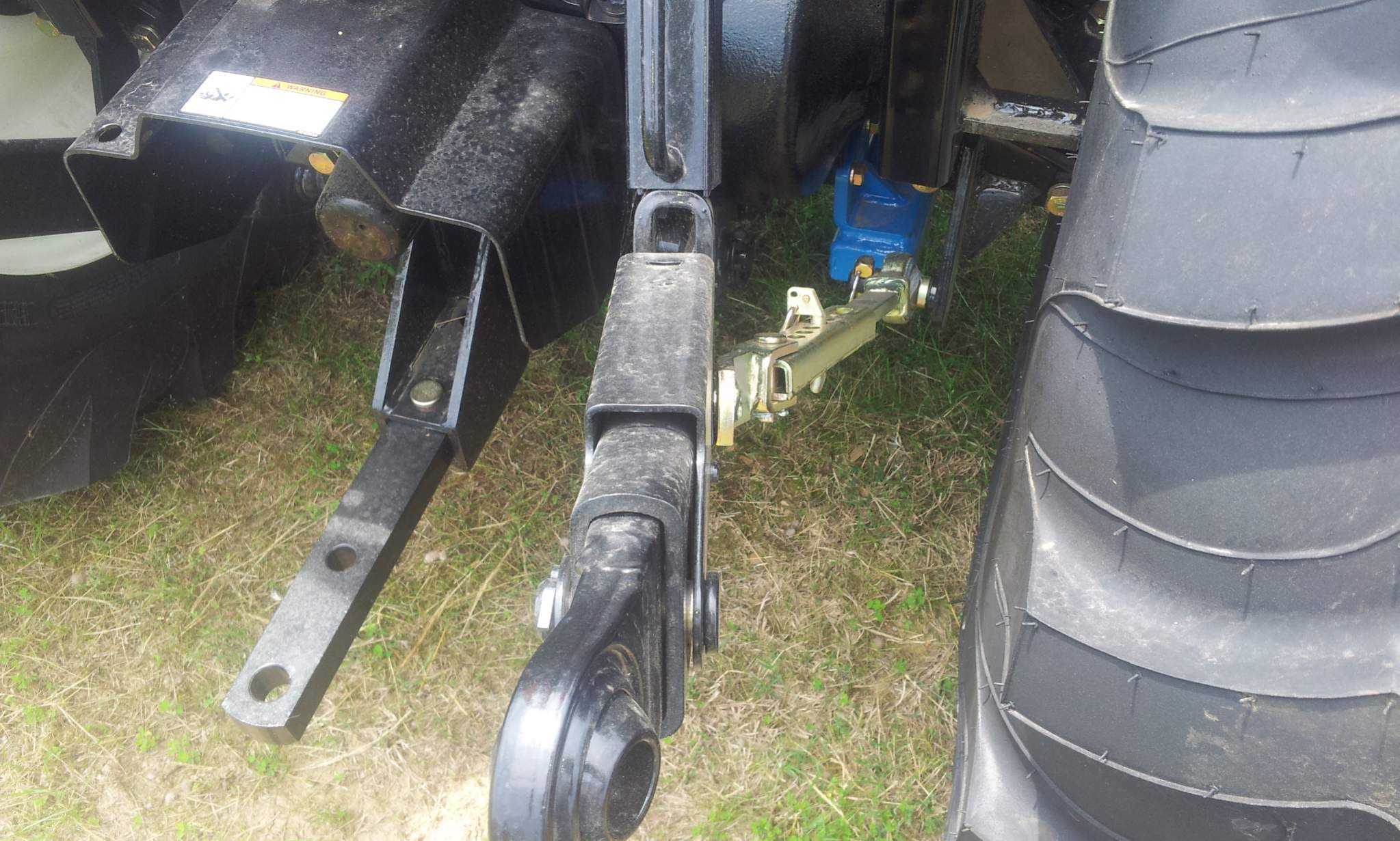

/ 3pt Stabilizers #25
I went by an LS dealer and looked over the other models very carefully. I found that my xr4046hc had the weakest setup of them all. right next to it was a 5065 and it had a strong screw type setup that could be set very rigid and still move up and down. it could be adjusted and then pinned to stay where it was set at. 20140525_121414.jpg20140525_121300.jpg
/ 3pt Stabilizers #26
Thanks for the XR picture. That confrims they did make some changes from the R to XR series. The ball joint on the tractor side being the biggest one. The male part also looks to be shaped differently. Anyone bent the XR stabilizers yet?

#27
Looks like the XR4046 is the same setup my R3039 has.
/ 3pt Stabilizers #28
If there is zero play, any decent side load will bend them. If there is too much play the implement can get a running start before everything stops, and bends.

/ 3pt Stabilizers #30
Whispering Oaks, doesn't that look like a CAT II hitch?
