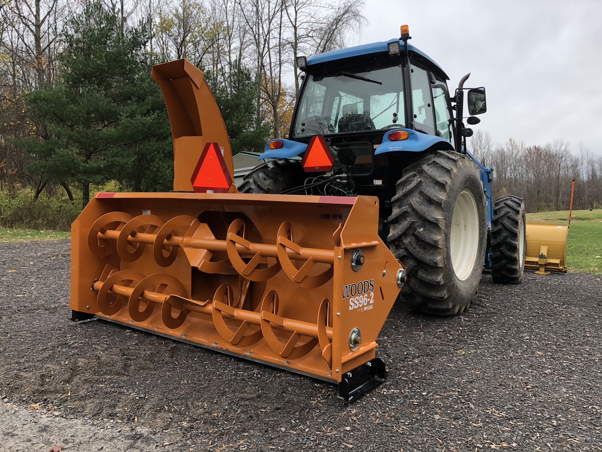

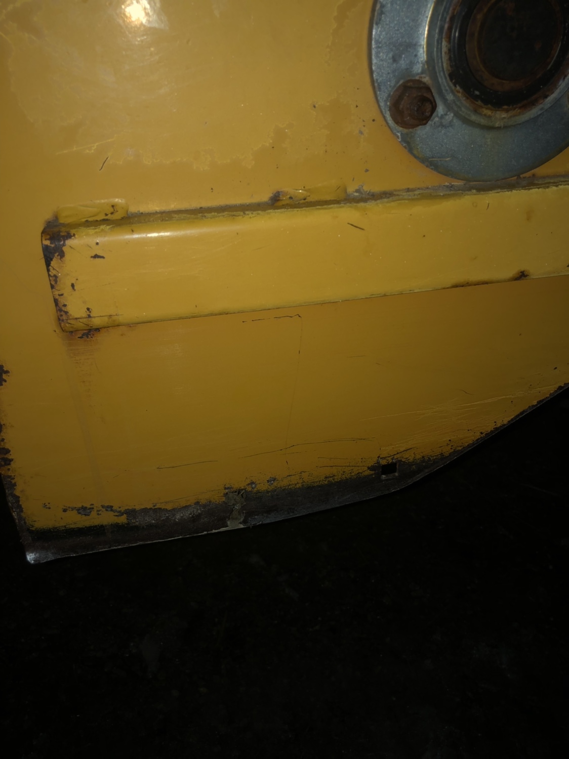

Does anyone know where I can buy skid shoes for a woods SS74 3pt snowblower that bolt onto the side? They have adjustable shoes that sit center of the blower right under the blower propeller. The issue is that the blower rocks backward towards the tractor rolling cutting edge up. When you adjust top link so the blower is top slightly away from tractor it doesn’t roll back but it will cut into driveway or lawn. Pictures show the holes for the shoes (well I believe they are for shoes).

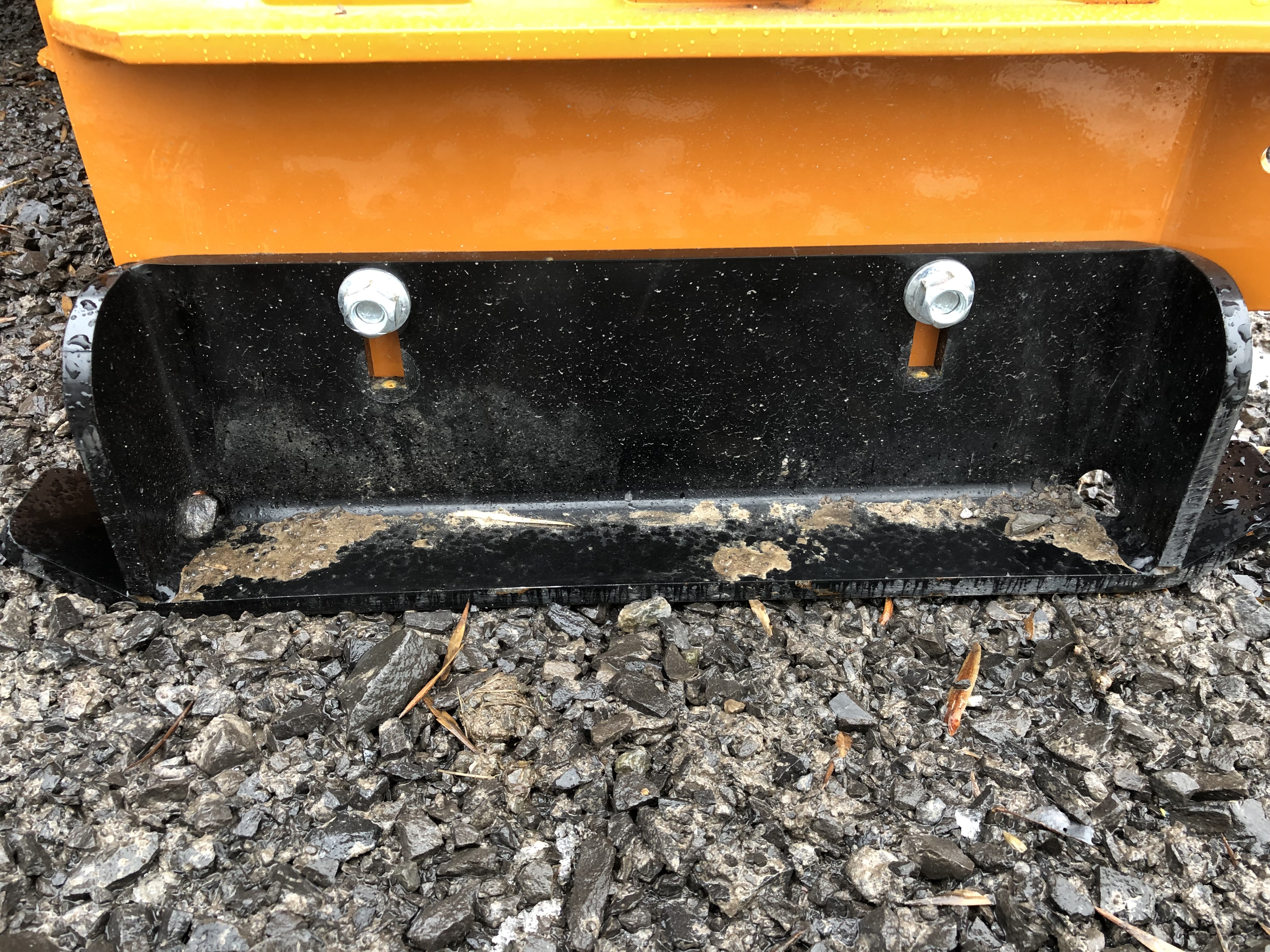

The holes are for skid shoes and I have them on mine. They were an option, purchased through my dealer.

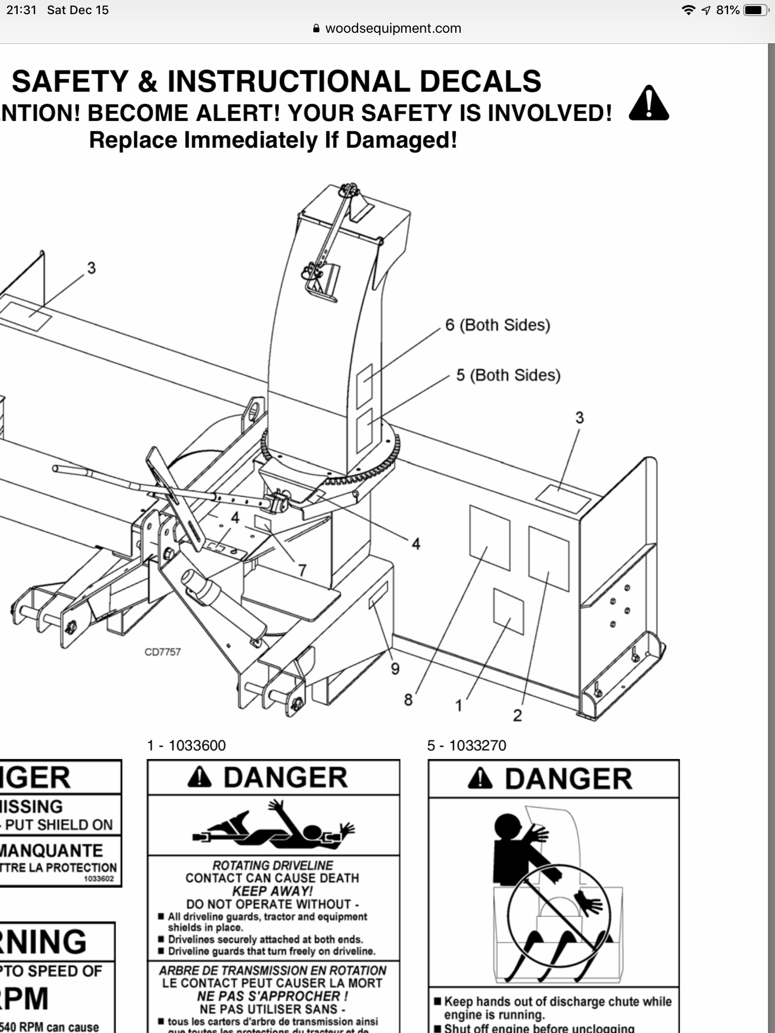

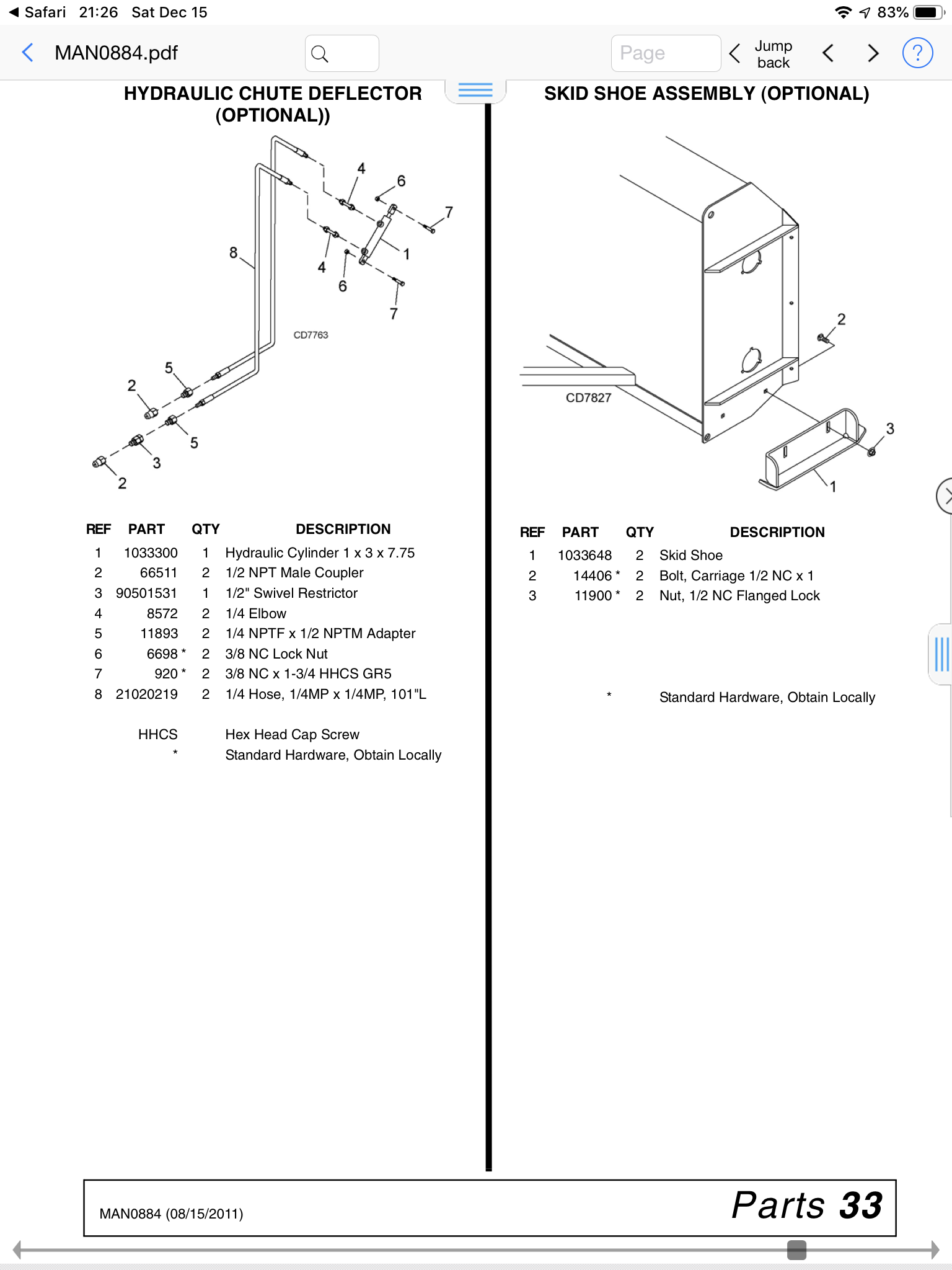

Here they are listed in my owners manual. I can measure them tomorrow and give you the hole spacing to see if they would fit.
/ 3pt Snowblower skid shoes #7
I just looked at the online owners manual for your blower and they are on there.

The holes are 3.5” center to center.

The hole spacing on mine is 8.5” center to center.
