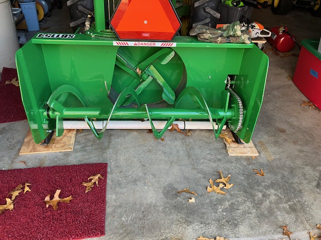

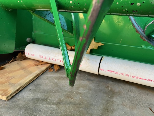

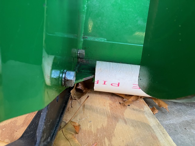

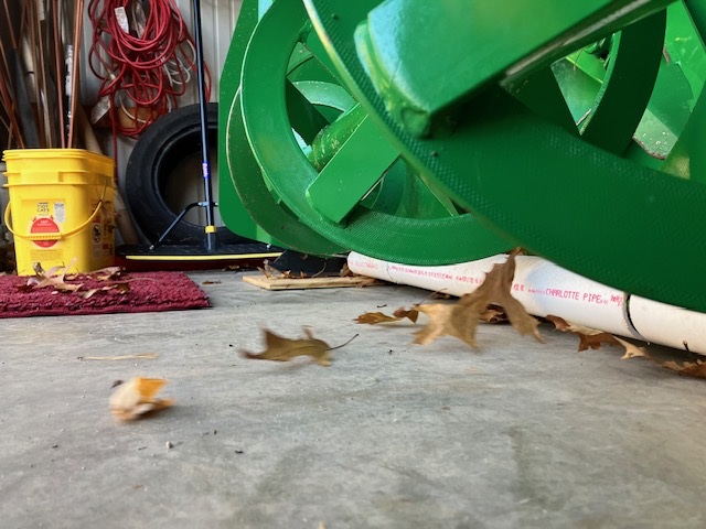

I use PVC, slit lengthwise and fitted (a PITA) on the blower edge. I'd call it an 80% solution, but it's probably better than a steel pipe because you can use a larger diameter (more gravel scooping resistant) and it's removable. Easier to get on in shorter pieces and the ends break first. I'll replace the ends after this season because they're starting to crack. They fail if I don't go slowly enough when I hit a slightly raised edge of concrete.
The pics are after 5 years. The last one shows top scoring because I invert them every year. The end on the right has lost a piece, but inverted it will last another year.
I used the largest diameter (I think that's 4" in the pics) that cleared the augurs - and I don't know if I could get a smaller diameter on.
JD 850, Frontier 54 inch blower. Quarter mile driveway, southern Michigan winters subject to lake effect.

View attachment 837772View attachment 837774View attachment 837775View attachment 837776
