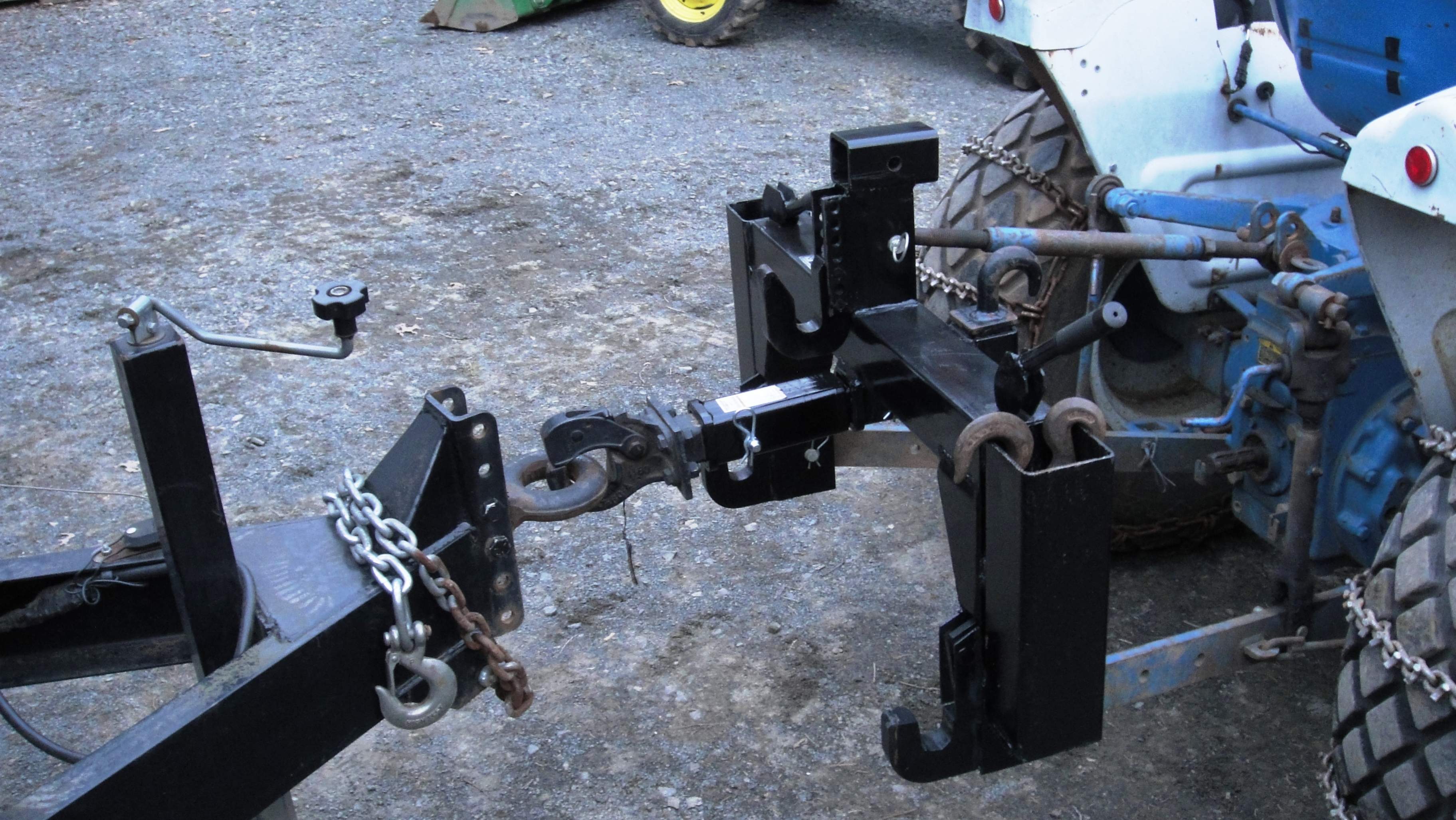

I've seen lots of great posts for customizing ballast boxes. Adding pipes for tool transport. Adding receiver hitches. I've not seen anything similar for customizing quick hitches. This is curious to me so I have to ask why? The QH is always on. The ballast box gets dropped everytime you need to mount a 3pt attachment. Seems to me it would be better to customize the quick hitch. Here are my initial ideas. Side pockets for tool transport. A receiver hitch mounted atop the top link. Perfect for a gooseneck trailer mover or add a small cargo carrier for carrying stuff above your mounted 3pt attachment, even above your ballast box. ;)
What do you think? Anyone done something similar?
Well I copied most of your ideas, even the top receiver and the side boxes :eek:
The lower center mount receiver is now not only handy, but I already consider it a necessity, as I used it twice yesterday.
I will start another thread so I don't hijack yours anymore, but will give you credit for the idea.
Also for the boxes on the side I used 4x4 cause that's what I had, but that size is limited to just 9-10 ft of 3/8 chain. I wanted to use 4x6 but could not find it. I just tacked these on so when I find some light 4x6 I'll put that on.
With 4x6 you could put a sledge hammer or an axe and much more chain etc.
JB.
JB.
