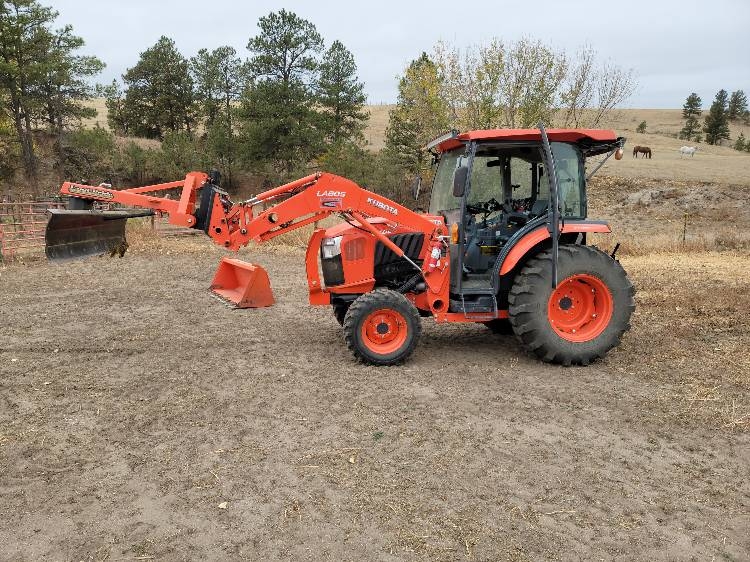

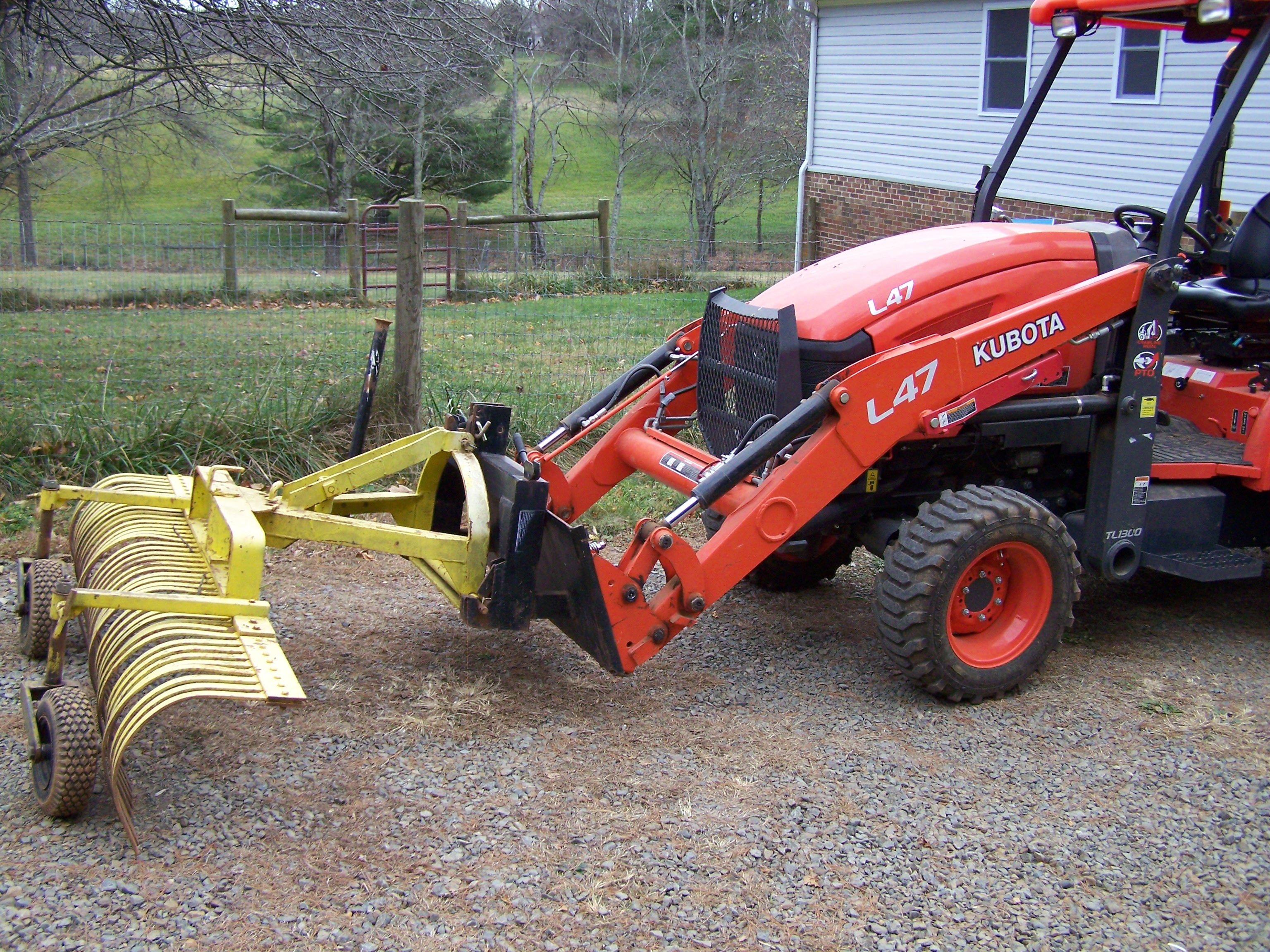

I use mine for cleaning out ditches w/york rake. Works ok with a box blade (small jobs) so I don't have to take off the backhoe and install the 3pt hitch. Same thing with my Woven Wire fence unroller, or to my carryall for a work platform.

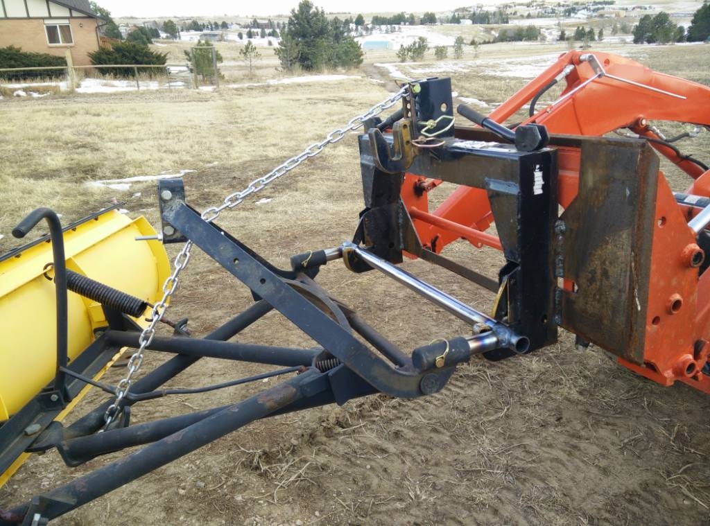

I've made 2 welding a Quick Hitch to a SSQA plate. First one was the mount for a snow plow. It sold with the plow & old tractor. I used it once to wrangle my flail mower to do some maintenance on the bottom.
I made another after selling the first to move implements around. Used it to mount a back blade to at one point. So I could reach into some stalls to muck out manure as I couldn't drive under the roof or reach the back. Haven't used it as much as I'd thought. To hard to line up the books in 3 planes while everything is obscured by the hood.

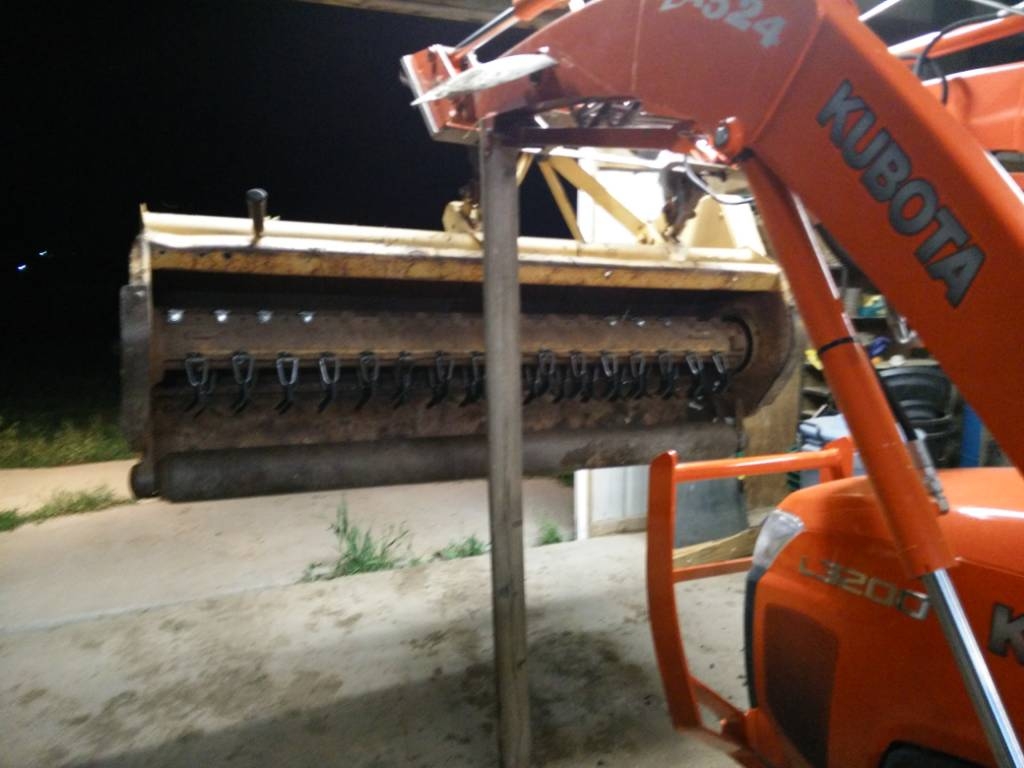

I use my ssqa to 3pt adapter to use the carry-all as a work platform to cut branches. It works great to hold a rotary cutter up so you can replace the blades easily. Sometimes it is nice to use the rear blade off the front too. For winter, the snowsport snow plow attaches to the 2" receiver hitch.
