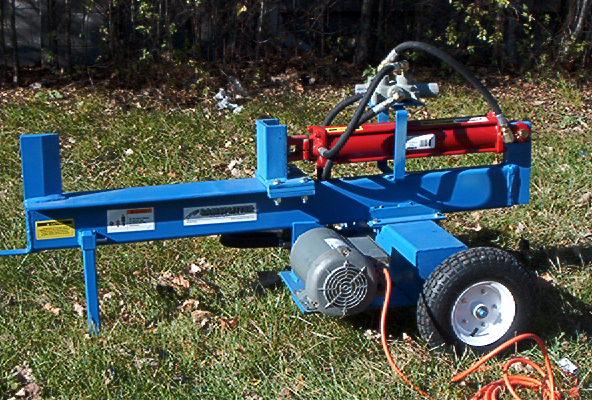

If I only split two cords a year, wanted reliable, and did not care too much about speed, I would look at an electric unit. Some nice units for under $1000.
This is the one I was going to purchase before deciding it made more sense for me to rent a processor:

I don't know your set up or how large your rounds. There are electric splitters that go to 10 tons. Should just about split any 12" round in two.
