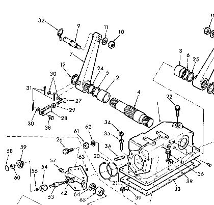

I 2nd what Leejohn stated that feedback linkage(parts keys #27,28 & 29) needs adjustment. On tractors I've been around if feed back is "adjusted correctly" 3 pt won't raise far enough to cause valve to go into relief.

OK Tx Jim I didn't understand what L.J. was saying. Not familiar with all these little parts nor their adjustments. I will look at it tomorrow but I doubt I will kno if it is correct or not. I don't think linkage can go any higher or it would hit the bottom of the seat, it is very close now as I recall. Partly because I redesigned the location to be as far back as possible to get my knees out from under my chin. (and I am not that tall only 5ft 9in 180.) So you & L.J. are saying I don't want the relief to activate. The system should operate at 2,133? & it is raising too high now??

I'm not familiar with the feedback rod on your Ford but I am familiar with the feedback rod on my Kubota M7040. The FB rod on my Kubota required adjustment so as 3 pt hitch would raise to it's upper limit. One just sets turnbuckle on FB rod where relief valve is seated(not by-passing) when 3 pt is at upper limit and 3 pt control lever is at rear of the slot.

So the feed back is connected to a relief valve??? Hmmm it appears there is also one in the diverter/manafold block where the FEL would be hooked in if there was one. Is it likely there are 2?? I can't see one in the blown up view you posted.. Or what the FB rod is attached to either. I am not at all used to looking at these sort of views..
How does one know if the links are raising to their max? I think they are, they go up and stop with a definate "thump" before the raise/lower lever reaches its furthermost position possible in the bracket. At that time the engine starts to lug so I moved the upper limit stop to that point. Then it doesn't lug any more..
I found the feed back rod but I still don't understand its function or what to expect if I lengthen/shorten it etc.

On my kubota I moved 3 pt control lever rearward then with no implement on 3 pt lifted up on one 3 pt draft arm. It still had some rockshaft rotation so I adjusted feedback rod to just where I could hear relief valve then back feedback turnbuckle off 1/4 turn. 3pt raised to it's limit with no relief valve noise. Yes it would have been more scientific to install a hyd gauge on rockshaft control valve but my tractor has a cab in the way
