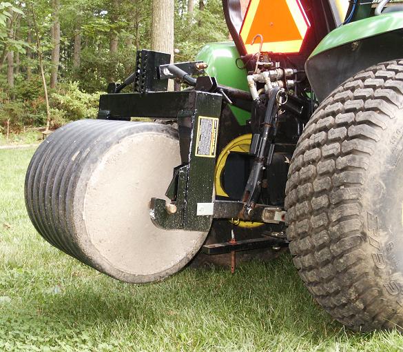

Mine weighs about 530lbs. I also have wheel weights that are about 320lbs.

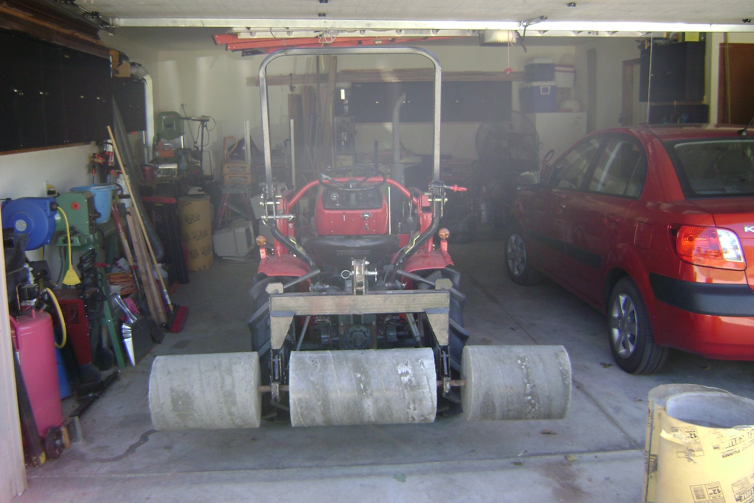

I posted this photo before in a different thread about counterweights.
It contains 7-80lb bags of concrete: 2 bags on each end and 3 in the middle formed around a steel bar. Total weight is about 570
