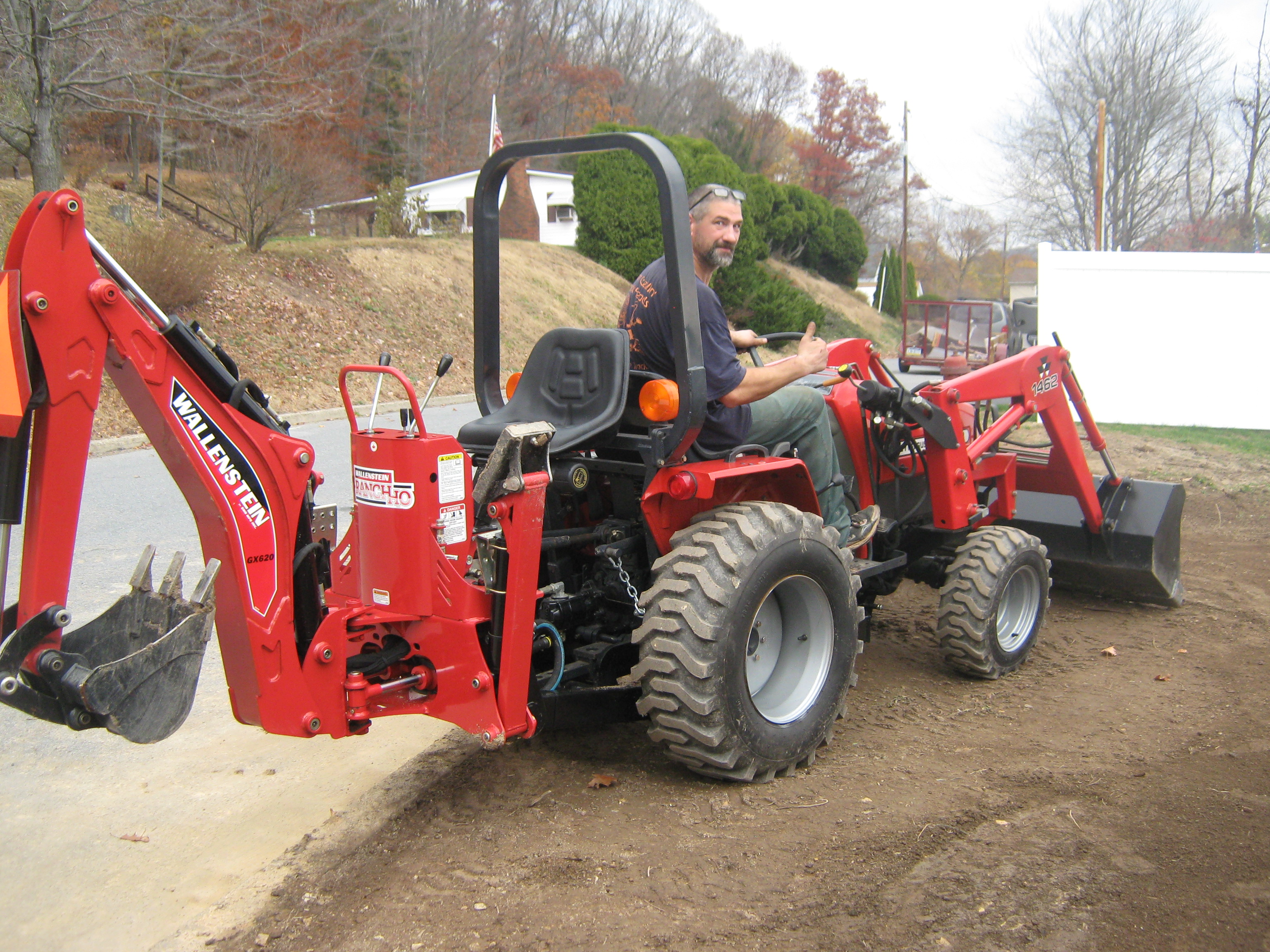

IMG_1366.JPG Here a picture of my 620.
   / 3pt Backhoe on a GC series? #25
View attachment 508729 Here a picture of my 620.
Your tractor is a bit bigger than a a gc2300 isn't? I looked on the website, it mentions that the ge605 and gx620 is compatitable with a 1423. It only lists ge605 for the gc2300. Not saying it wouldn't work, but I'd definitely make sure the subframe worked with either one.
Are you running it straight on the 3 point?
   / 3pt Backhoe on a GC series? #26
No I have a subframe, also I think if I would have a ge605, that bolts would line up the same on the gx620. There is my subframe.IMG_0996.JPG
