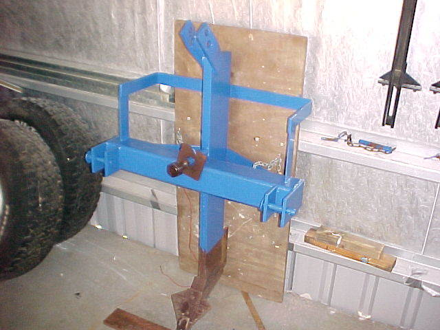

Well fellas, look what I found in Saturday's paper !!
Seems to work fine, even on our hard ground.
$150 Aust = half price + it came with that steel flywheel for extra weight. Problem is it took 4 blokes to lift it into the ute so I am not sure what to do with it yet. Without the weight I can keep the ripper inside the shed.
With the weight on I'd have to leave it standing in the last ripped trench !
PS - Also came with the pipe laying attachment.

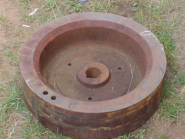

Here's the flywheel. All 100kg of it I'd say !

Well after a lot of grunting and lifting, I managed to get that weight on the ripper (along with a lot of help from my 3PL lift).
And then even managed to stand the thing up to attach it. But..... the weight is in the road of my top link.
So I have managed to bolt on a timber step to the ripper and a handy friend can jump on and act as the weight.
Pretty safe as I rip in low gear and if he fell off he would be behind the danger area.
