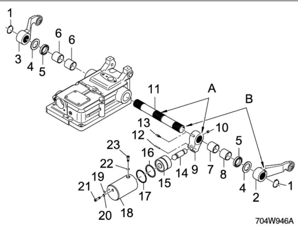

It sure sounds like the linkage is broken on the inside.

Keep us posted on what you find. It does sound like all things hydraulic are fine. But some linkage or something inside sounds broke.
A note thoguh: The 3PH will move up freely with little resistance. And will move back down with no resistance (at least up until the point that the lever is set at and from there on, hydraulics are holding)

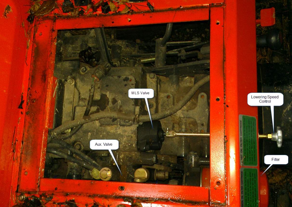

The dealer said to start with the Control Valve first, so that's were I started.
First step was to remove the seat, seven (7) 12mm bolts. With the seat out there was plenty of room to access the MLS valve, aux valves and linkages.

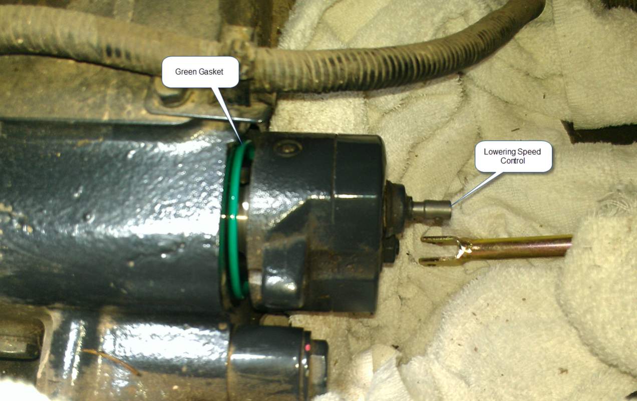

The next step was to disconnect the speed control arm and then remove the two (2) 12mm bolts that hold the MLS valve. It took some gently prying to break the MLS valve free. In the photo you can see the first of three (3) green seals in the MLS valve. Be careful not to damage those. The manual recommends replacing them each time you pull the valve. Obviously that wasn't going to happen since I don't have any spares yet.

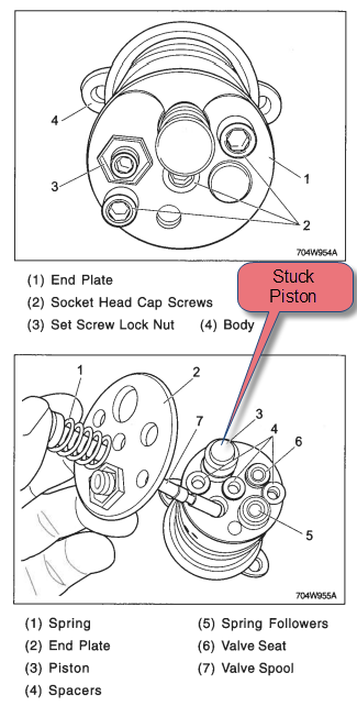

With the valve out I took it to the bench and examined it. The valve spool on the back of the valve moved freely, full travel. In one of the ports you could see the valve moving and the profile of it. The Piston valve seemed to be pretty stiff and didn't seem to be doing a full travel. The end of the piston sits flush with the End Plate so its kind of difficult to push with your finger. I used a short socket extension and was able to put some pressure on the piston and move it. It made a pop sound and then moved freely over its full travel. I believe this was the issue, the Piston was stuck. Now it was moving freely. So instead of tearing it down farther I decide to put it back in the tractor and test it.
Two bolts later, torqued to factory specs, the tractor was running and the 3PH arms were moving up and down. So it seems the MLS valve was indeed to culprit. I believe it was actually stuck in neutral.

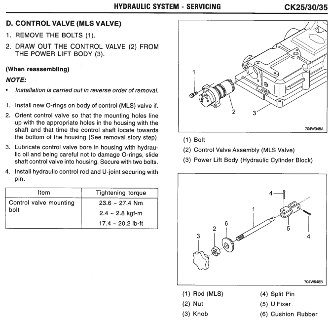

If anyone needs to repalce their MLS valve it is really simple. I didn't have to make any adjustments to it so this job took all of 40 minutes with the majority of the time taking the seat off and on.
I used the service manual I found on this site after doing a search. If you don't have the manual for your tractor I highly recommend getting one.
